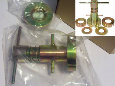

      I never seen a tool to wind the rewind springs.
      What is the plan "after" you wind the spring on
      the gizmo? Bind it with tie wraps or the likes,
      then remove it, to drop in the housing?
      https://www.ebay.com/itm/Evinrude-Johns … SwphNa3hJl
      #76015
        Grab it with a vise-grip pliers and drop it into the housing.
        Never had one, never used one, never wanted one. I simply wind the spring into the housing like coiling up a garden hose. Easy

          #76127
            I have a small commercial winder here for chain saws and the like but it’s too small for our classic motors. I also have a crop from a cylinder sleeve which is the correct size and the plan is to reverse engineer the commercial one some day so I can make one for the OMC’s. To be honest, the ‘to do’ list is getting longer and my spare time is getting shorter.

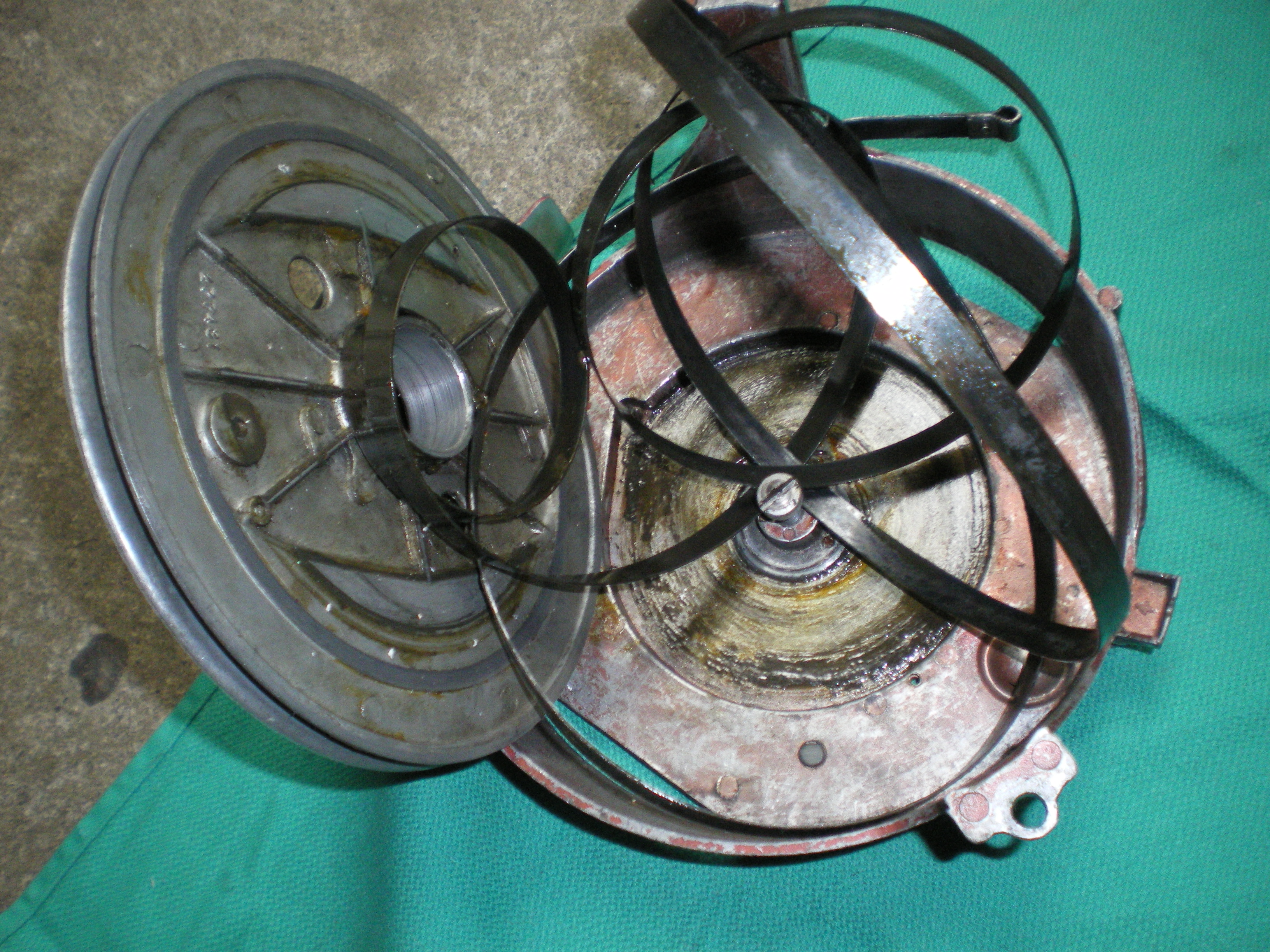

                quote Buccaneer:
                Scary when the blow out at you like a ball of spaghetti. ๐Ÿ˜ฎ
                Like this?
                #76135
                  I saved the photos from EBay as I thought that would
                  make a fun little project on the lathe, etc.
                  My project list is also getting too long. Went from
                  snow on the ground two weeks ago to 88 degrees
