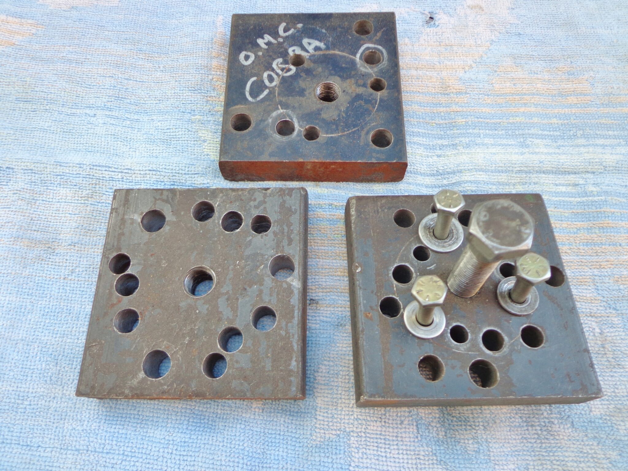

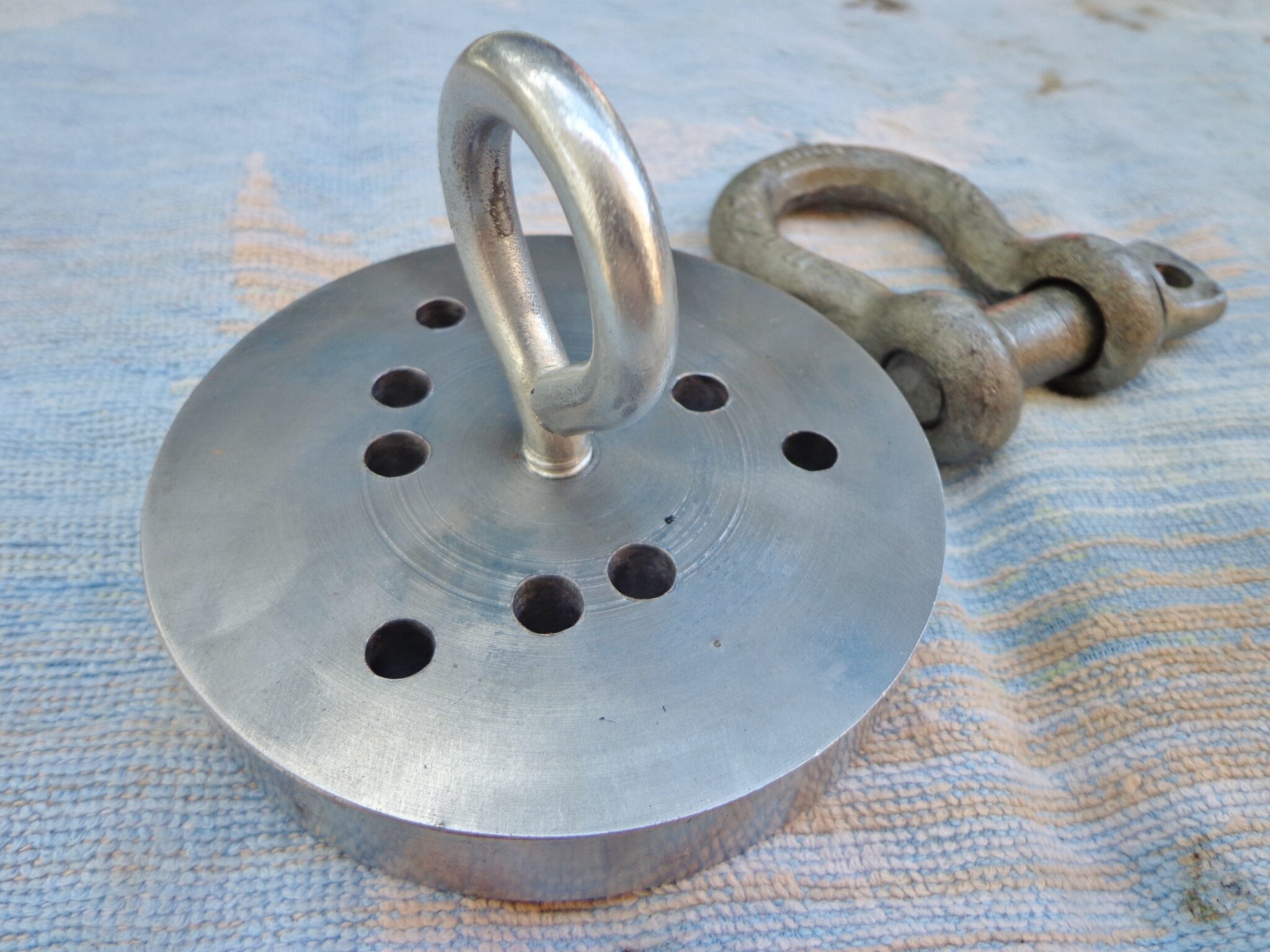

September 4, 2021 at 2:07 pm #246126If you have some scrap steel laying around, you can make your own puller for the price of the grade eight bolts.
The round one here also doubles as a lifting device fort those heavy motors.
