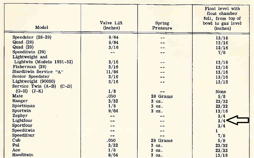

      Hi, does anybody know what is the proper float height and how to set it on an evinrude light four?
      #225148
        I found this in the ’54 shop manual. Doesn’t the float needle have little brass clips which slide down the needle to hold the float in place?
        Lightfour-Float-Height
        Also, here’s a manual for these carbs so you can take them apart without breaking anything. The Zephyr carb is basically the same as the Lightfour carb except for the bolt pattern.
        ZephyrCarburetorMaintainance
