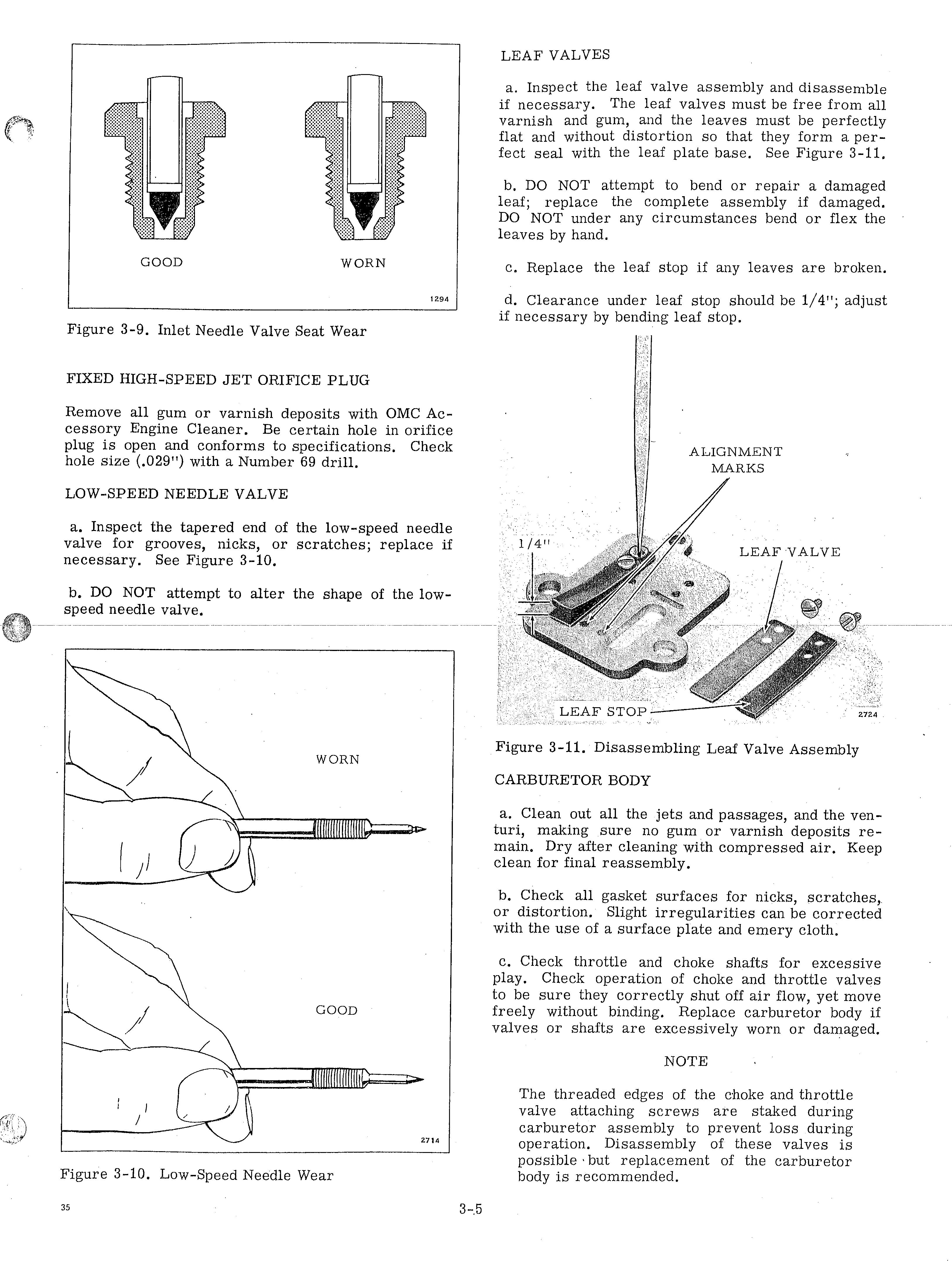

          I have taken the reed block apart an discovered that the gaskets between it and the block are broken, causing an air leak and one of te reeds was only opening very slightly, which was for the bottom cylinder.
          I have cleaned and replaced gaskets an now it is back on the motor, and I can now hear the squeaking of the reeds opening as closing as I turn the flywheel.

              CajunCook1, those compression numbers were after the first unsuccessful try run, with the recoil starter. Dry compression test came in at exactly 90psi on both cylinders, so that isn’t an issue. New base gasket has been installed so exhaust and oil isn’t spraying out from between the powerhead and leg. I am waiting a bit so the thread locker I put on the reed valve screws can cure so they still don’t vibrate loose, is there a specific setting for the reeds (as in how far they open or something along those lines) I nee to know about? Because right now they are back together the same way I took them apart(except a lot cleaner) 😎
              Anything else important I should know or check before the test run tomorrow?

                  If you had a leaking leaf valve plate gasket(s), that could easily cause a lean running condition. If you have the whole motor apart you can always put a drill on the flywheel nut with a socket and turn the motor over using the drill gun. Turn it over CLOCKWISE, continuously, and you can watch the ignition system working real time, and if the carb is off, you can watch to see if the leaf valves are fluttering (it will be very obviously).
                  If you don’t see them fluttering fairly evenly, that provides more detective work/clue toward the root of the issue. Once you’ve ruled out ignition and manifold, that only leaves 1 more thing, assuming the exhaust side it OK.

                    Hmmm, CajunCook1 I can’t open the file you attached as I don’t have the required permissions to open it.
                    Would you be able to send to my email?
                    Thanks again
                    BP
                    #24947
                    cajuncook1
                      AusOB_Collector, I sent these to your email address. I removed your email address from your post so spamers could not send junk to it. I can replace if you want. The diagram I originally posted for you is located in the service manual on page 35.
