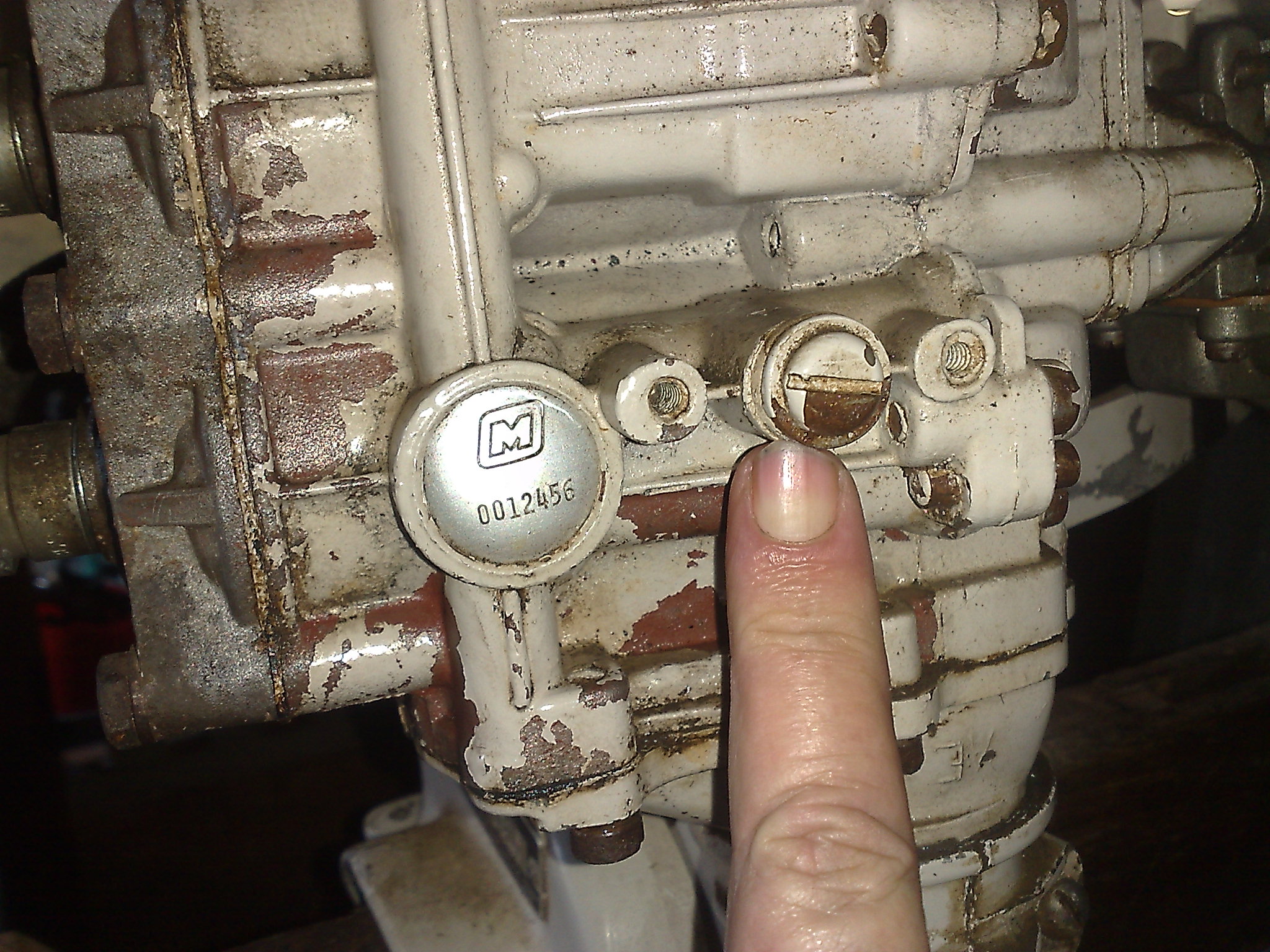

              After you removed the fuel pump, did you replace the screw and washer that goes to the fuel pump pulse port. See the picture that was previously displayed ealier in the post. If it is not sealed properly, fuel delivery can be an issue because air can be sucked in the crankcase through that port. This will also cause fuel delivery issues through the reeds into the crankcase.
              #25336
              ausob-collector
                Yes I did replace that screw and washer.
                A flathead screw and rubber washer if I remember correctly, will check when I get back home.

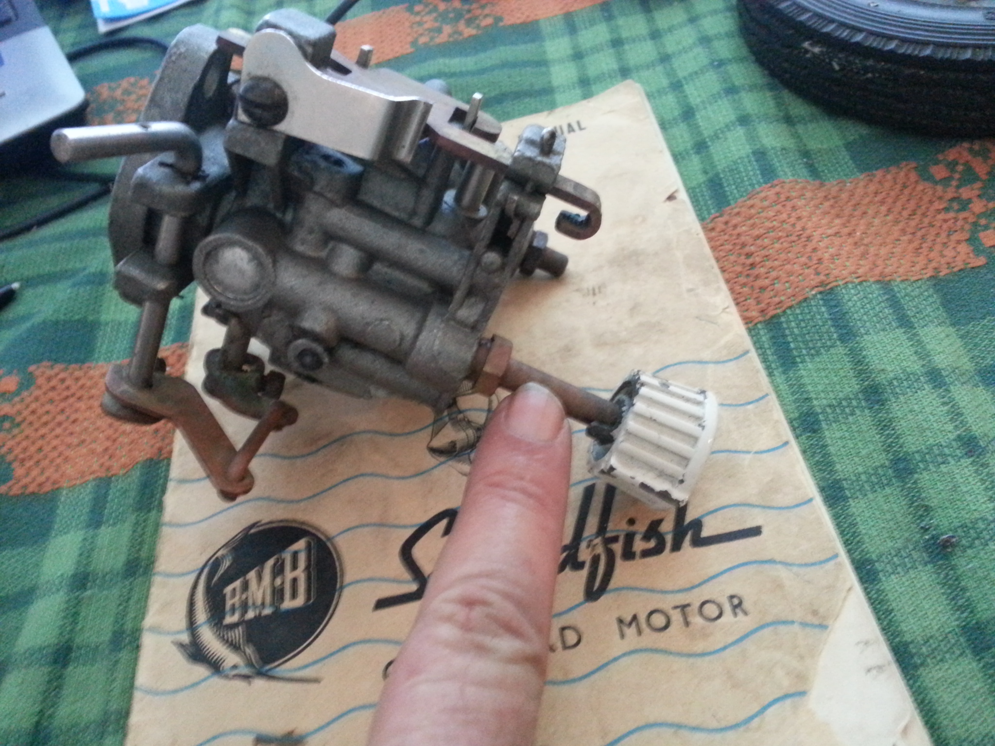

                  Just remembered Boyd.
                  When I last saw the motor there was a lot of play/wiggle/wobble with the slow speed needle assembly.
                  I suggested to use BOTH of the packing washers out of your carb kit then.
                  Has this been done?
                  Absolute nil movement on this needle in packing is acceptable. It will stuff up the idle and other things if leaking air.
                  No wobble and firm in and out required.
                  That is why I wanted to use my carb.

                  ausob-collector
                    B
                    Both packing washers have been installed an there is now no play in the slow speed needle at all.
