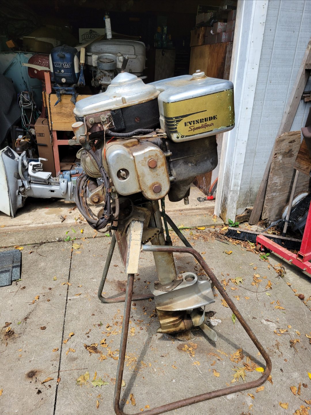

    trex014
      Yes, that is a 1941 Evinrude speedifour with factory electric start and long shaft options.
      It’s in great shape minus the missing driveshaft and exhaust tube. Does anyone know what the length of a longshaft speedifour driveshaft is?
      I have enough short shaft parts to make a longshaft driveshaft but would rather find an original.
      Screenshot_20231106_201548_Gallery
      #282346
        Long shaft parts, including the driveshaft, are generally 5″ longer than short shaft parts.
