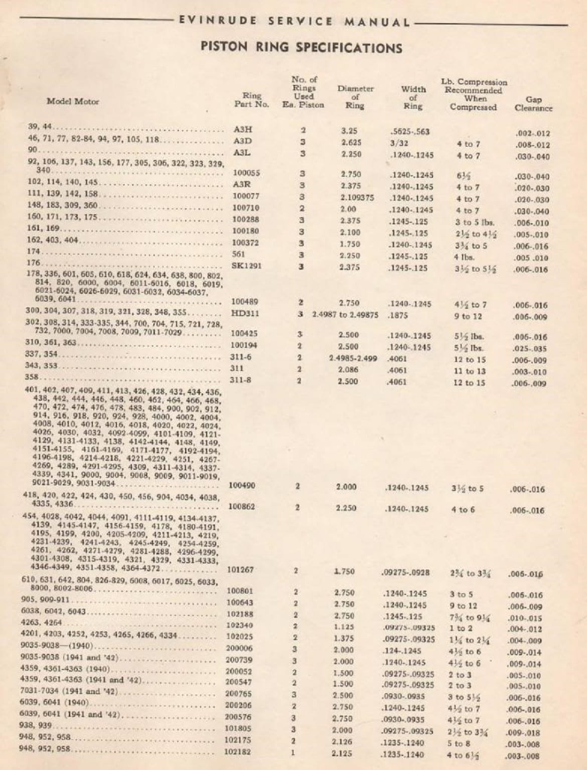

      According to an Evinrude Piston Ring chart, the model 938 and 939
      has the same dimension rings as another project I’m working on,
      with a 2″ bore and 3/32″ width rings. The part number listed is 101805.
      Of course I can’t find such a model Evinrude listed anywhere,
      nor any “hits” on that part number.
      Guessing those rings are more obscure than the 56 Scott Atwater
      I’m working on.
      Any clues on what model Evinrude or any updated part numbers?
      Thanks.
      Evinrude-Piston-Ring-Chart
