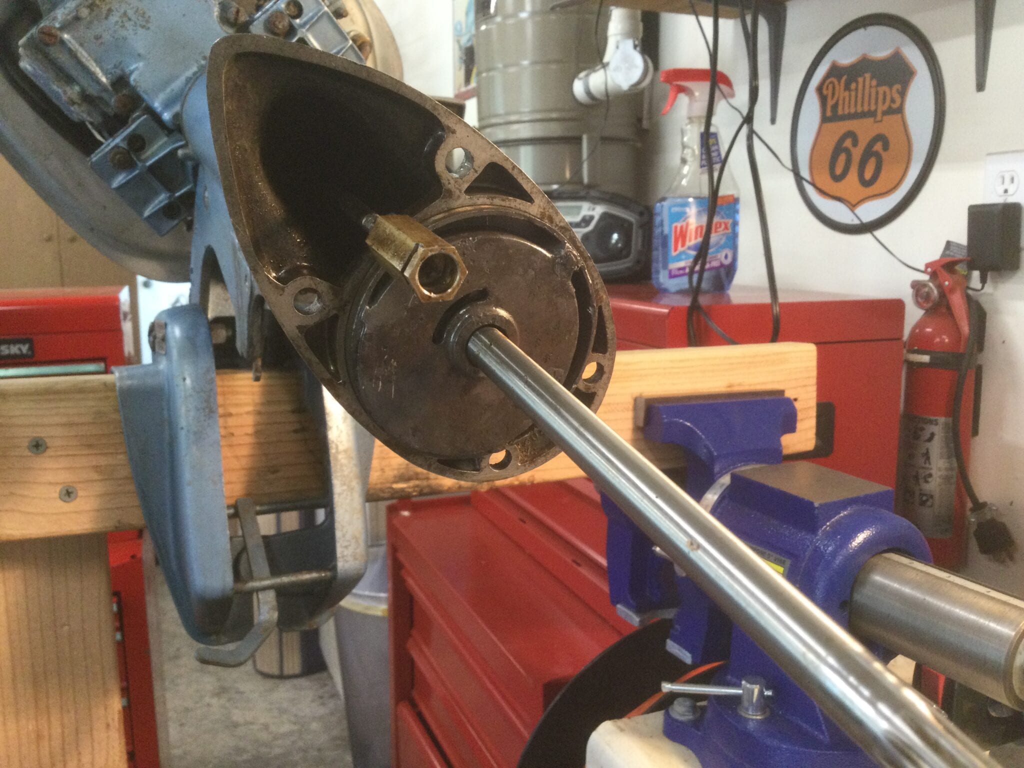

      Having trouble getting the impeller housing off of the Evinrude 7.7 HP Fleetwin, I am trying not to destroy it and reuse it . Seems like it is pressed in or ?? Anyone been thru this ?

      #238382
        Try heat ?????
        #238384
          It should fall out. In fact, it is held in place by a flat metal spring below it. Must just be corrosion around it.
          #238388
            In the picture, what’s up with that tab on the right side of the housing? Epoxied in place or something?
            1982 Evinrude 25hp
            #238389
              Notice there are no screws in the housing—it can rotate in there. EXCEPT for that tab which fits into a notch in the gearcase which prevents it from rotating. Along with that, a flat spring holds the pump housing up in place (no screws)
              7512

              #238393
              Rusted Junk
                I got it out , thanks for the advise,

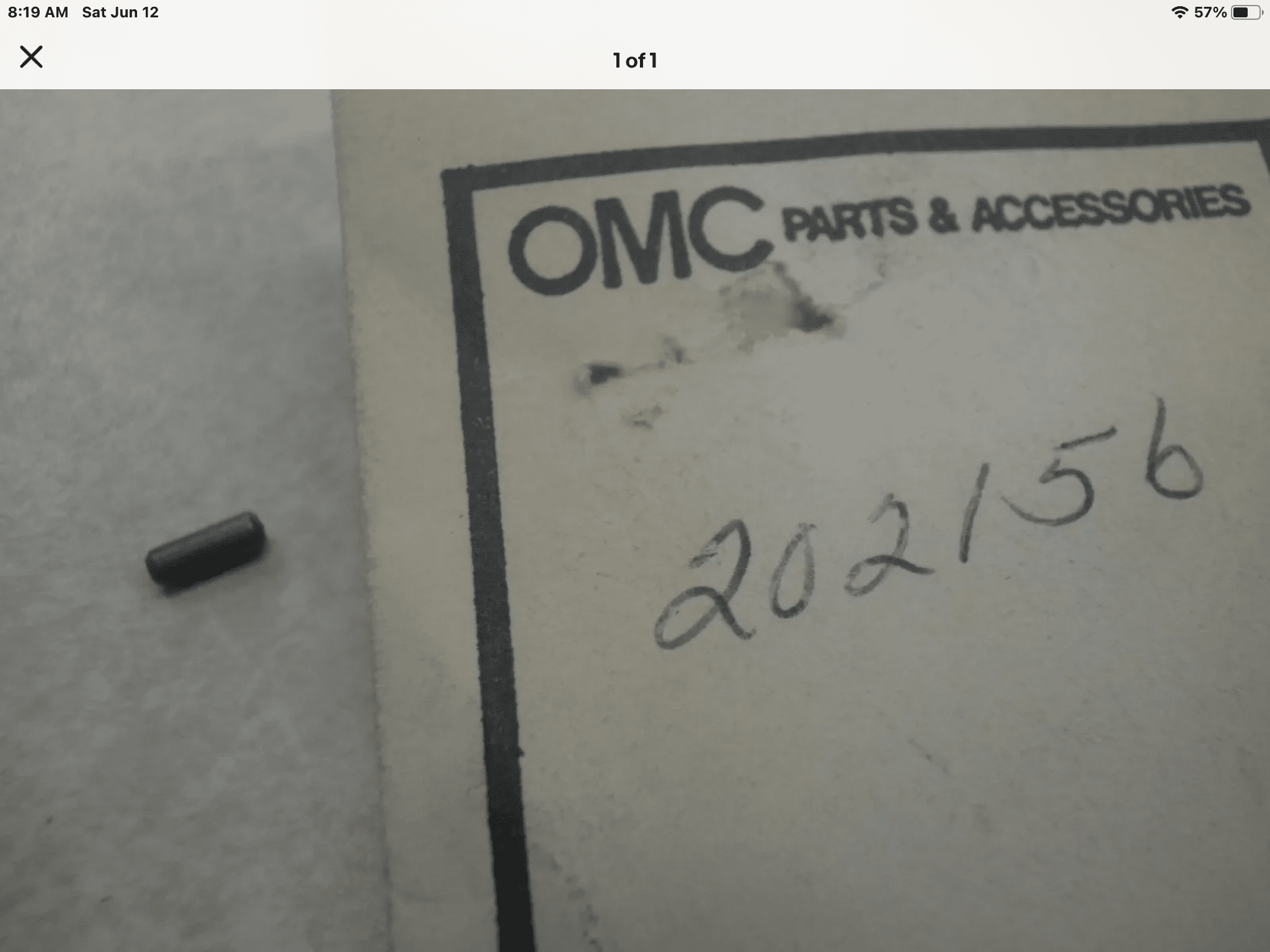

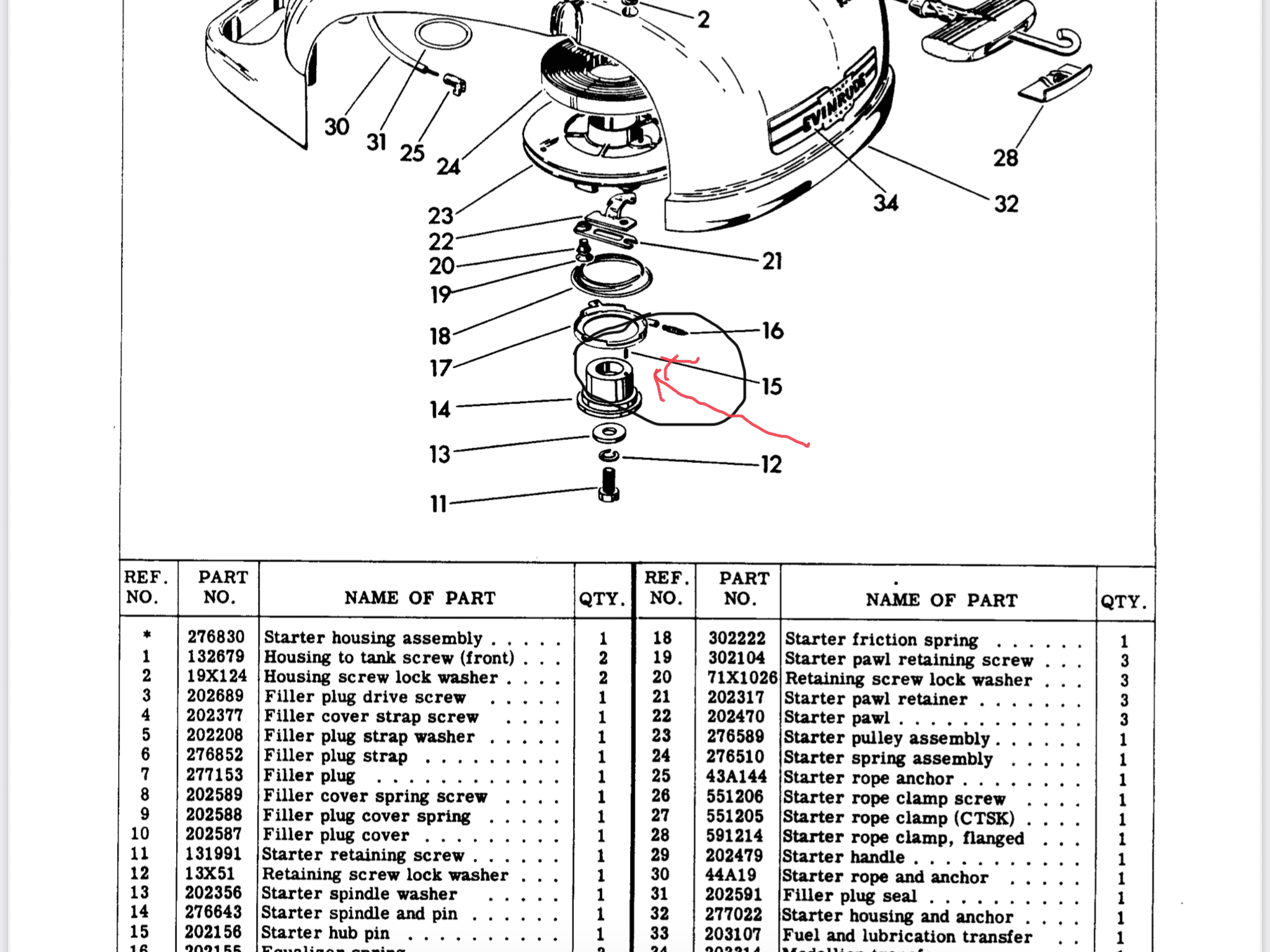

                    I have the neutral clutch working and the new impeller is working nicely, my next project is to replace the recoil spring, the parts diagram shows there is a starter hub pin #202156 and the starter spindle and pin. Are there two pins in the assembly, the only pin I see is the one in the starter spindle, if there are two pins where does the other one fit into the assembly.
                    Thanks,
                    RJ

                    #240105
                      Only one pin. It is just saying if you order a spindle it comes with a pin installed.
