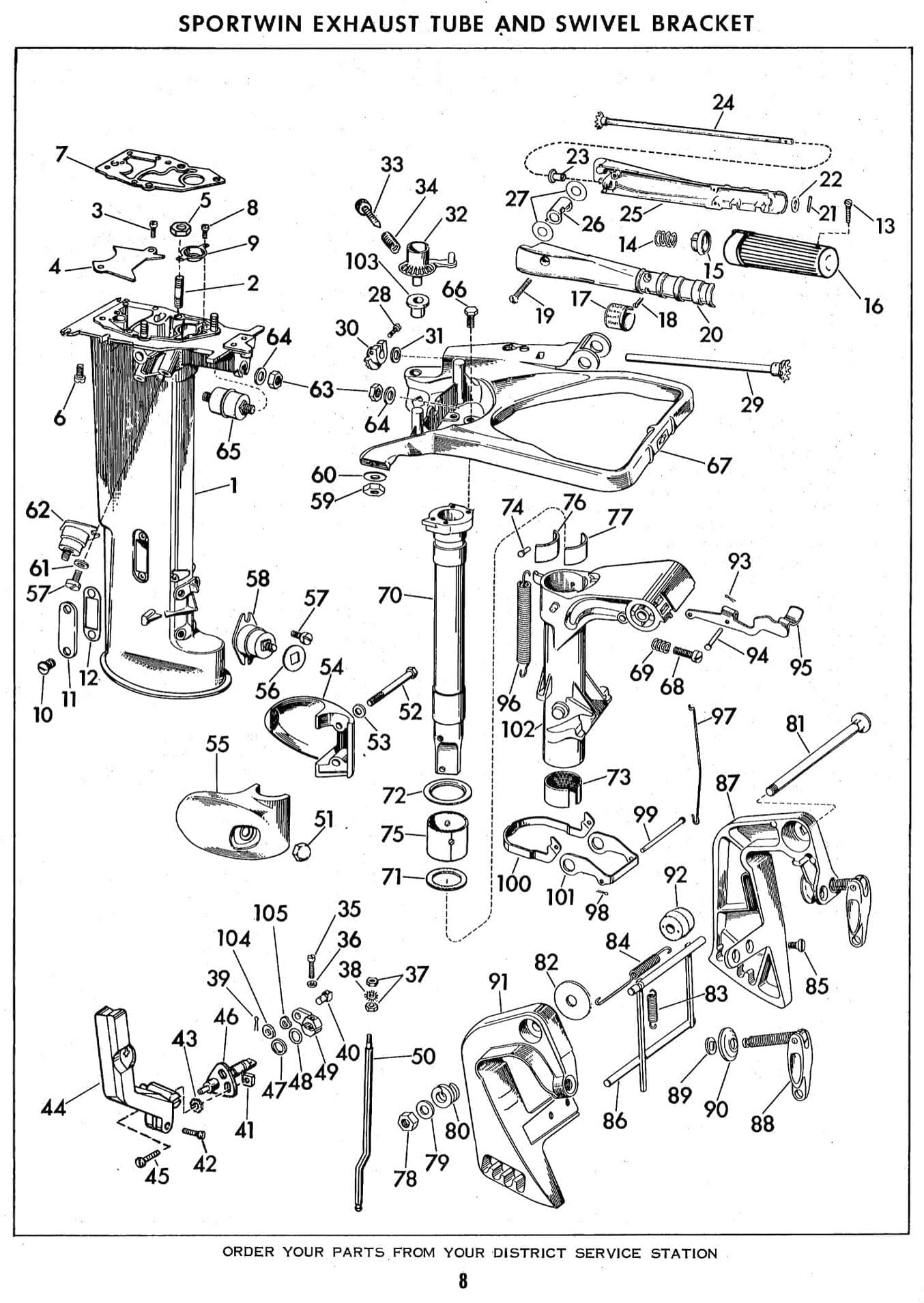

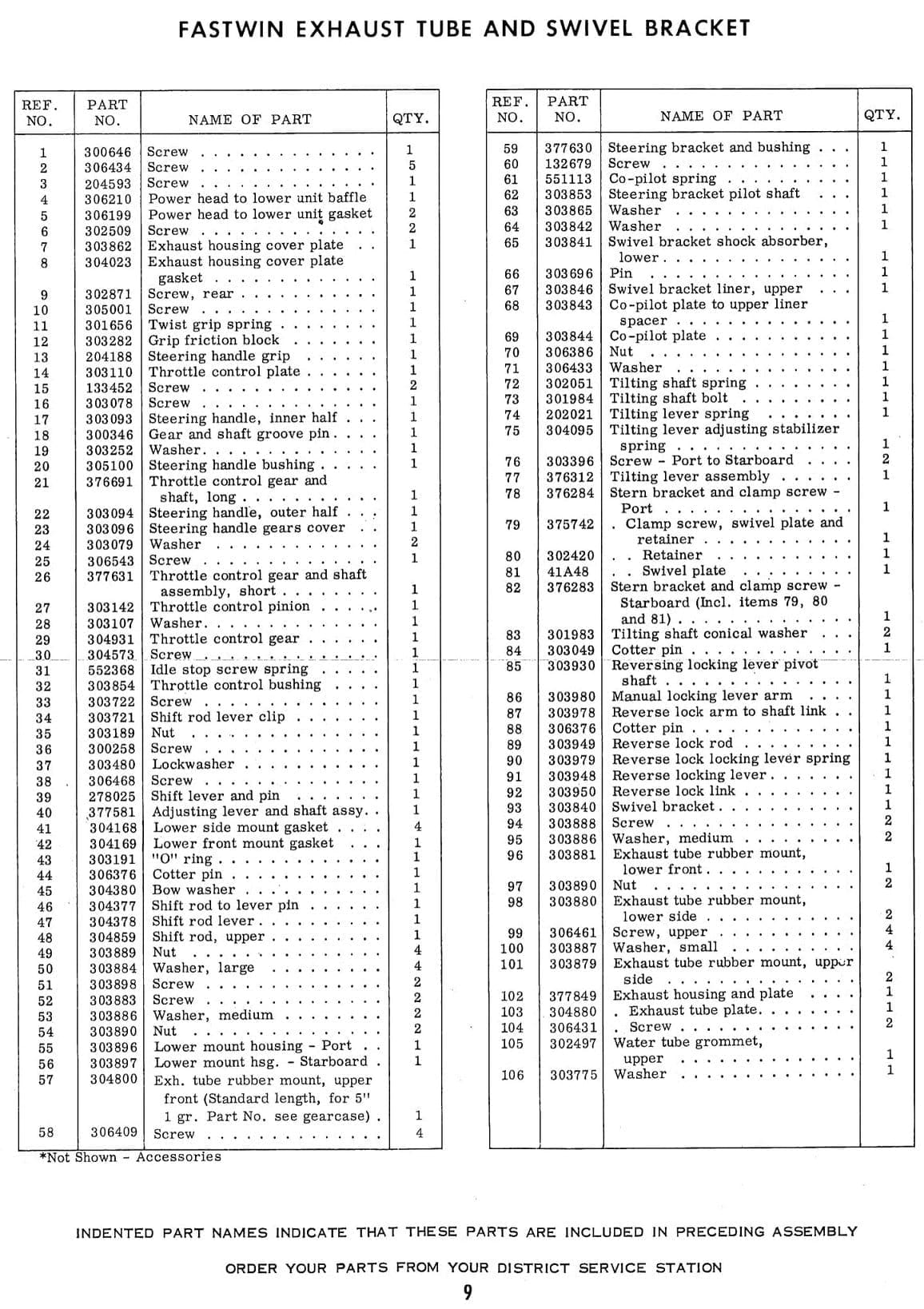

      Has anyone seen this with any other years/HP? This is from a ’59 10 horse manual and I think I’ve seen it with a ’56 15 HP too. Totally screwed up parts numbers. I quickly scanned through a couple other pages and they looked ok. Fortunately MarineEngine does have this one listed…for now.

        Nevermind…don’t know how I missed it but I just noticed that pg. 9 is a Fastwin page. Odd…I don’t remember where I got this from but that’s how I received it. Anyone got the correct page for the Sportwin?
