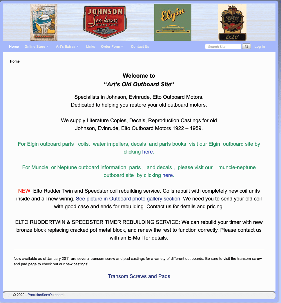

            Art DeKalb has the correct transom clamp pads for your 1911 Evinrude rowboat motor – #49 clamp pad – see our Links page under for the old Outboard.
            Screen-Shot-2020-01-13-at-5.29.47-PM
