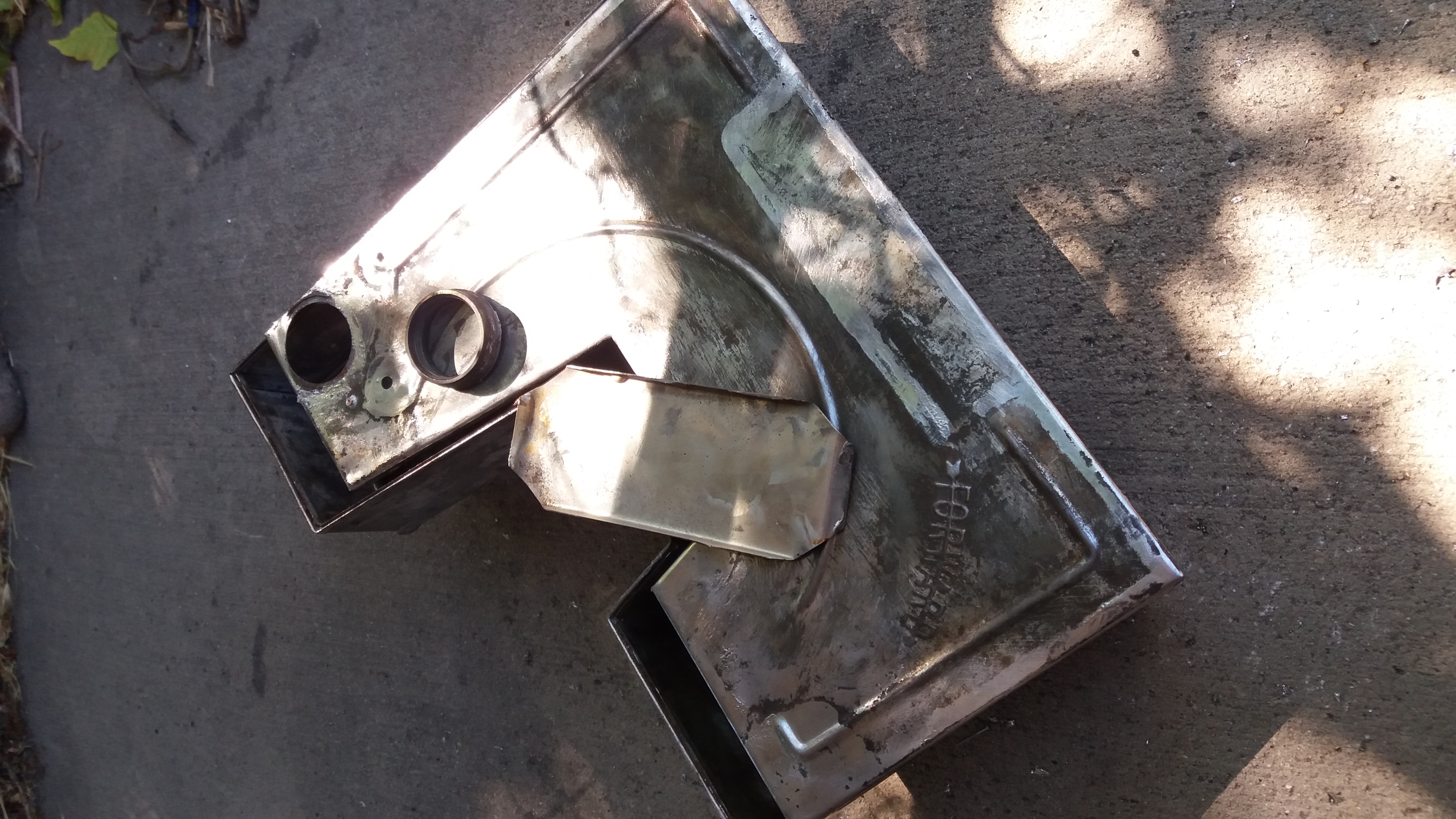

      ….So, ive had this rbm for a while and im trying to do a good job on the restoration. the tank is reletively fixed with the exception of solder and blemishes. im wondering what is the best kind of solder to use? also the minor denting on the front is irritating. i figured i would put some primer/filler on it and sand it smooth. i tryd to press it with flat peices of metal and a c clamp, which worked somewhat, but as you can see there are still blemishes. any thoughts?

        Soldering these tanks back together is still a
        learning process for me so this may not be
        the best but its what use. As the joints have
        already been soldered they can be considered
        tined so I use straight solder that doesn’t have
        any flux. If I have a spot that the solder
        doesn’t take I’ll clean it out as best I can and
        use a little soldering paste there. Using a torch
        you don’t want the flame on the solder. Instead
        you apply the heat near the joint so the joint
        gets hot enough to melt the solder. The flame
        will burn the flux and will keep the two surfaces
        from bonding. As far as the dents its basic body
        work. If you don’t have any experience in getting
        your tank perfectly straight the razed parts
        of these tanks make it even more difficult.
