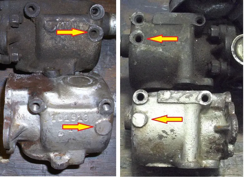

      When looking for a replacement cylinder you need to be sure that its drilled for the Scout side covers. Pal cylinders are not. Also the 37 Pal and Scout have a cast iron cyl. If you decide to go Pal, the early 4253 Pals also have the cast iron cyl. but later motors, and the model 4266, have an aluminum cylinder.
