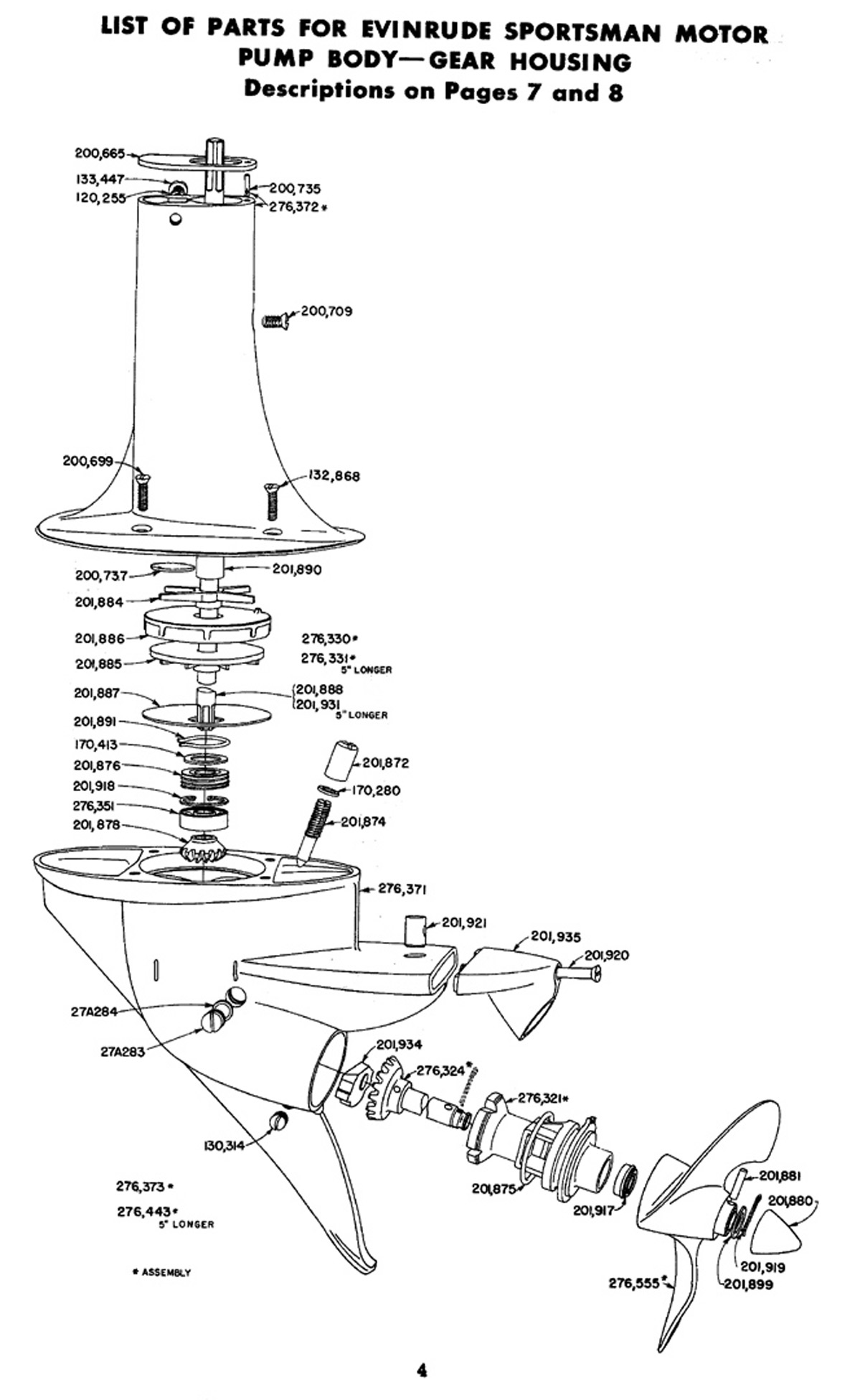

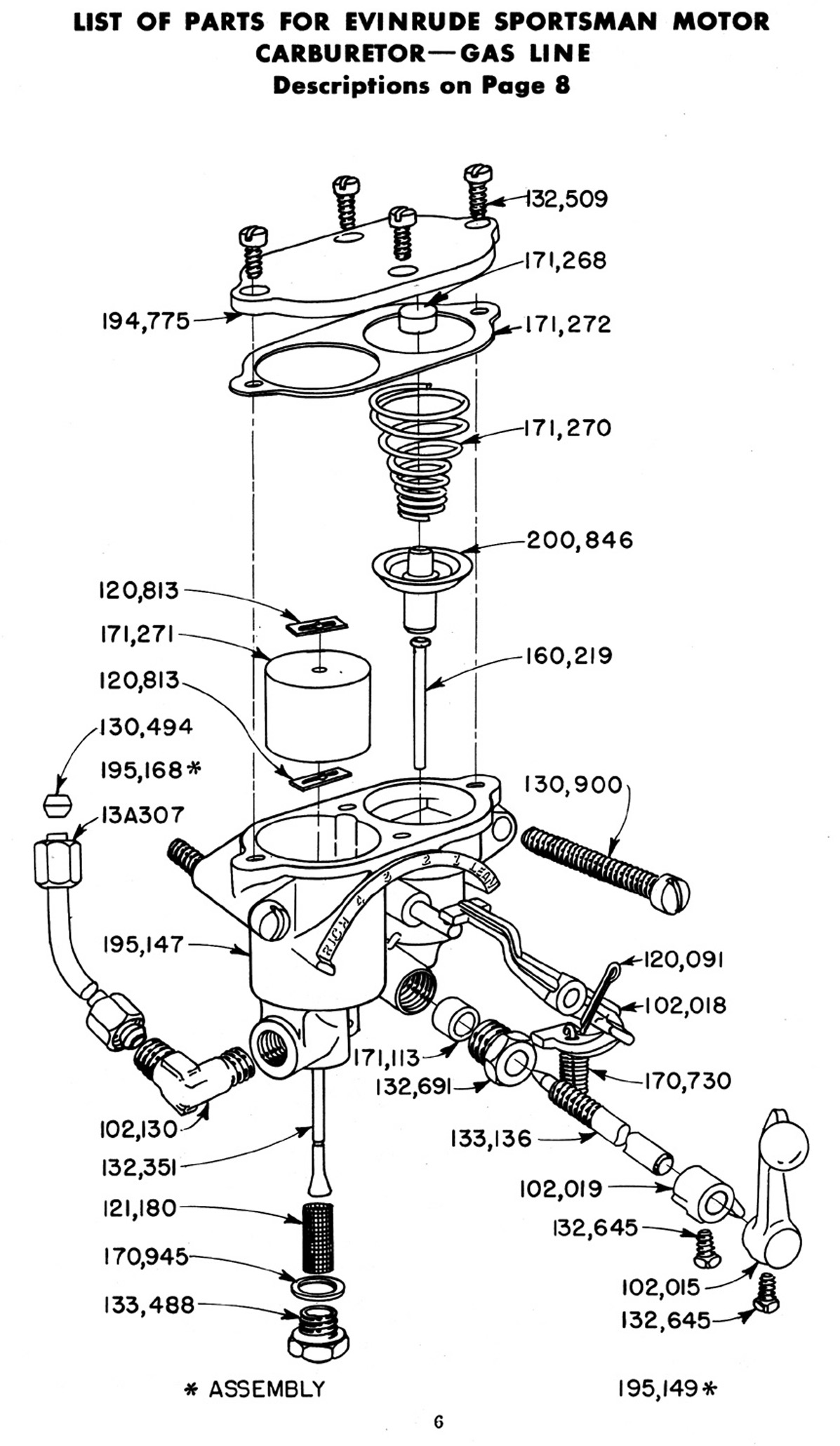

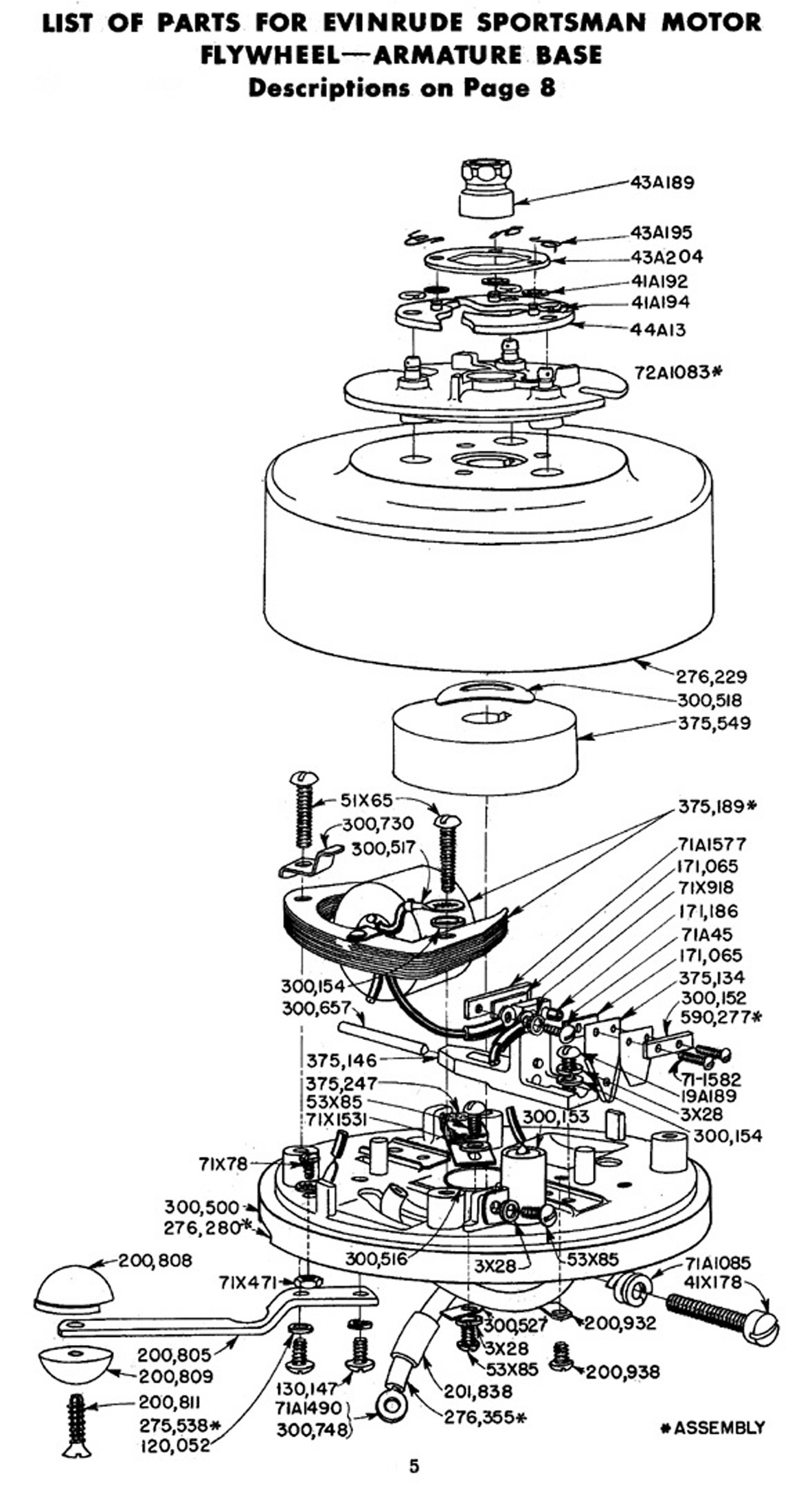

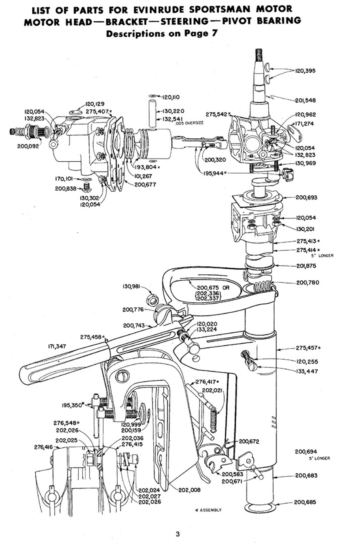

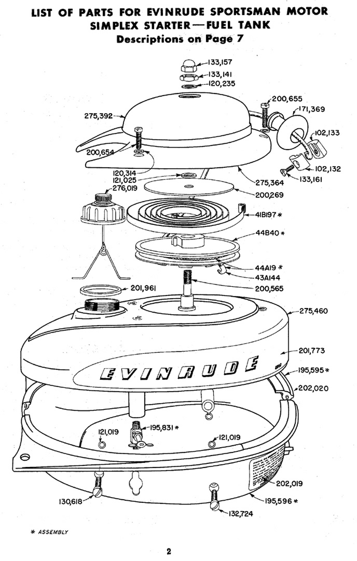

          Don’t have the 1946, but here is the 1947. Maybe it will help??

          todd281
            thank you for the .jpgs they were just what I was looking for. hopefully i will be able to find some parts now.
