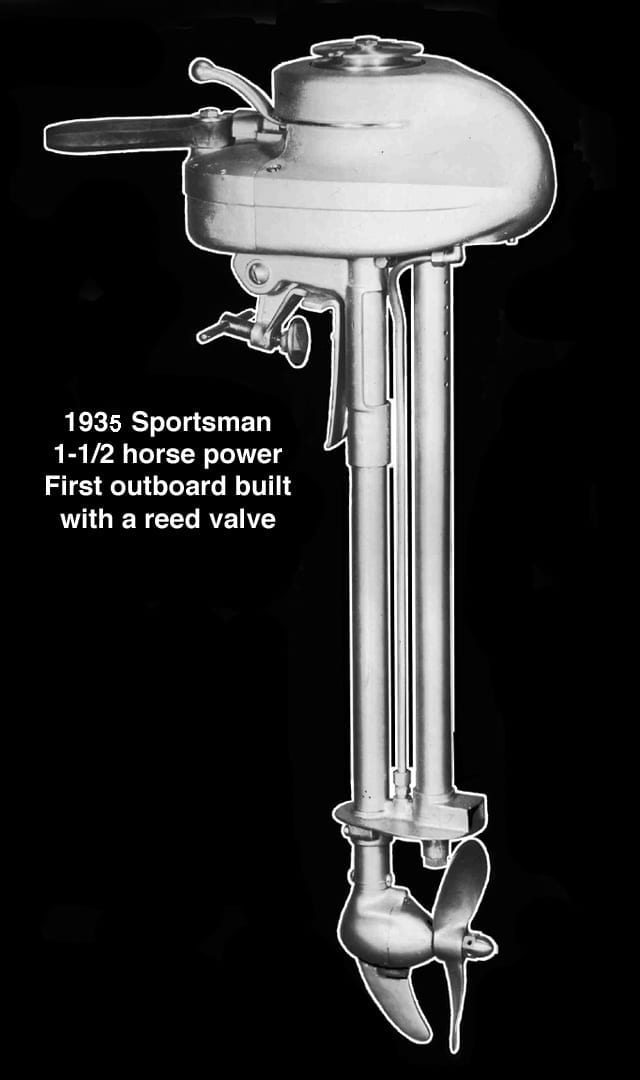

            I did find this photo though, probably from Garry.
            35_Sportsmn
