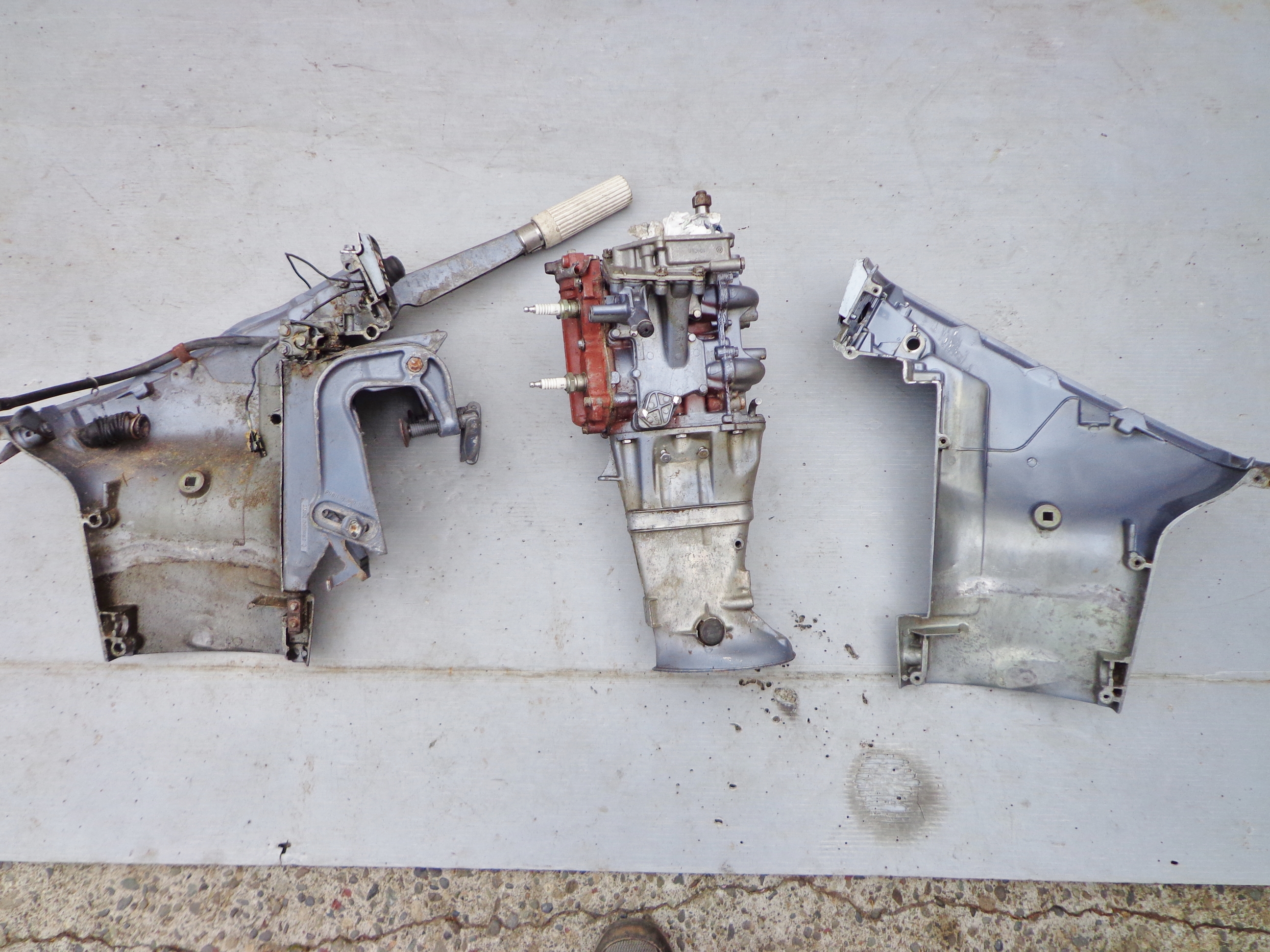

        PugetSoundBoater
          I parted out a 9.5 ,gave parts to a member. What a hard to work on motor. I’m sure the QD would be a much better motor and easier to work on. More Hp is always a good thing.
