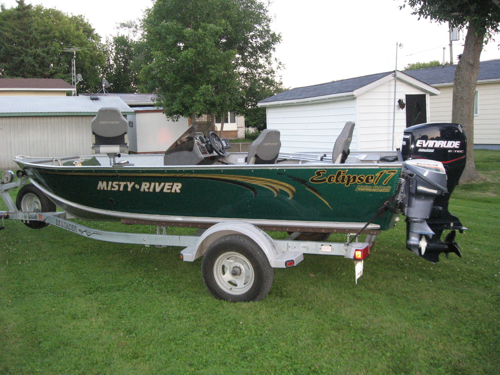

                    I have QD15 in the garage ready to go but sleeping…… but my 9.5 serves and fits me perfectly as back-up to my high technology ETEC
                    it all depends on needs and wants I guess
