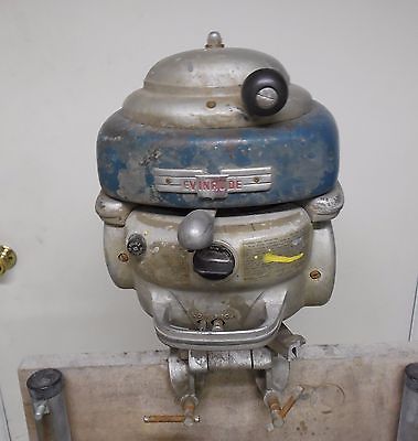

      Hello it’s me again I have another about the Evinrude zephyr 4404 I noticed the manual string pully it has 3 bolt holes is that so I can get a pull cord spring loaded starter or is this just a old school manual wrap only motor?

          mine is missing the top no pull string i have to wrap a rope around it looks like whats in pic on mine i just wrap around it

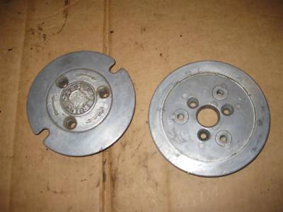

            You should also have threaded holes in the top of the gas tank.
            This shows a little better how it goes together. . .
            Because of slight differences in castings, the hub of the starter pulley should be centered on the crankshaft after the housing is firmly in place. The 395460 is the most popular rewind spring used in both Evinrude’s and Johnsons. It is also available as Sierra Marine part number 18-6501. Most AOMCI members make there own 43A195 pawl springs. 😀

                Post a free want-ad here – someone may have one. You’ll also need the springs (3), equalizer ring, washers (3) snap rings (3) and pawls (3) as shown above. I believe Dan Gano has all those parts:

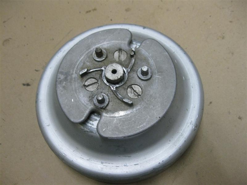

                  Here’s a picture of mine what springs do I need?

                    I have the starter assembly, (part number 275,317 on Gary’s diagram) but not all the small parts that mount to the flywheel.
