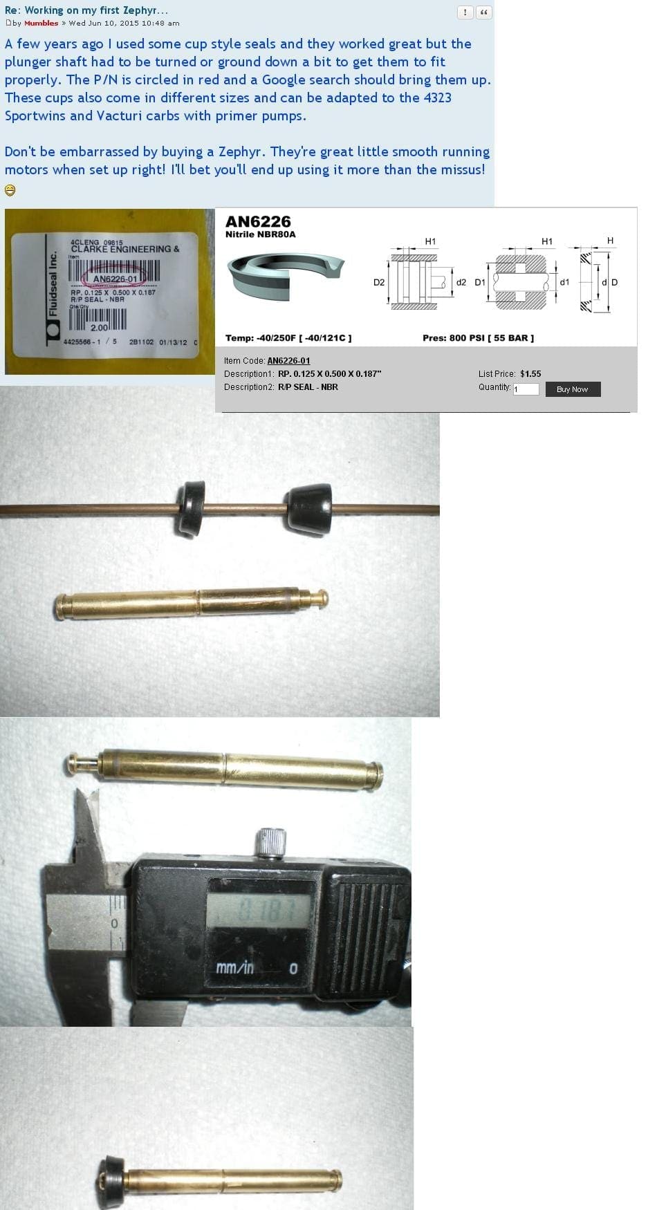

      A friend has need to replace the old seals in a couple of Zephyr carbs. Where can he get what is needed? Thanks. Bob Grubb PA

        I saved these words of wisdom from Mumbles, on replacement seals.
        Zepher-primer-seals
        #166749
          The O-ring store appears to have them.
          https://www.theoringstore.com/index.php?main_page=index&cPath=371_172_171
