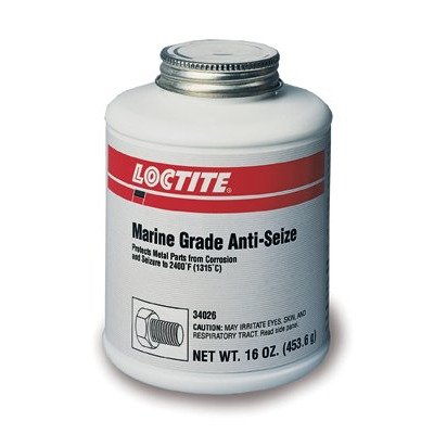

        quote crosbyman:
        just curious but could the standard white or yellow plumbing teflon tape make bolt removal simpler in the long run,as well as reducing metal to metal corrosion ?
        I doubt the Teflon tape would handle the heat. I use a good anti sieze,without copper. I recently found Jet Lube Marine Grade Non Metallic Anti Sieze in my search for a good anti sieze. This should do the trick. Also the OMC or Perfect Circle gasket sealer is a good choice from what I was told by outboard mechanics.
