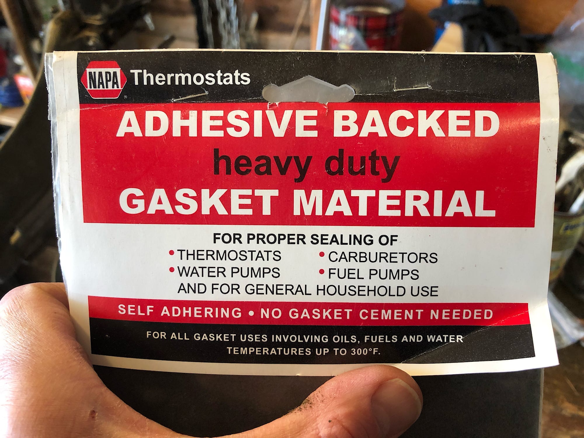

            So this stuff says it’s good up to 300 degrees. How hot does the exhaust get on a little 2 cyl motor like the kd4?
            NAPA part number STM-2
