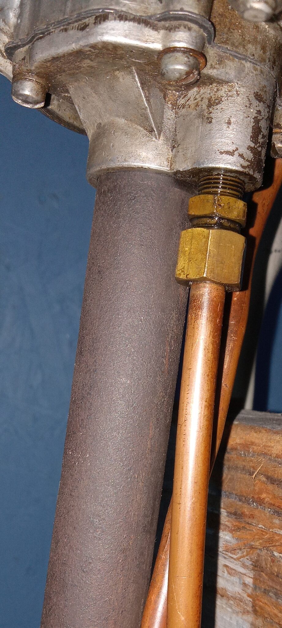

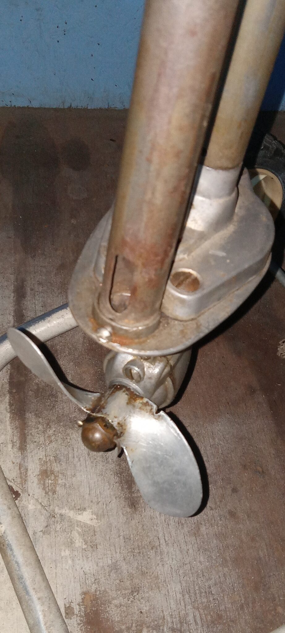

March 29, 2025 at 9:10 pm #294971I got pictures of how the pipe is held in. The simplest way I can describe it is that it is sandwiched between the lower unit and the powerhead. It does look clean in the pictures because I cleaned it and haven’t ran it since.
I haven’t really tried to make a gasket yet, because I wanted to know what any possible solutions were. There really is nothing to torque down, and the machine screw at the very end of the pipe where it meets the lower unit is to keep the pipe from rotating with vibration. Hopefully the pictures help, and if I need, I can always take more.March 29, 2025 at 9:12 pm #294973March 29, 2025 at 10:15 pm #294976Hmm, so that’s a different situation than what I wrote about earlier. Looks like a tiny little bit of pitting on that exhaust tube. It looks pretty tight clearence-wise at the top between the tube and powerhead so maybe just add thin little layer of heat-resistant (and fuel-resistant) paint on the tube around the top section where to powerhead blocks it from being seen, and wipe the paint smooth before it dries so it doesn’t magnify the roughness of the tube. This would hopefully smooth out the tube’s surface so the extra fuel wouldn’t escape by seeping down through the low parts of the slightly uneven pitted surface on the tube.
However, you mentioned a loose fit. I’d be more inclined to suspect that is the problem and not the fuel leaking down through the minor pitting. If the tube wiggles vertically, maybe a gasket somewhere else can be swapped for a thinner one to compensate for the gap and reduce the vertical clearance. If it wiggles sideways, maybe try the paint to widen the tube just a bit. Looks like a teeny tiny bit of material wore away somehow, circled in the attached image, but I don’t think that would be enough to cause the problem…
