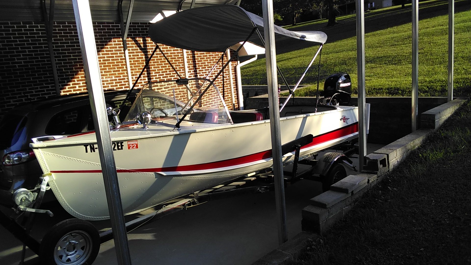

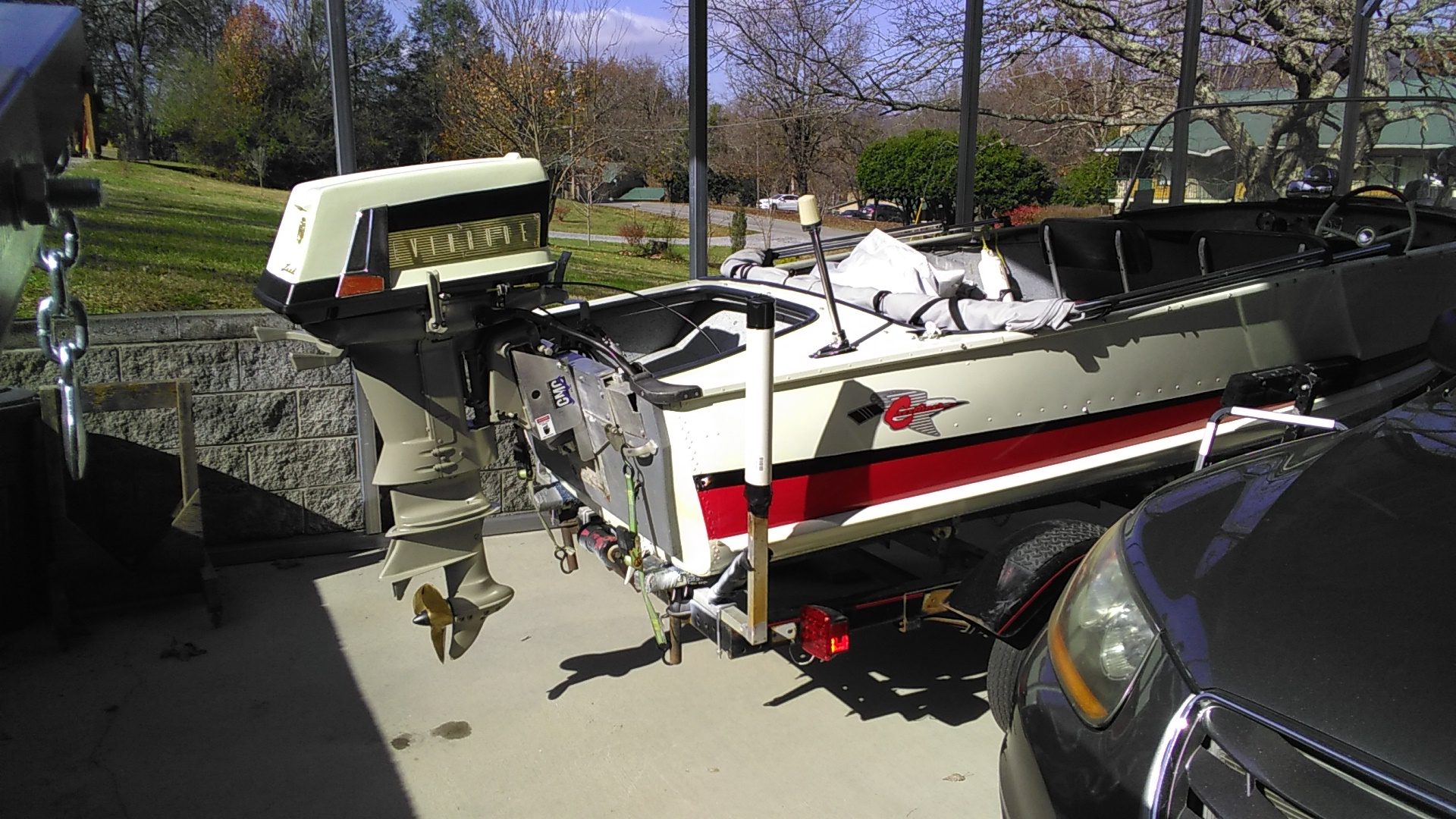

      Here’s a few pictures of my Crestliner with the 1959 Lark installed. One pic before swapping motors. I refurbed the Lark and wanted to find a 1959 boat to put it on. Checked Craigslist and other sites for several months and couldn’t find anything in my area. Then the Crestliner appeared on Craigslist just 6 miles away! It was in great shape with no dents or leaks, so I bought it. Been working on it ever since. Fun project!

                Nice job! I love the paint design on the sides of the hull! As you probably know, 1959 was the first year of the raised center trim on the deck that extends through the notch under the windshield. Also first year for the new-design bow handle. The splash rail was all new for 1959 too. Your Bimini top is after-market.

                  Lindy, NICE looking outfit! I know how much work it is to rebuilt a project like that. I did the same thing on a LoneStar a couple years ago. I see you have a power tilt on your transom. Motor looks like a long shaft. I also had the same power tilt with no long shaft motor. When I ran the outfit at planing speed the exhaust would come out of the water. I was worried the motor might not be pumping water so I took the power tilt off and sold it. You might have the fix I needed for my boat! Anyway she sure looks good!

                        The power tilt was on the boat when I bought it. Worked fine with the Mercury motor but I haven’t as yet run it with the Lark. The instructions say that since the tilt mechanism positions the motor 5″ father back from the transom, the cavitation plate should be 1-3″ higher than the bottom of the boat. With the Mercury it was 1″ higher. With the Lark it’s even with the bottom. Unfortunately I won’t find out how it runs until spring. I like the idea of the electric tilt as it is difficult to reach back over the well on this boat to hand-tilt the motor. So I hope it works OK.
