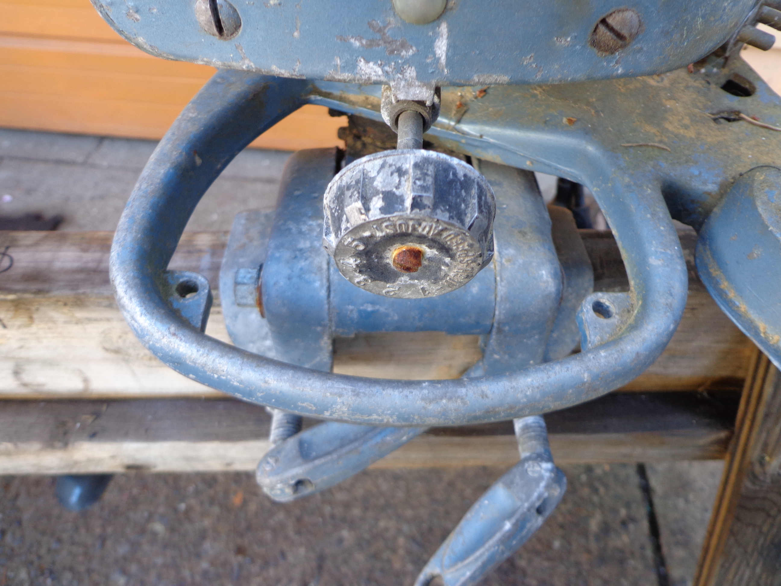

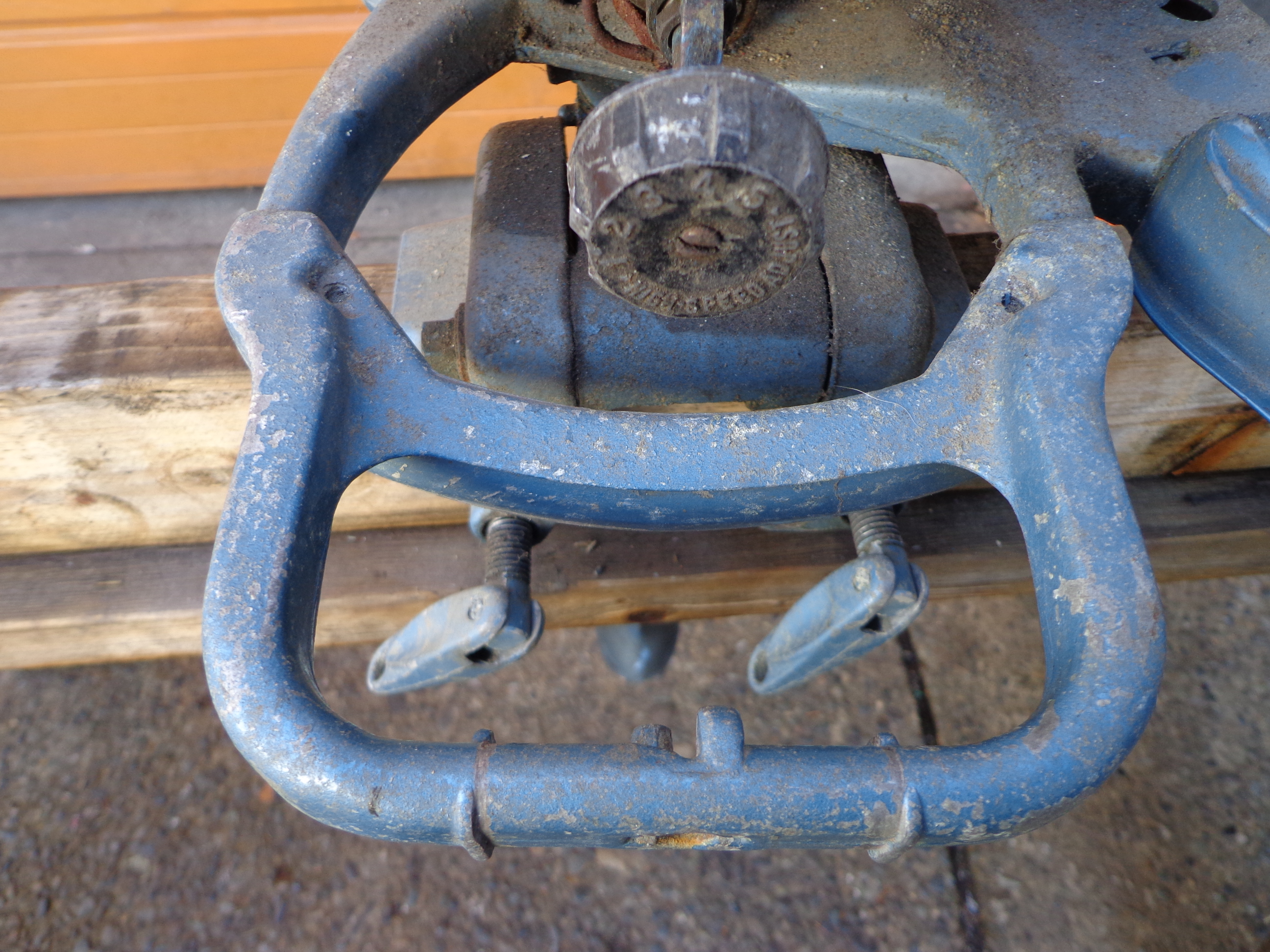

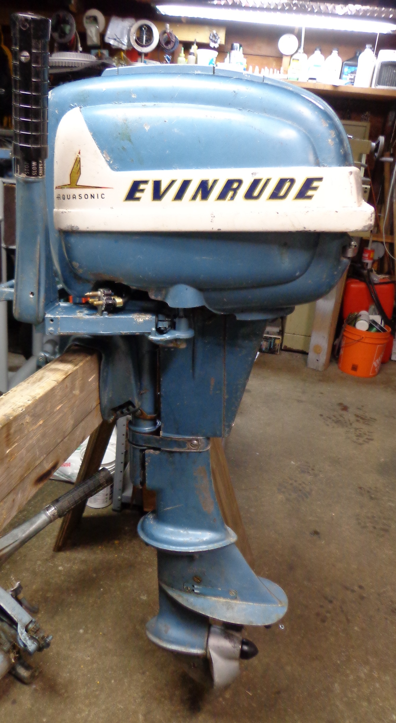

      A pair of ’55 Evinrude Fleetwins were left on my doorstep last week but one of them is slightly different than the other one. On the front, it has an extension for remote steering hardware bolted onto the carry handle. The carry handle is the same design as other 5 – 7.5 OMC motors of the era with the two tabs on it but I’ve never seen the extension before. Is this piece a hard to find factory option?

            Yep, factory accessory remote control adapter kit. Also includes a bracket to hold the shift cable. My dad had one on his 7.5 back in the day.

                      Yeah, I didn’t think it was a very common piece. Now I know! Thanks guys!
