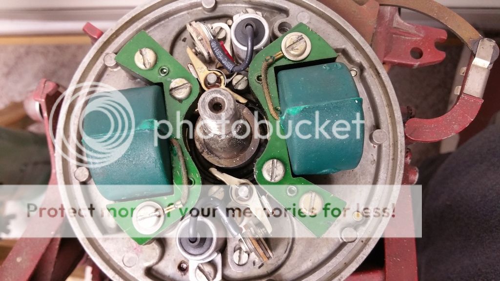

I picked up a really ugly FD-10 in the fall. I started to tear the thing down and when I pulled the flywheel I was surprised to find this:
I was expecting the usual cracked coils, but everything here looks brand new. There is a little pitting on the points, but my guess is that it wasn’t run much since the rebuild. Any idea when this might have been done based on the coils? The coils and points have a small ‘m’ on them.

December 31, 2016 at 10:19 pm #50042December 31, 2016 at 10:33 pm #50047January 1, 2017 at 12:39 am #50061We picked up a Lund S-14 DLX a month ago, and it came with a 1974 Evinrude 15 and a 1960 Johnson 10 hp. The Johnson was thrown in with the deal, as the owner claimed he put over $100 in parts and still couldn’t get it to run. When we pulled the flywheel off, it had brand new coils, but the cam was upside down. Other than missing the rear cowl latch, (found one on e-bay) it is a really clean motor. 😀 We may decide to keep this one. The 15 runs great, and we will be selling it in the spring. Kevin needs to turn some of these into tuition this year!

January 1, 2017 at 11:28 am #50090Here’s the savings at Marineengine.com prices.
584477 OMC Coil 23.43 (2) 46.86
580321 OMC Condenser 6.99 (2) 13.98
580148 OMC Points 12.99 (2) 25.98
Shipping 7.95
Total $94.77
