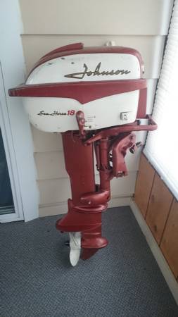

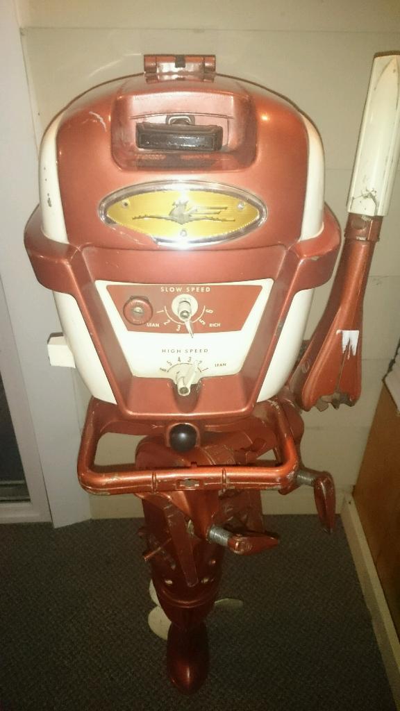

bought this motor tonight. it is a manual start but has an electric flywheel. as soon as I saw it, I looked for a starter, etc but no such luck. still a beautiful motor. one of the nicest original 1958 holiday bronze examples I’ve seen. tried like crazy to find something wrong cosmetically with this motor and the chipped medallion is the only thing I could find. i’ll get pics of under the cowl soon. looks like the carb has screw holes in it for the electric choke.
has anyone else ever run into or heard of manual starts equipped with a cogged flywheel?

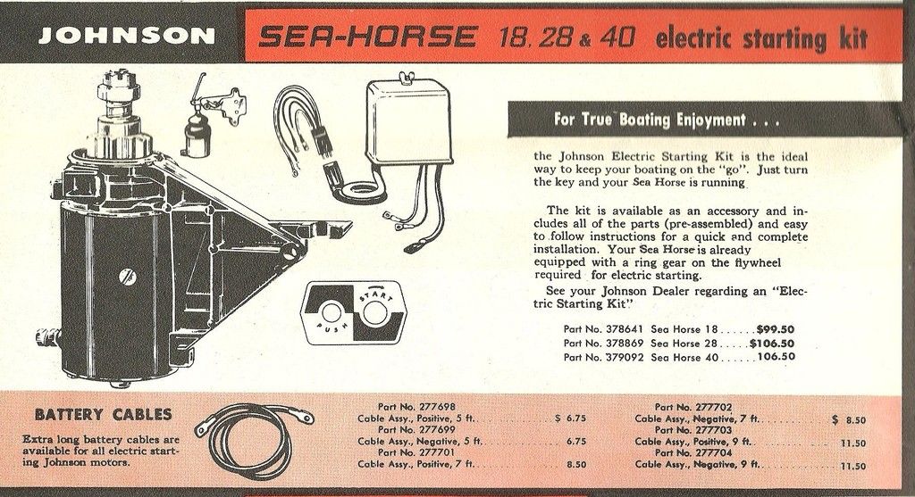

January 28, 2016 at 4:40 am #30920It seems to be a 50/50 chance an eighteen will have either a ring gear or an inertia ring on it but I think all of my ’57 and older Evinrude rope starts came with an inertia ring. I always smile when I see a ring gear on a manual start motor as half of the conversion job to electric start is already done. This ’63 Johnson literature says the motors all come with a ring gear.
Nice ’58 FD you have there but where’s the speed indicator band? ☺

see mumbles!? I knew one of you guys would find something missing or damaged or something. looks like it’s missing. the bakelite grip has a crack in it to like most of them will. hmm….i’ll have to find one.

January 28, 2016 at 11:19 am #30931Thanks for the offer zeph but I’ll bet the harness alone would cost more than I paid for this motor. When tuned well, these ones are easy starters anyway. For now this one’s still small enough to rope over by hand, but maybe in 10 years….. 😀
