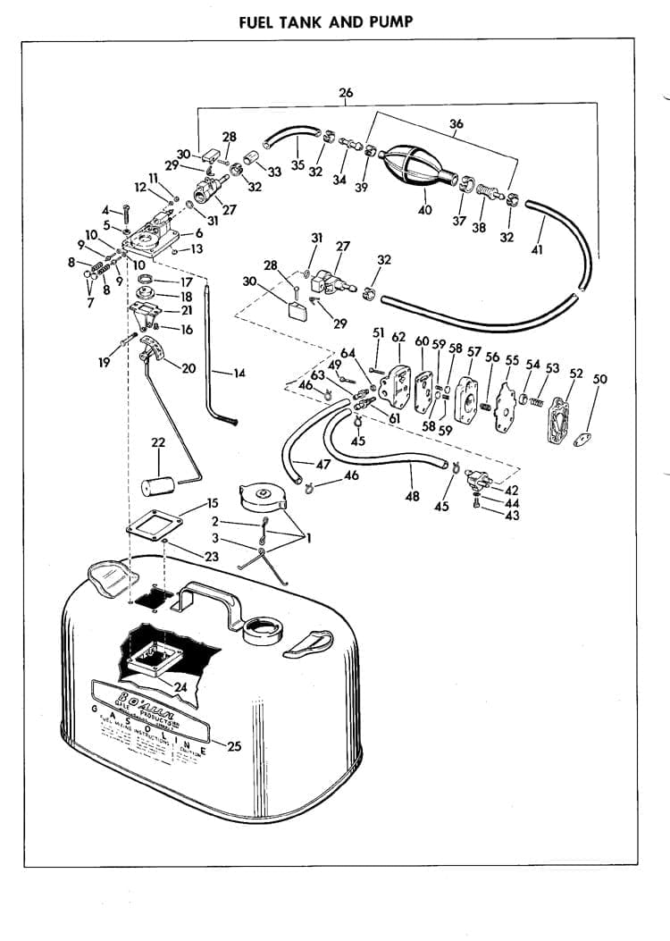

      Well, murphy’s law strikes again. While in the process of disassembling my FD-17’s fuel pump to inspect, my butterfingers dropped the pump and murphy finished my disassembly. Now I have a whole bunch of parts (none damaged) that I have no clue how to reassemble. Have spent some time looking, but can’t find any cutaway views of the pump that are of any help in reassembly.

                  They quit making parts for the original pump over 50 years ago. Here is a diagram if you want to try to salvage it. If it were me, I’d simply bite the bullet and replace it with a Sierra 18-7351. –Or—there are some Chineesium replacements on the -bay. I’ve never used one nor taken one apart to see if they are junk.
                  Pg-10-Fuel-Tank-and-Pump

                      skanders01
                        Thanks for the help, it was exactly what I needed! The pump is reassembled and will see if it works… all components looked good, and diaphragm was intact and pliable.
