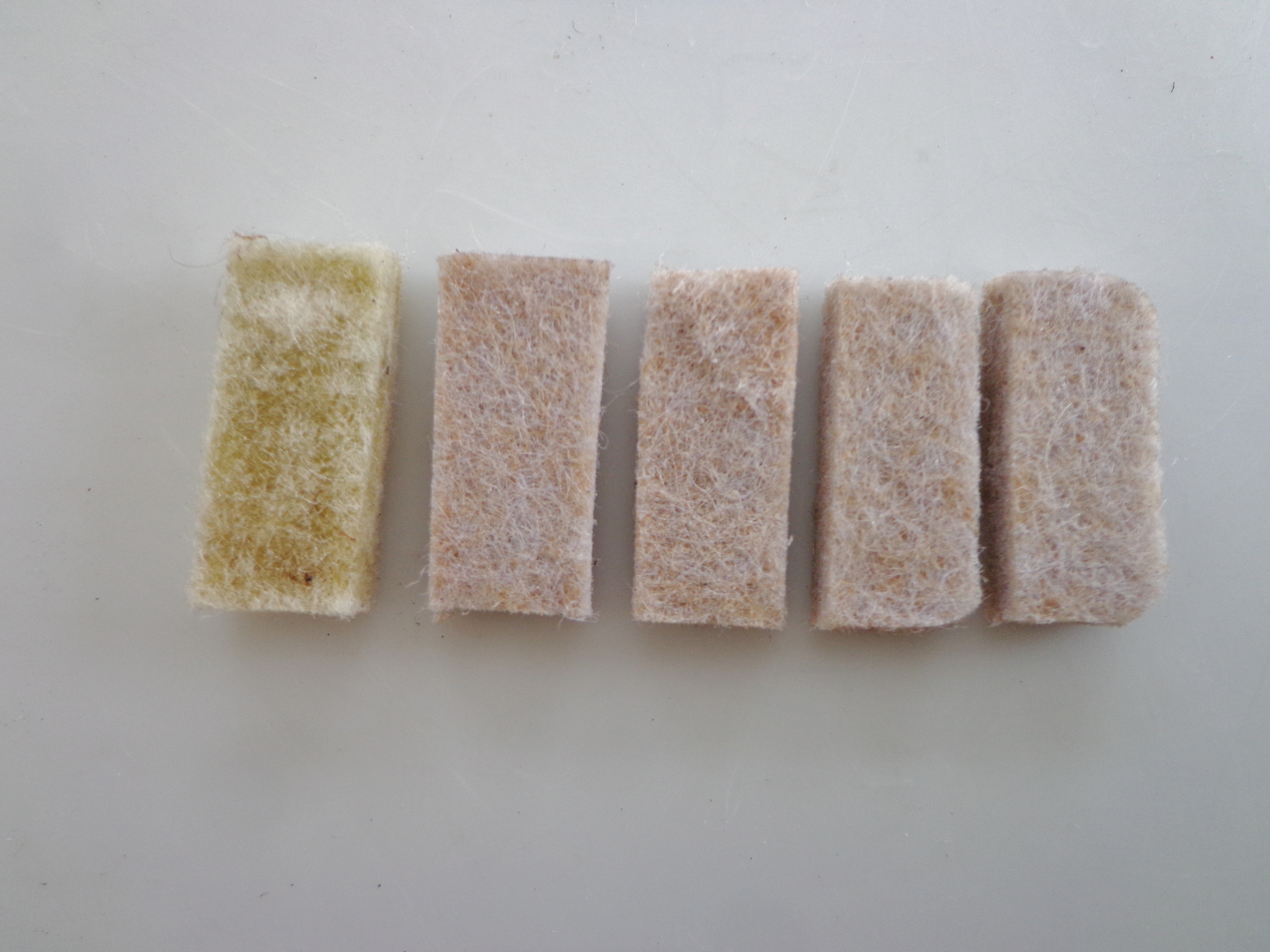

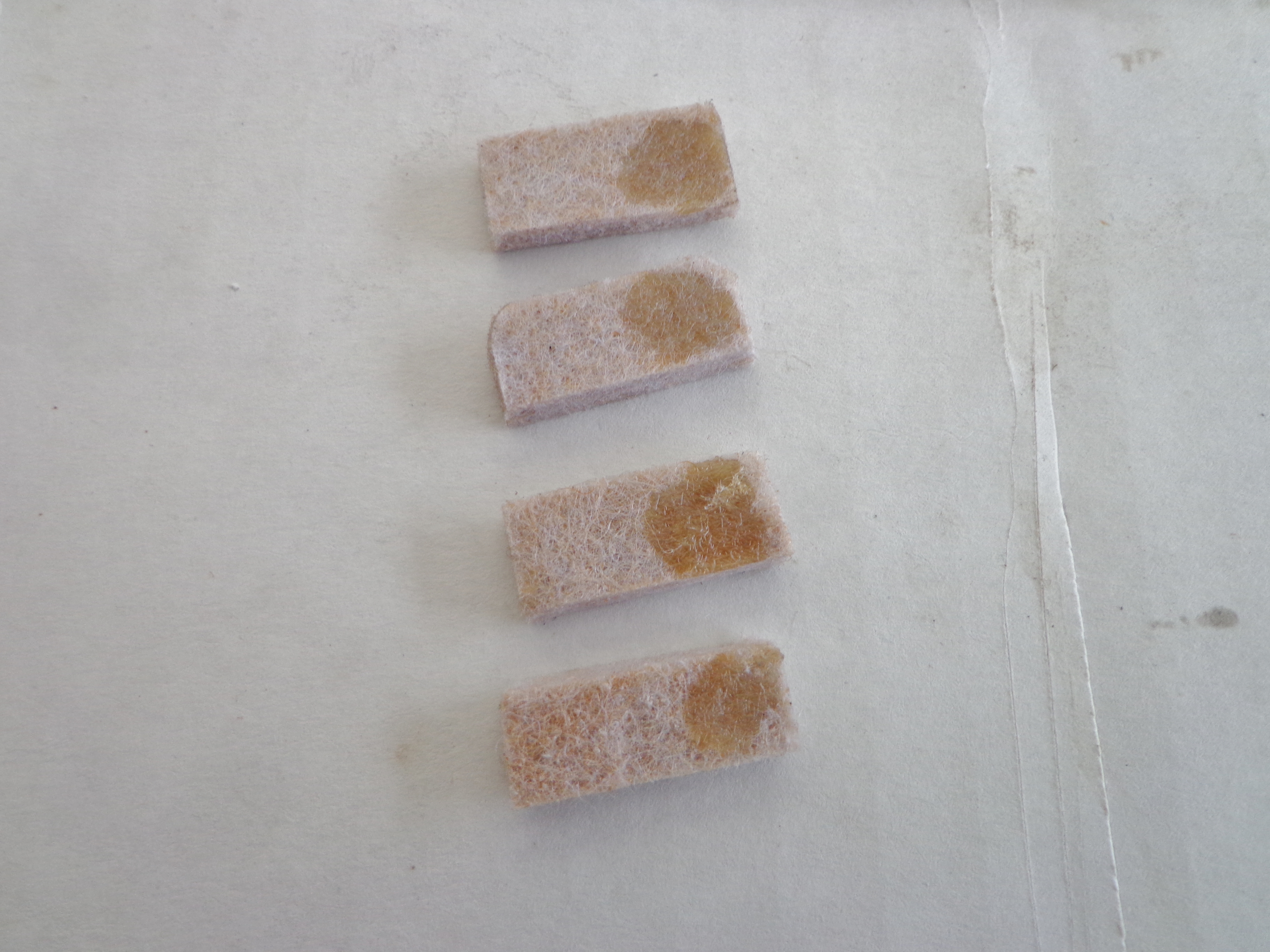

      While browsing thru the Big Orange store today, I came across these self adhesive felt pads for furniture legs but I didn’t see it that way. They must have been packaged and labeled wrong as I’m sure they are meant for oiling wicks so I bought me some to try. 😀

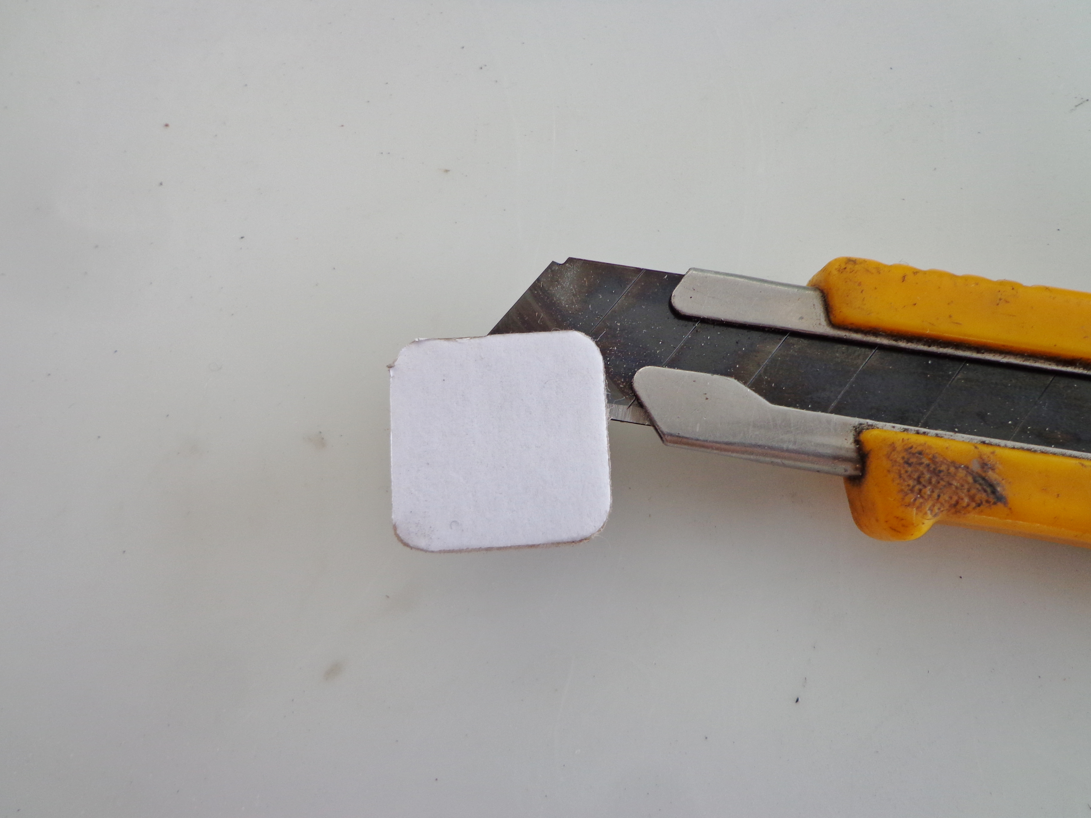

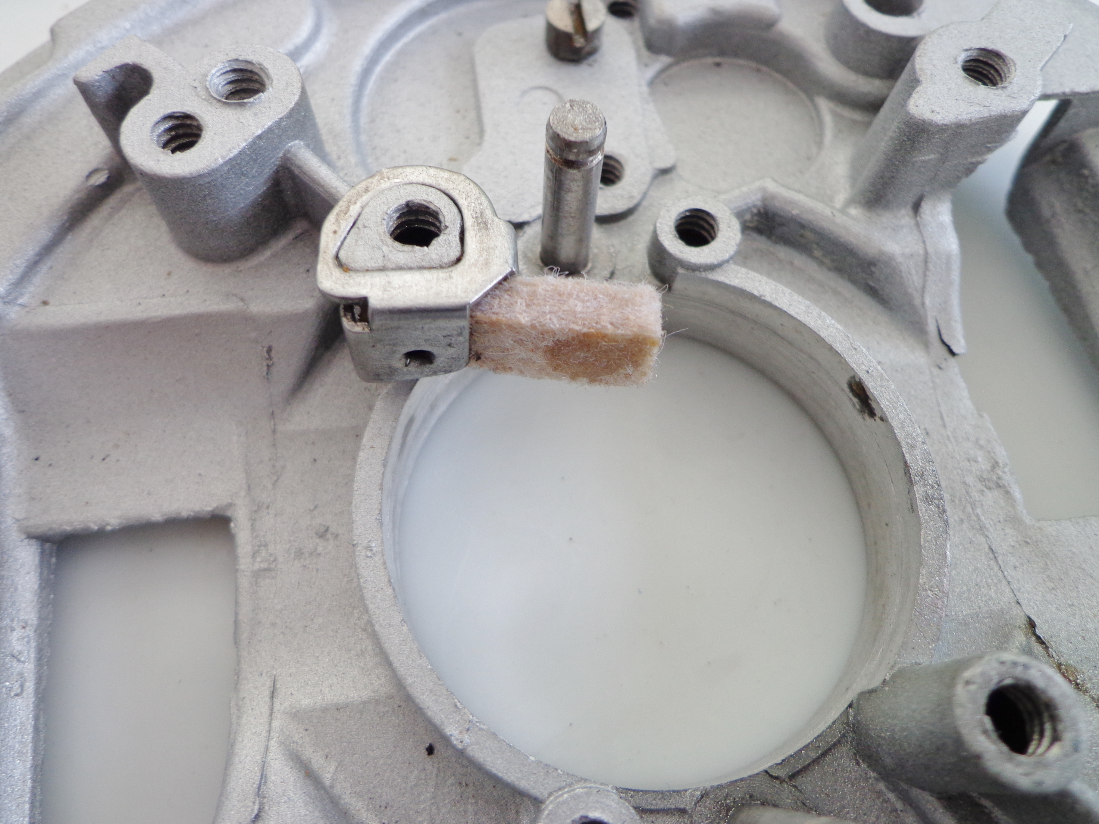

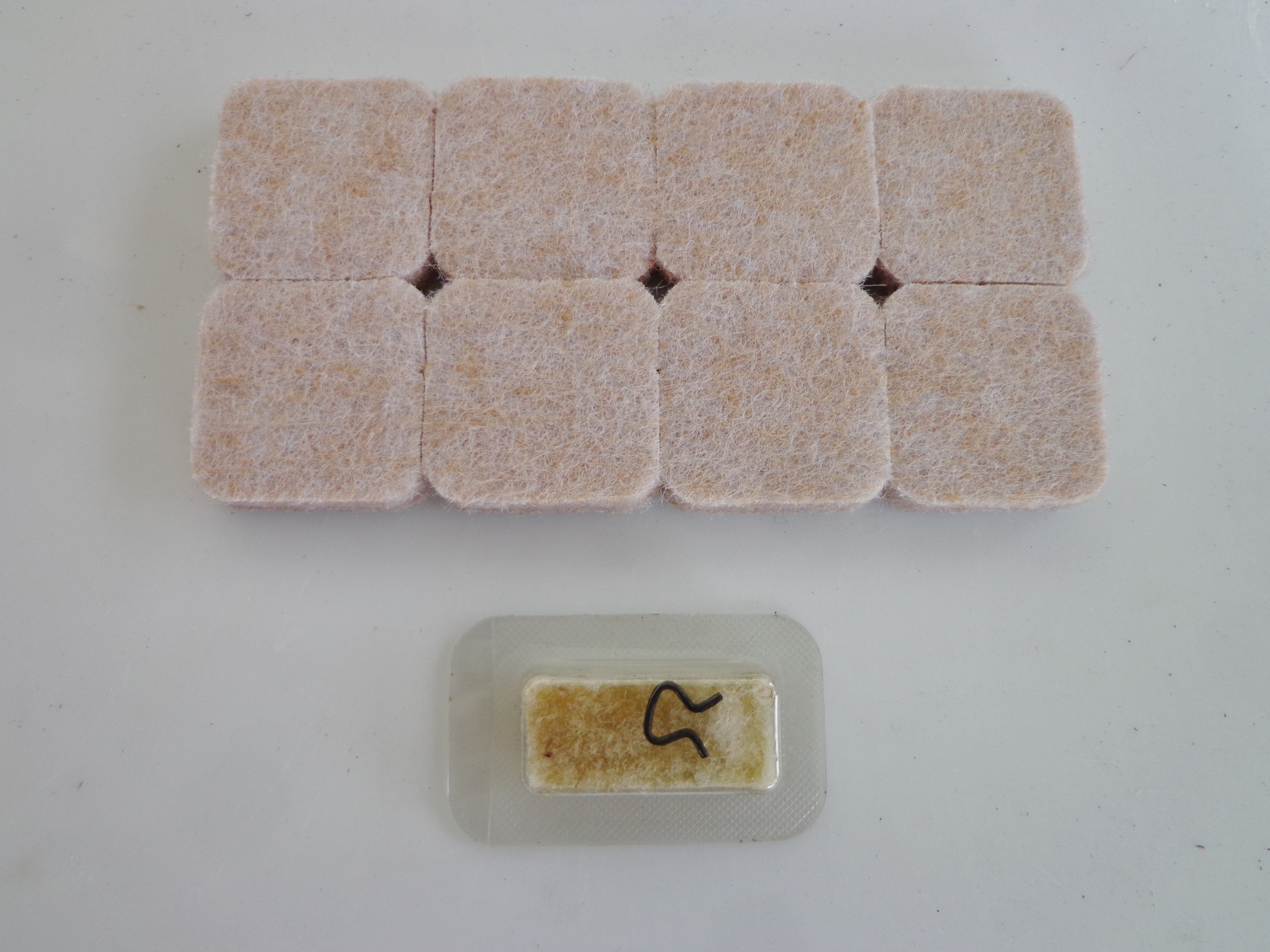

      After shaving the adhesive off with a sharp knife, they are only slightly thinner than the original OMC/BRP wicks but they are the correct length and fit well into the clip. There’s sixteen pads in this package which gave me thirty two wicks for the OMC mags and it worked out to roughly $.17 per wick. Can’t argue with that! They also absorbed a drop of oil quite readily so I think they should work OK.
