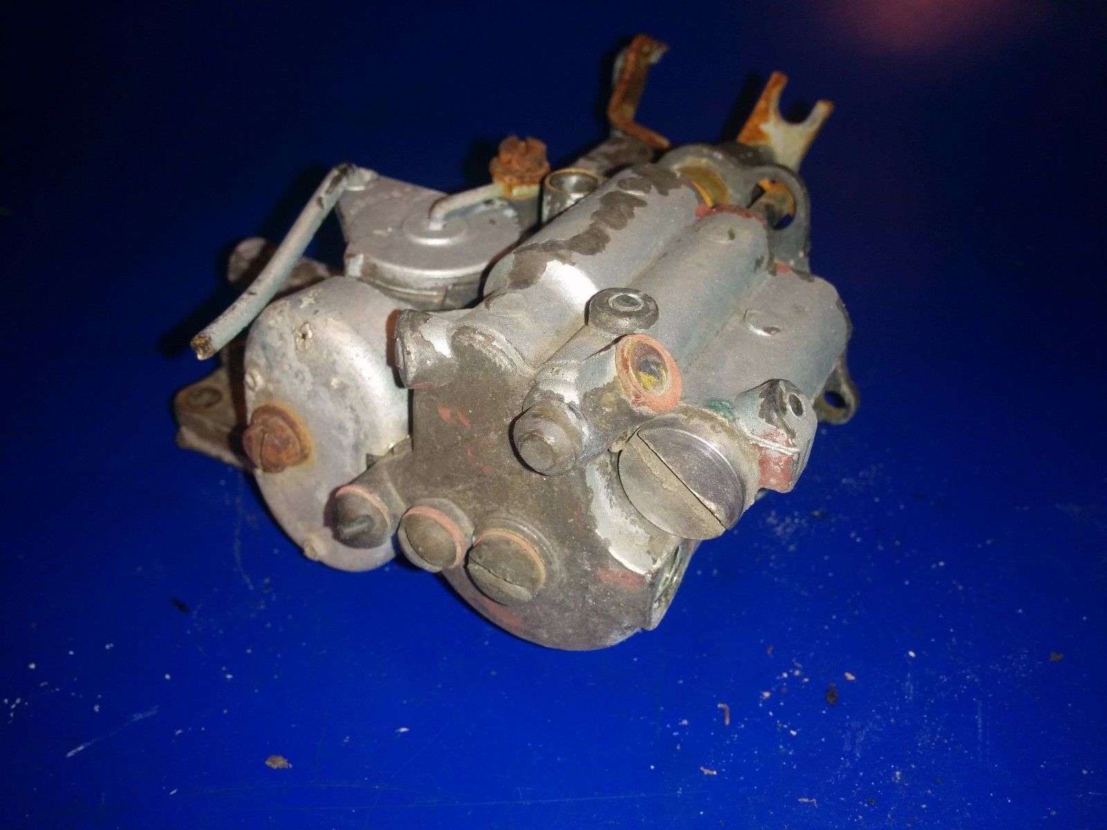

I bought various size and thicknesses of fiber washers
at the hardware store that I’ve been using on carburetor
screws, etc.
The last HD-25 Johnson that I got running got about
four new washers on the carb. I’m begging to wonder
if they’re not meant for gasoline. I can’t seen to stop
fuel from dripping from these screws. I’ve re-tightened
them several times where you wouldn’t think they’d
go any tighter. Almost had a steady drip out of one
screw today as it sat on a saw horse. I was able to
tighten it again. Either the washers are turning

May 14, 2017 at 2:13 am #57678I’m not referring to "packing washers" as on carburetor
hi or low speed needles. Just having trouble with
fiber washers leaking on the HD-25 carb, as
the four shown on this Ebay carb with the
red washers under the screws.
Is there a better grade, fuel proof fiber
washer than the hardware store variety?Chris, Thanks for the advice on the pivot pin!

May 14, 2017 at 3:02 am #57682OK, I understand now. I’m not sure what the red OMC sealing washers are made from. I have not had to replace any of them with anything but OEM yet (only on fixed jet OMC carbs).

May 14, 2017 at 5:53 am #57691I’ve used hardware store washers with great success. You might want to make sure there’s no corrosion or damage to the casting or under the screw head which might cause a leak. A quick buffing with a wire wheel will remove any old sealer or remnants of the old washer making for a clean surface.
May 14, 2017 at 10:31 am #57694dont know if it dissolves but have you tried several layers of teflon tape on the threads first . the yellow teflon one is thicker and should fill he thread gaps well before the packing washers
May 14, 2017 at 1:16 pm #57698I’m usually pretty careful cleaning surfaces that need sealing,
using a dremmel with various brushed on the carbs.
Teflon tape would be hard to apply on those tiny
screws, but perhaps when I take it apart I’ll apply
some type of sealer on the threads and washers.
Tell mom, "Happy Mother’s Day" !Prepare to be boarded!
May 14, 2017 at 1:33 pm #57700Not only is the yellow thicker, it is actually intended to use where gasoline is involved, the white teflon tape will not hold up well.

I have used nylon washers when the fiber ones were unavailable. . . 😉
