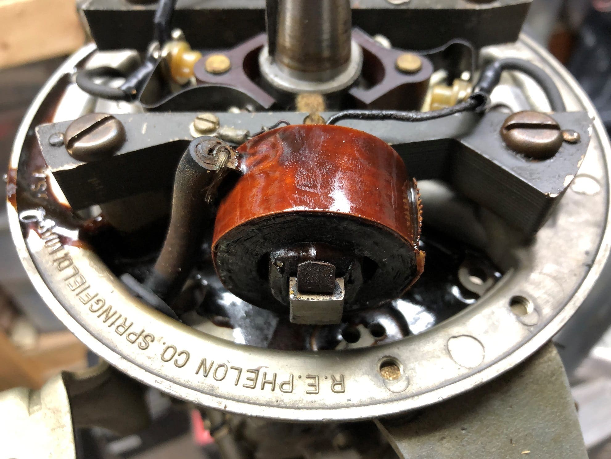

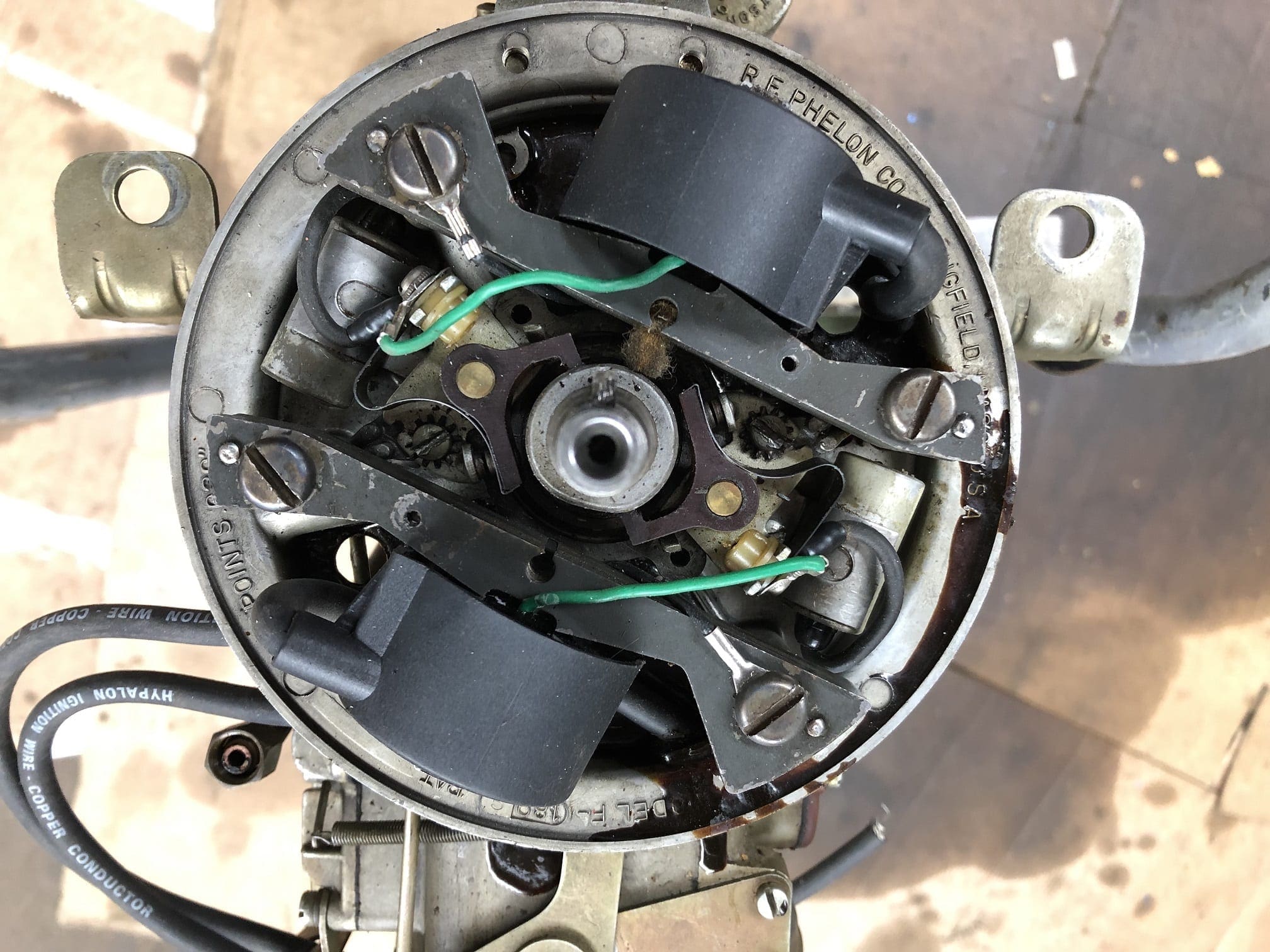

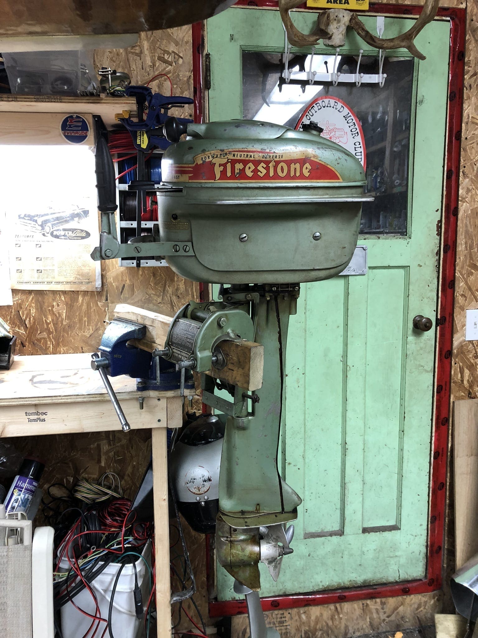

      I picked up this pretty 1952 Firestone 7.5 hp last fall. It’s in great shape aside from some melted coils. Fortunately, it has the small Phelon coils with the 7/16″ laminates. The OMC universal coils fit right on.

      WAYNE

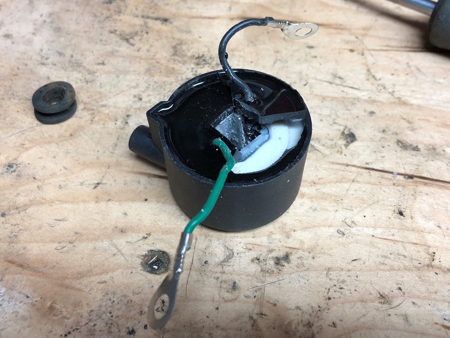

        A word of warning if you use the cheap Chinese coils that are so readily available on eBay. They do work well, but the coil is epoxied to the laminates and may break when you press them off.

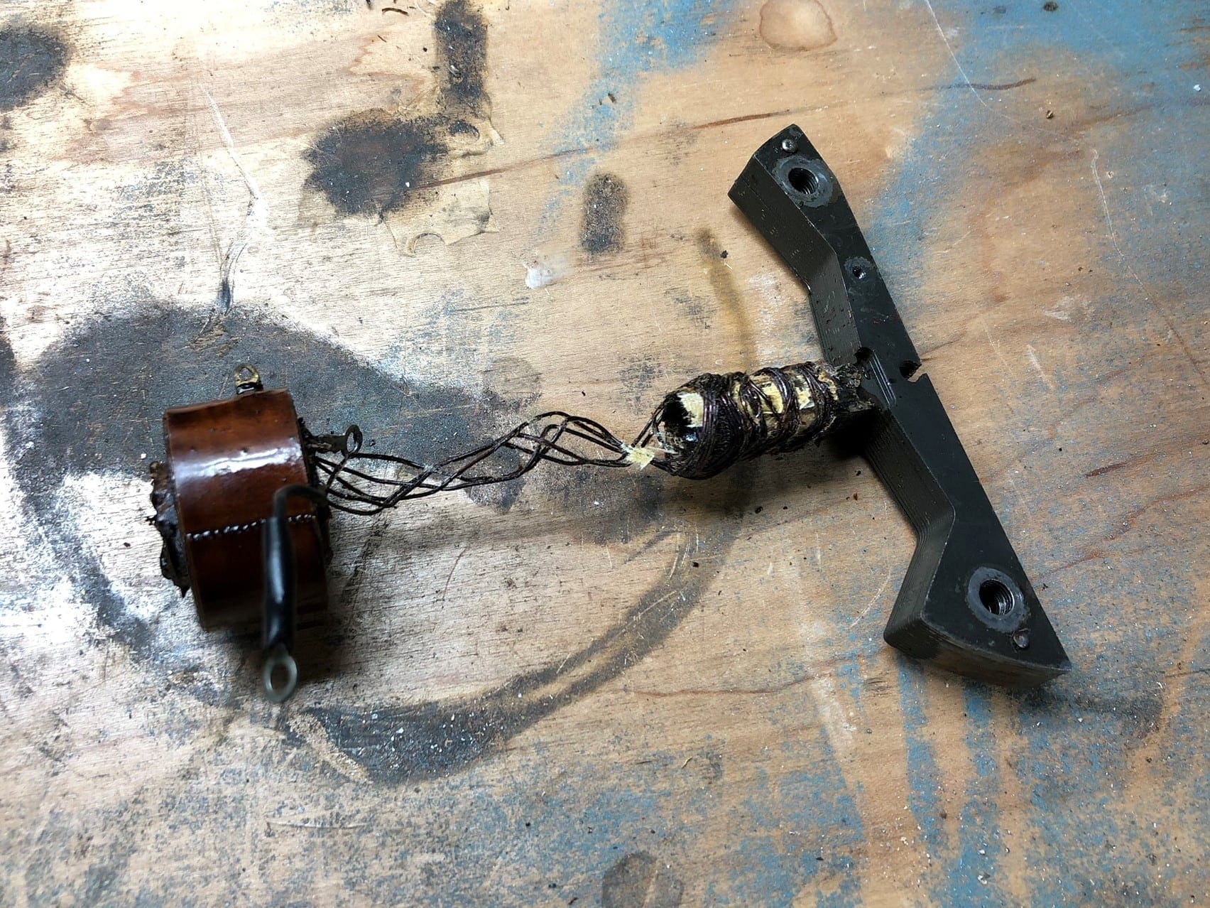

          Looks like the original coil didn’t want to let go of the past very easy either.
          Can the epoxy of the Chinese coils be scored with an exacto knife to get
          them to come off the laminates without busting?

          #161575
            I’m really surprised that the flywheel magnets aren’t hitting the plug wires. Good job with a tough situation.

            WAYNE
              Buccaneer, I scored the last coil before I pressed it out. I don’t know if it helped or not. since the center laminate is glued the entire way. I’ve pressed off five of these coils now. Only one broke. I’ll be scoring them from now on just as a precaution.
              Frank, I wasn’t sure if the plug wires would work in that location, either. I found that pressing the coil all the way down the center laminate to the heels gave a little extra room.

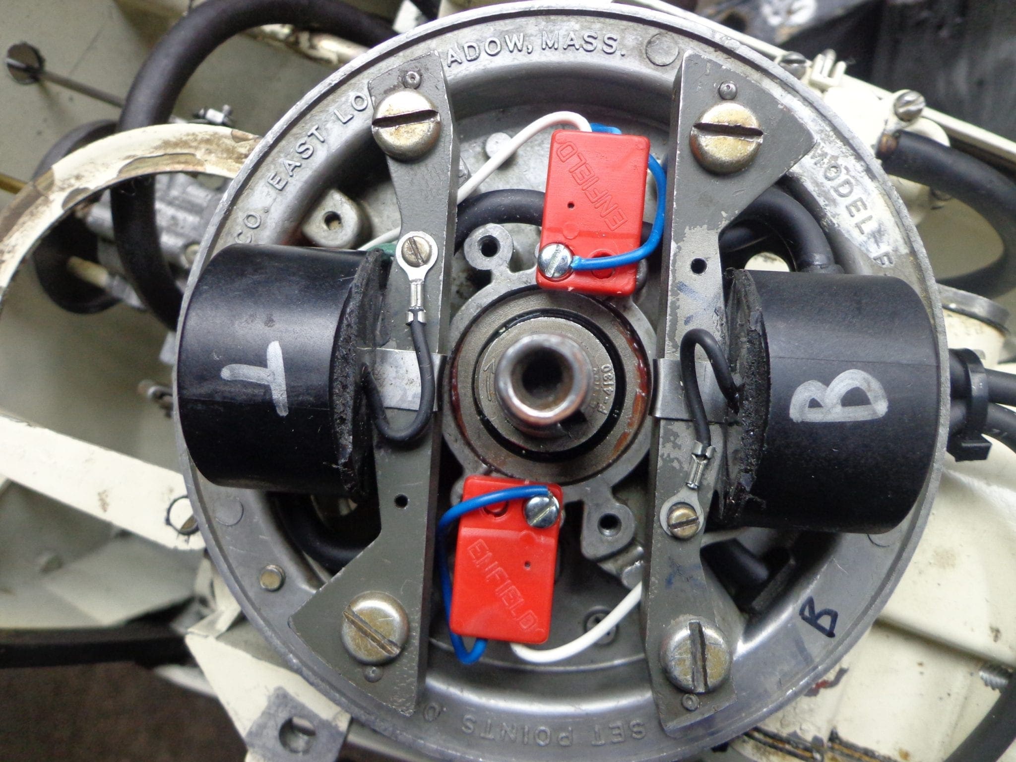

                Nice work Wayne and yes, the OMC coils do fit the Scotty lams nicely!
