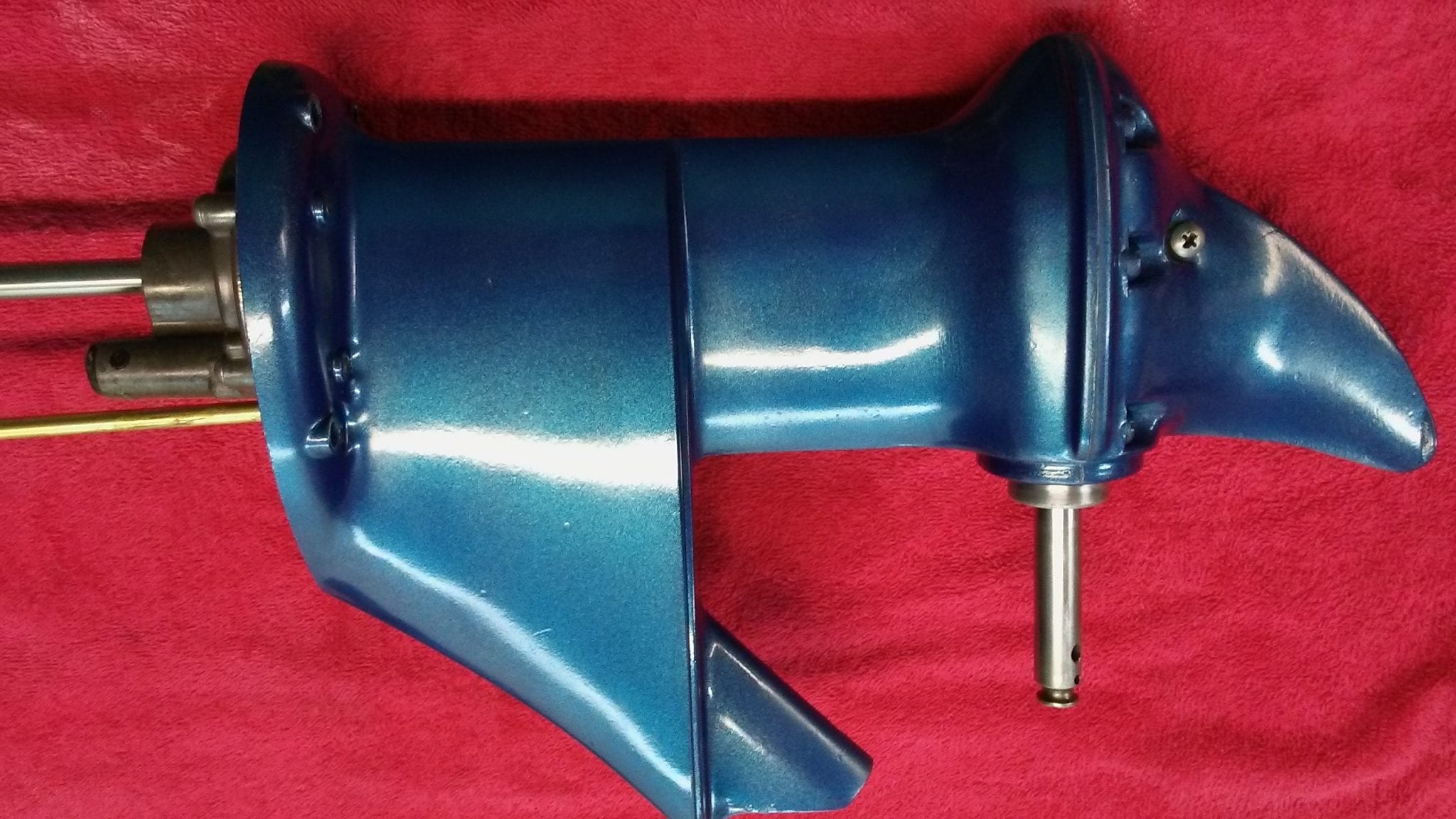

      Just completed a refurbish on a 1954 Fleetwin (model 7514) 7.5hp. All new lower unit seals, “O” rings, and gasket. Filled up the lower unit. Next morning noticed drips of oil. Upon a very close inspection I discovered a small vertical crack directly above the gear case head and bearing assembly. Under bright light I could actually see the oil seep out.
      Off to the parts boxes and I did find an Evinrude gear case assembly, upper and lower from a 1957 Fisherman (5514) 5.5hp. After a lot of measurements and a bolt up, it all seems to fit my 54 Fleetwin.
      Did some searching in my parts books and discovered the following: The 7514 (54 – 7.5hp) gear case assembly is p/n 376062 and the 57 (5514 – 5.5hp) gear case assembly is p/n 376775.
      So the big question is, are theses gear case assemblies interchangeable?
      20200320_140518
      Thanks again for all of your help.
      Nick

        Forgot to add …the gear case head and bearing assembly is the same p/n (376776) for both outboards.

          I think the driveshaft and shift rods might be a slightly different height on the 55 and older versions of the 5.5 and 7.5 models when compared to the rubber mount midsection engines….

              Hm-m–m-m-m, I just spent half an hour trying to figure out why the ’54 and ’57 gearcases have different part numbers. No answer yet. But I do remember when I did that several years ago, everything went well until I went to put the prop on. Wouldn’t clear the nose part. But it worked after I knocked some of the webbing out of the old prop. That’s all I remember.
              #197863
                There were changes in the propeller and the prop shaft seal and bearing assembly to try to keep the nylon fishline away from the prop shaft seal. It really didn’t,t help much. but did complicate prop selection.
                #197865
                  So the prop shafts and shift rods are the same?
                  #197867
                    Don’t try to take this to the bank, but I Think the drive shaft and shift rod lengths changed with the introduction of rubber mounts. But the change was in the exhaust housing, not the empty gearcase. This opinion and $2 will get you a cup of coffee at the corner gas station..
                    #197873
                      Not to worry Frank, I won’t try to deposit your advice in the bank…So, I think you are saying that the height of the spring mount vs rubber mount midsection was slightly different, so the height of the driveshaft and shift rod had to change also….I kinda thought this was the case… Wish I had a 55 parts book to compare each piece against a 56 model with rubber mounts…
                      So, I’m guessing that the part numbers of the two empty gearcases is the same….Perhaps the older gear housing supercedes up to the 56 and newer rubber mount engines…
                      #197875
                        No the empty gearcase part numbers are not the same. Dunno why.
