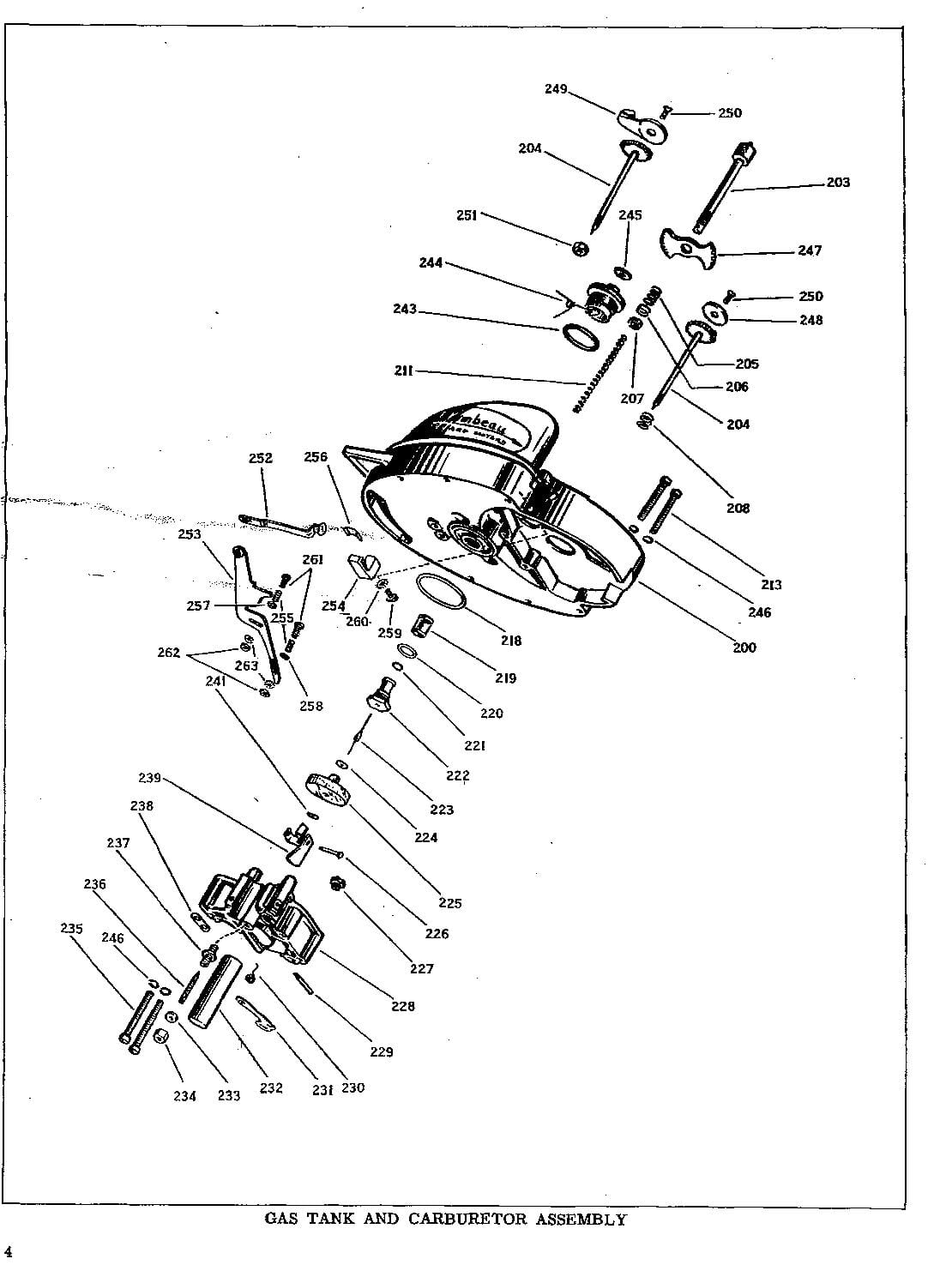

      I will welcome tips for partly disassembling a Flambeau for cleaning and inspection. Recoil came off easily. How should I remove carb adjusting “wheels”. Can the fuel tank be removed without risking sealing damage to carb or other parts? Please advise, thanks

          These are fun motors, but not really designed for intuitive disassembly and re-assembly. Take your time and it will come apart OK.
          Fuel tank has to come off to service the carb anyway, so good time to do it.

              Detail #254 needs to be removed to get the mag plate off. Screwdriver hole in the tank to access screw holding it in.
              I spent an evening trying to get mag plate off so I could remove the tank before I saw detail 254 holding it in.

                  Hi everyone i am new here and just started to work on my own flambeau and i was wonder if anyone new hot to pix or fix an new or used version of this part. The end has broken off
                  #236955
                    Is it just 1/8″ pipe? How’s the part that it screws into?
                    5hp-Parts-Manual-p3
