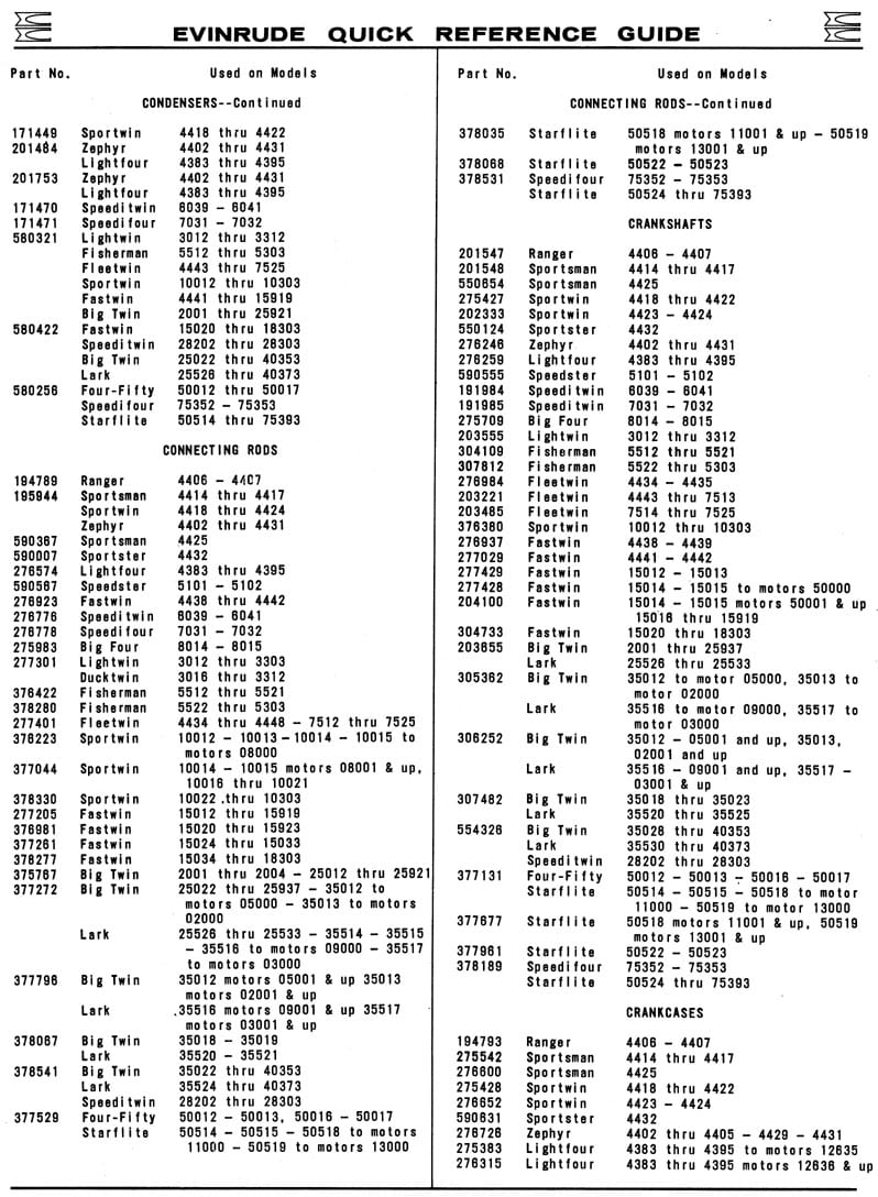

        Quick reference guide sez same pistons and conrods for 1951 thru 1958 Fleetwins

          #226800
            This one, among others
            1963-Quick-Reference-Guide
            QRGpg15-R
