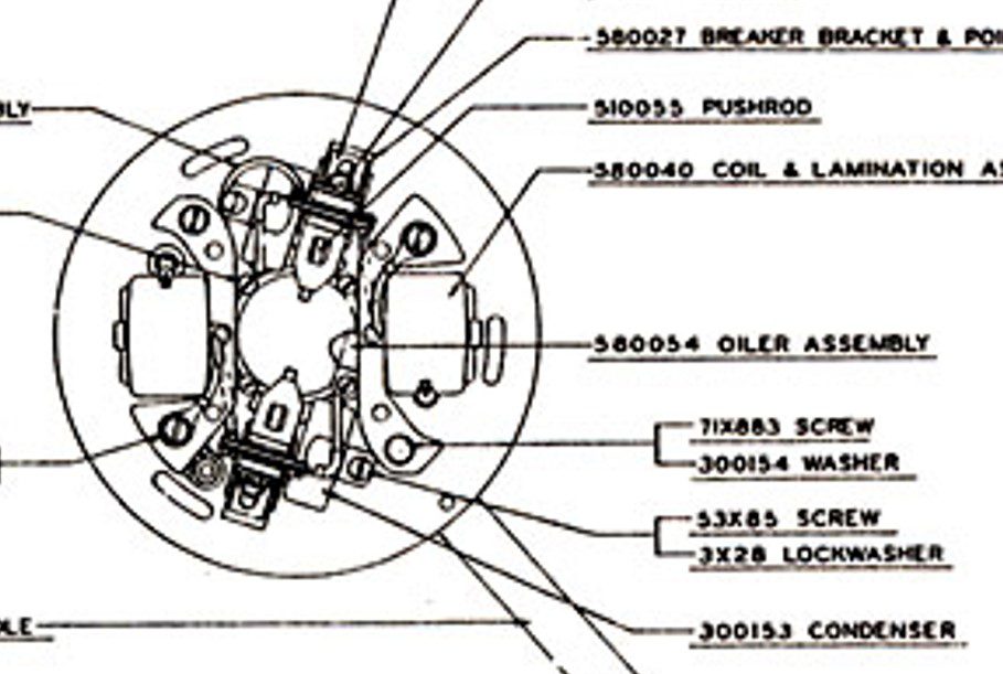

      Not sure if my last request was received. Im trying to figure out were the oiler and clip go on my 4443  1951 or 52 motor. Looks like next to points ? Thanks for any input DaveR
      #257705
        should sit under a coil and wipe the lobe….
        #257709
          see pic  sits under  the coil if  magneto style
          • This reply was modified 4 years, 5 months ago by JACQUES.
          #257726
            OR, is it this kind?  I really don’t know.
            Screenshot-2022-04-08-115058
            #257734
              could not find much info   thanks for the pre-51’s magneto   like early TN’s
