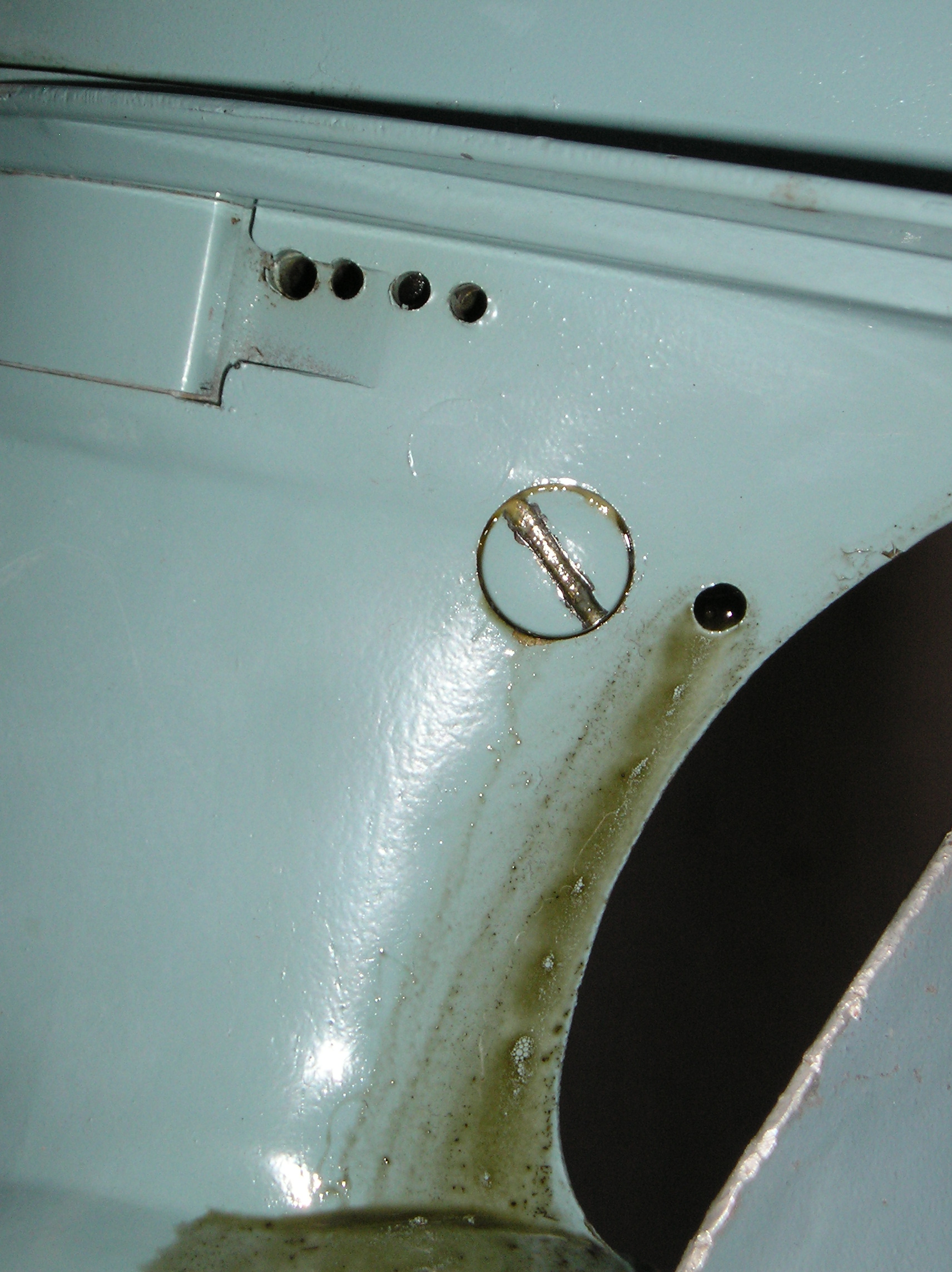

What is the best way to flush out a gear housing so I can fill it with all new gear oil? I was thinking of using kerosine but don’t know if that would hurt any internal rubber parts. I’m still trying to figure out if I screwed up this lower end by putting the wrong lube in the gear housing. I have also not been able to find out what the extra hole next to the fill plug is for.
July 24, 2017 at 2:13 pm #62126I would not flush the gear case. Just drain the old lube,let it drain all day if you wish,then refill with the correct lube. The extra hole is a water drain hole ,I see it has a bit of oil exiting the drain hole,no concern. It is a bit of unburnt fuel from the exhaust.

July 25, 2017 at 1:57 pm #62174Thanks for the replys, I don’t have a heat gun so I will heat it up in the test barrel then let it drain on it’s own. I will fill it with gear oil and repeat the process and then give it a final fill before taking it to the lake again. The thing that bothers me most is the stuff coming out of the little drain hole in the first place looked like gear oil and not like the unburnt fuel shown in the picture. Hopefully if it happens again, it will happen in the test barrel and not after pulling it out of the lake. If it does happen again I will take pictures and post them for your opinions. Thanks again for the help!
