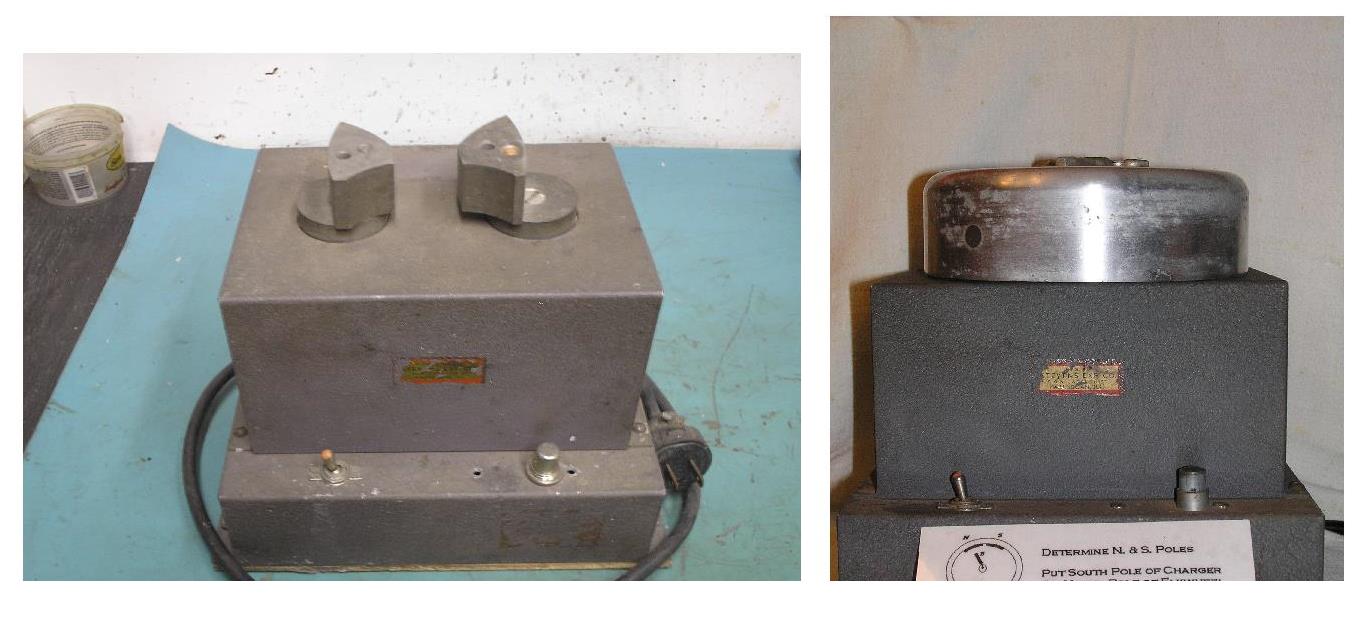

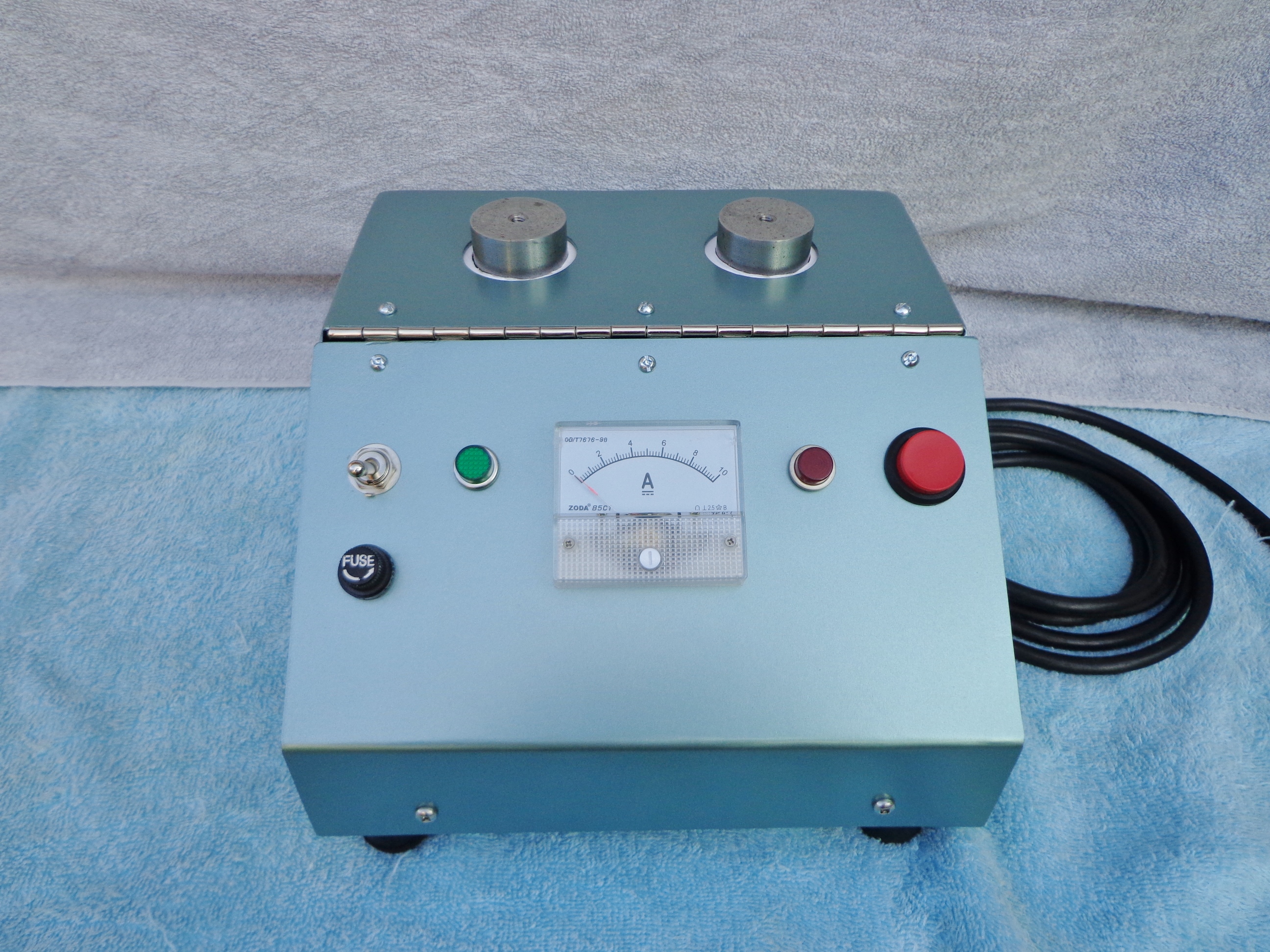

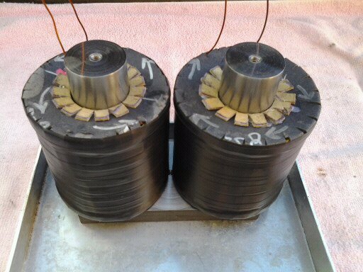

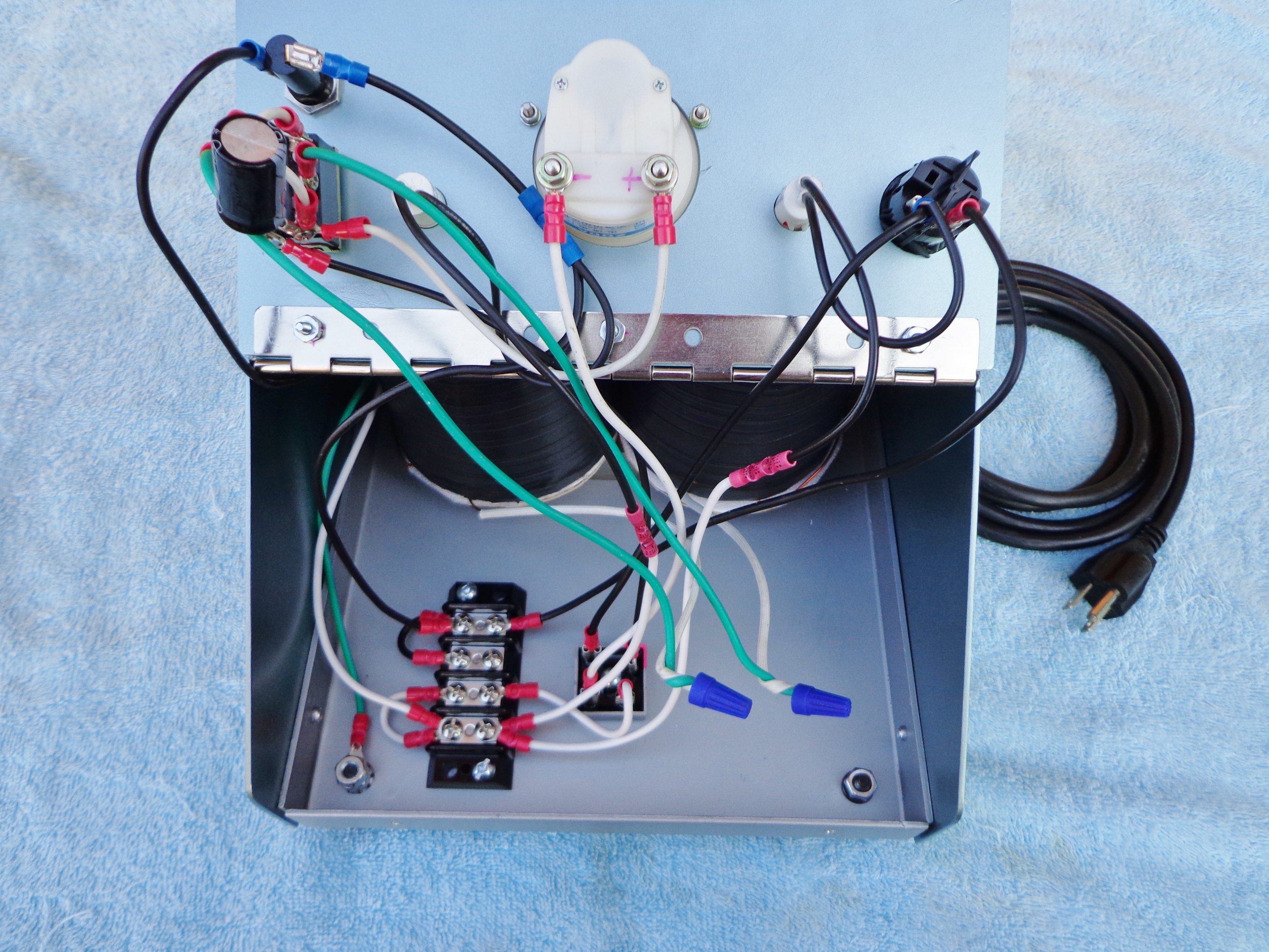

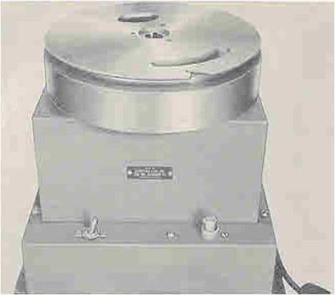

December 1, 2017 at 1:48 am #68129Well, you came to the right place as several club members own magnet chargers and one may be near you and might be able to help you out if they read this. The popular Stevens charger was used in repair shops eons ago but I think most of them have been scrapped for the copper content. I tried to find one for several years without any luck so I ended up building a magnet charger. It’s a pretty handy tool.
