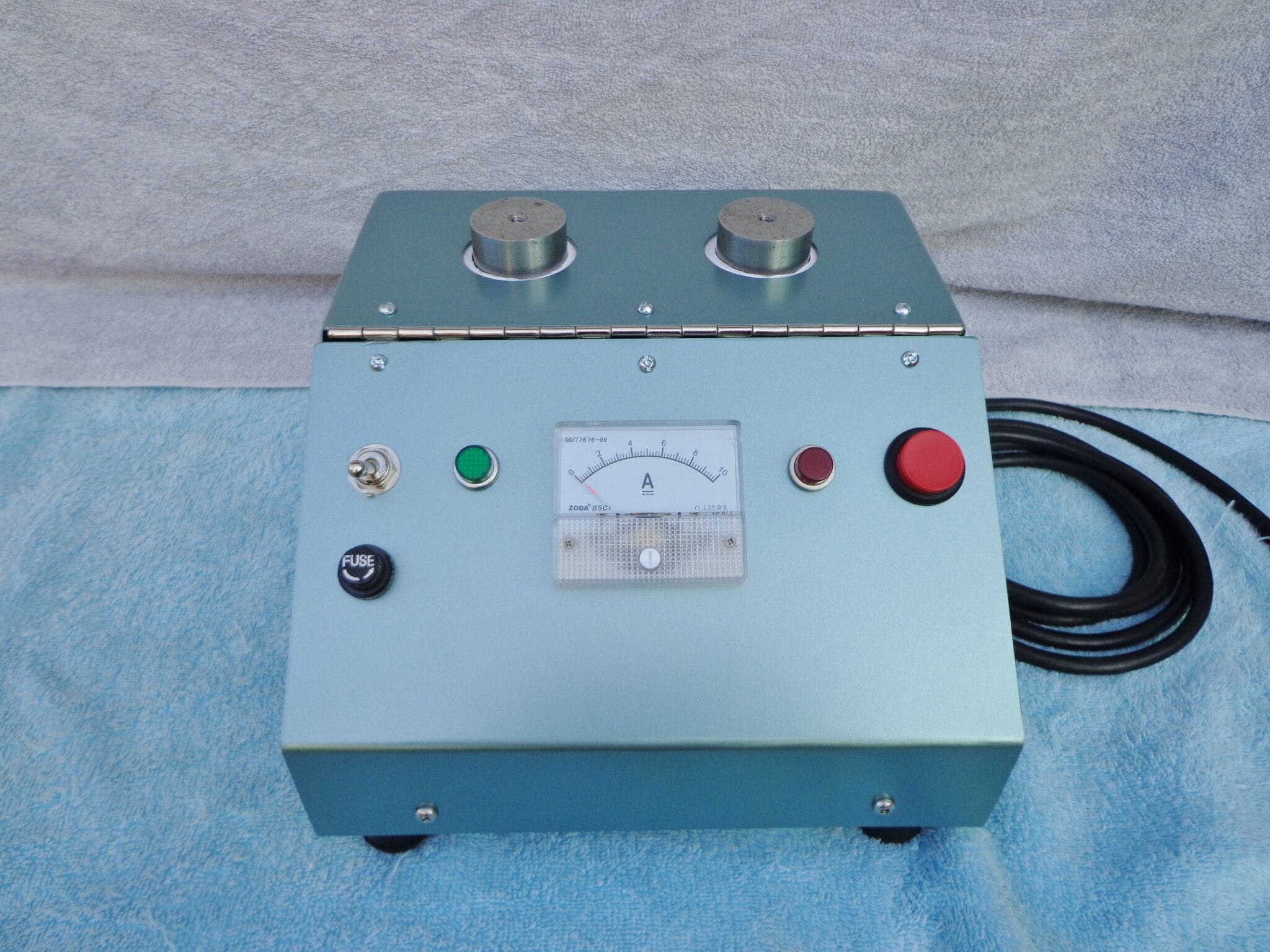

          Do you have a local chapter near you as some members own a Stevens or similar unit needed to charge weak magnets. A strong magnetic field is necessary to generate a good spark and iron flywheel magnets in pre war motors tend to degenerate with age but not so much for post war magnets made out of ALNICO.
          Since I couldn’t find a charger anywhere, I ended up making one.

                Mumbles, unfortunately there is no chapter near me and I am the only member in the country – Bermuda. Nice looking charger BTW.
