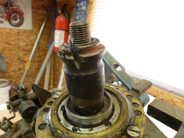

DaveNovember 1, 2016 at 9:56 pm #46841November 1, 2016 at 10:02 pm #46842Ouch! I did already have to grind the flywheel nut to remove it…
November 1, 2016 at 11:09 pm #46848Got it loose! I had put PB blaster, other tapping fluid, thin oil etc onto the center of the flywheel below the nut. Then tried used a pry bar as shown in Doug Penn’s how to remove flywheel video on YouTube. Then I put some Tap Free (very thin oil) below the nut, tightened the puller some more, hit the puller center screw and that did it. The photo below shows that the taper is rusty and that must have held the flywheel.
http://i77.photobucket.com/albums/j66/c … wcwx2s.jpgNovember 1, 2016 at 11:14 pm #46849What you found below the flywheel is very encouraging. It indicates that motor has not been used since many moons ago. Should be a low hours motor and not worn out.
