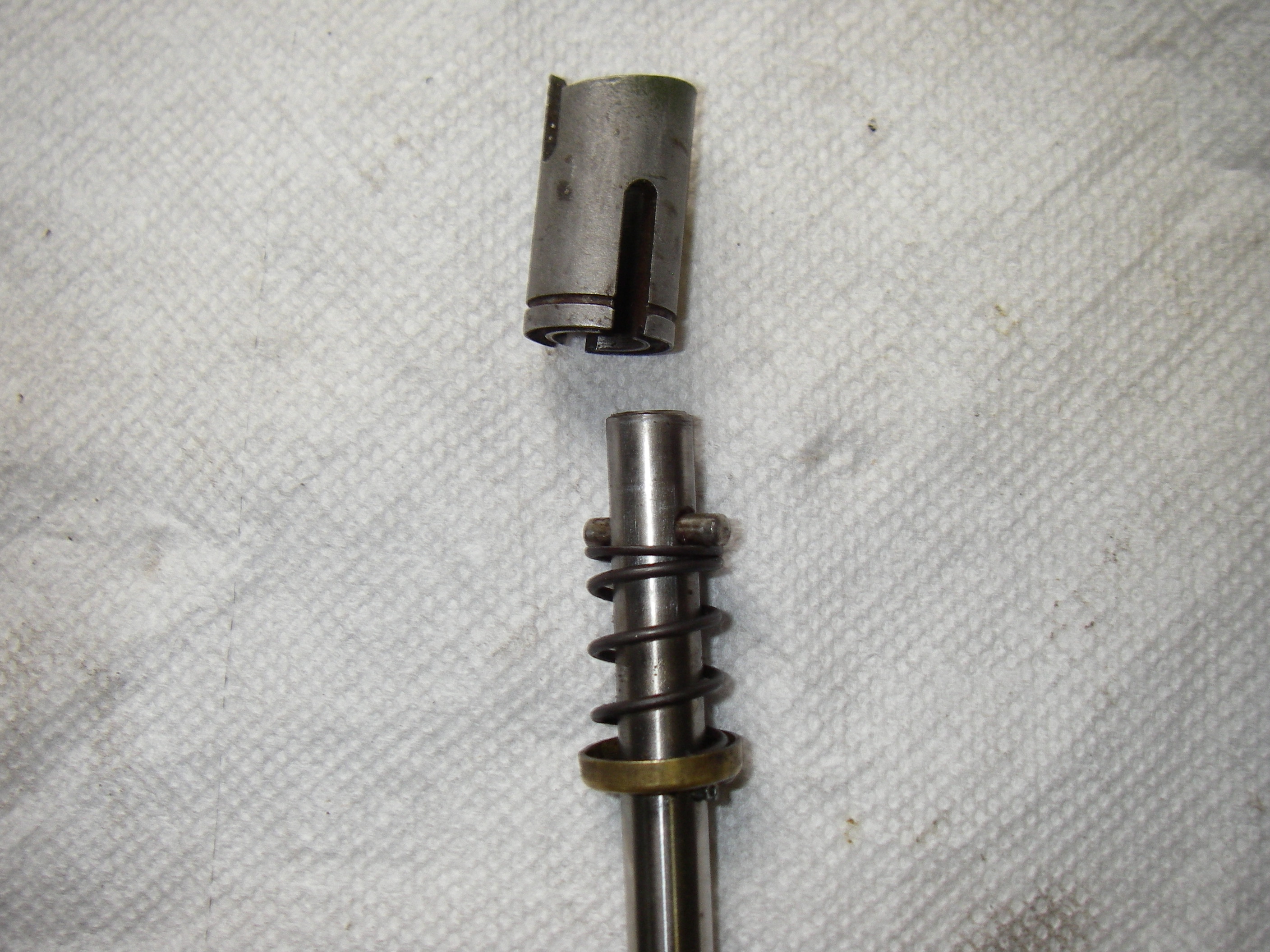

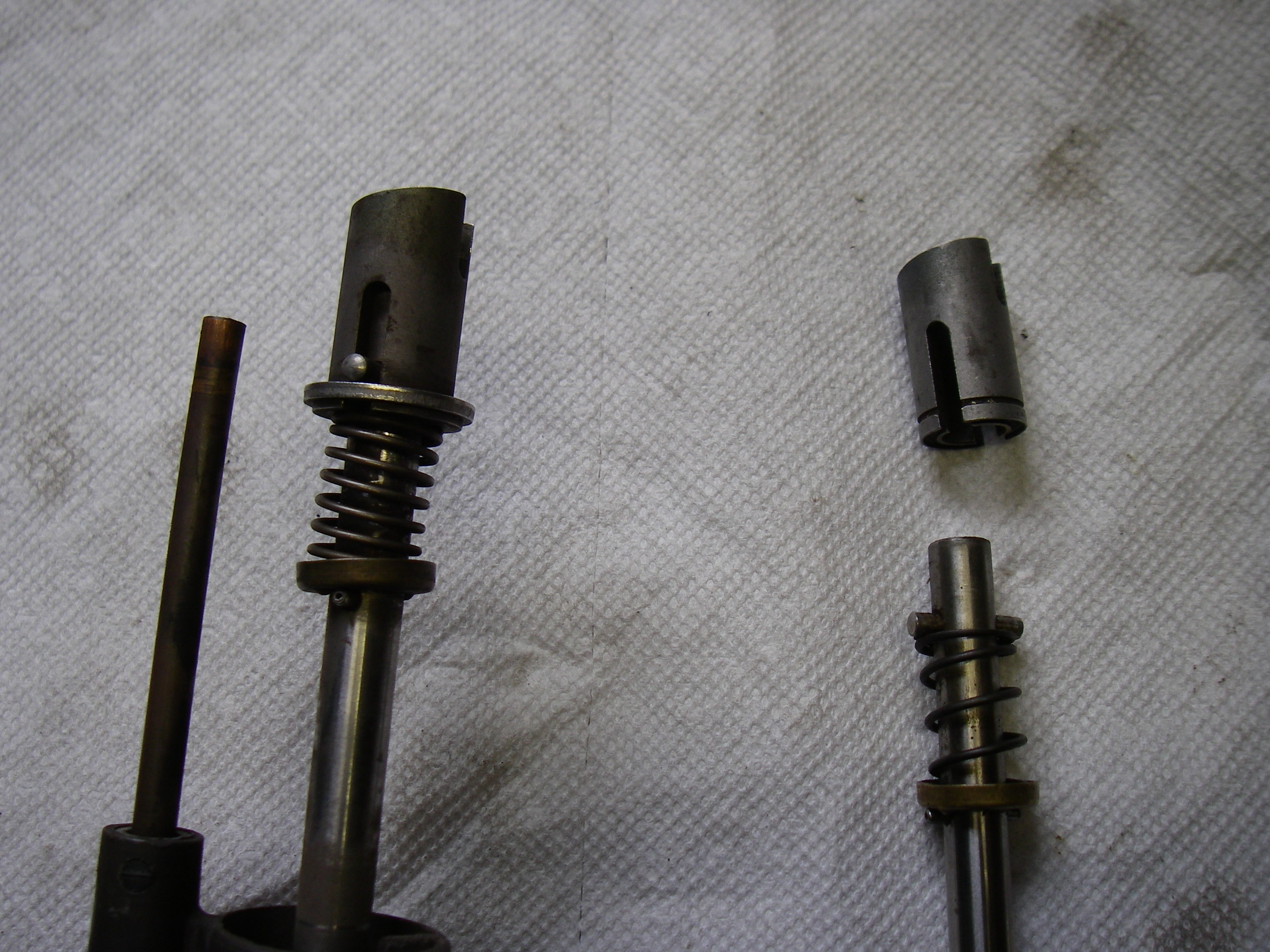

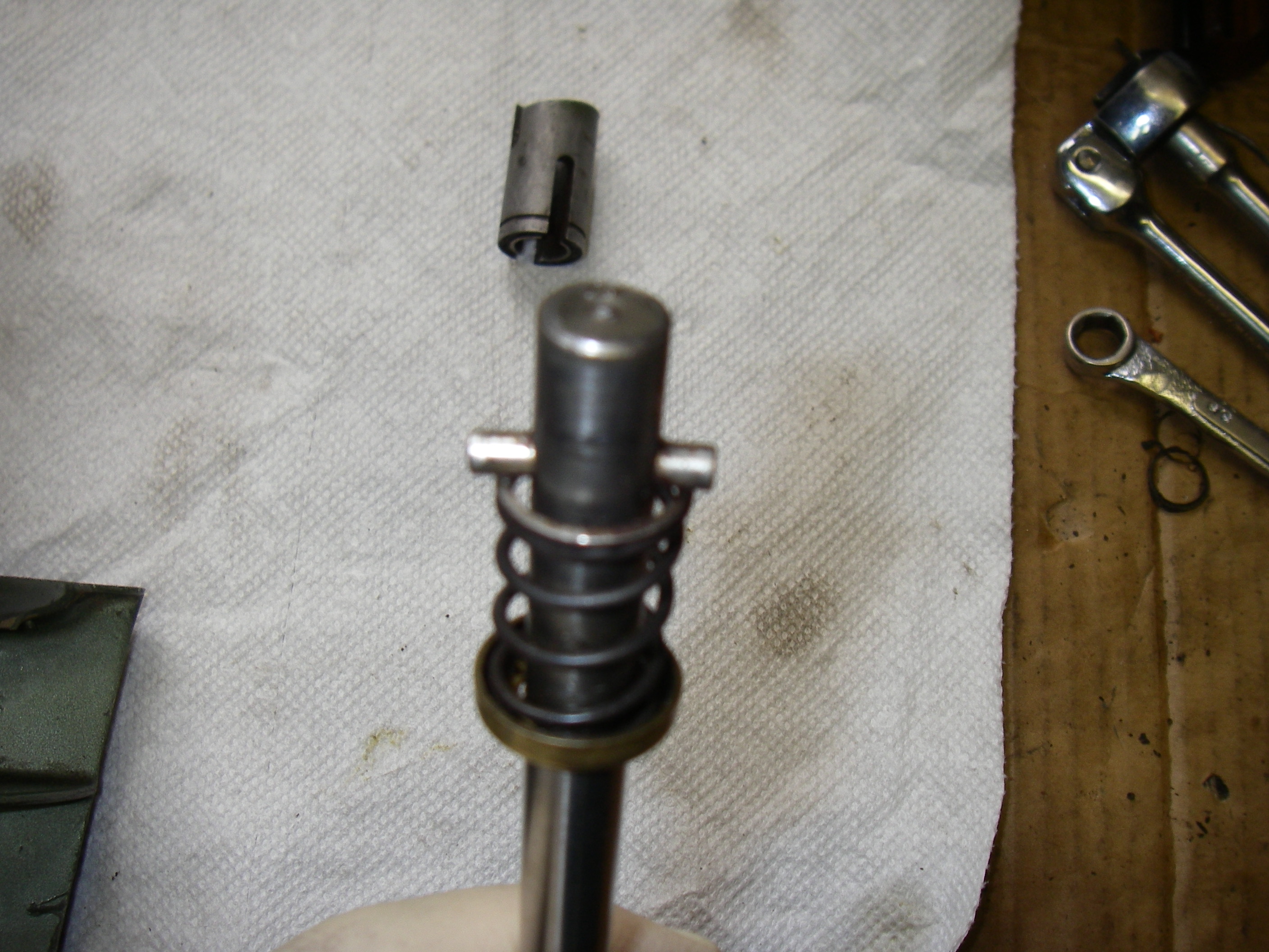

          #61108
          Mike Natoli
            i have a couple pics here.i hope i did this right?
            mn

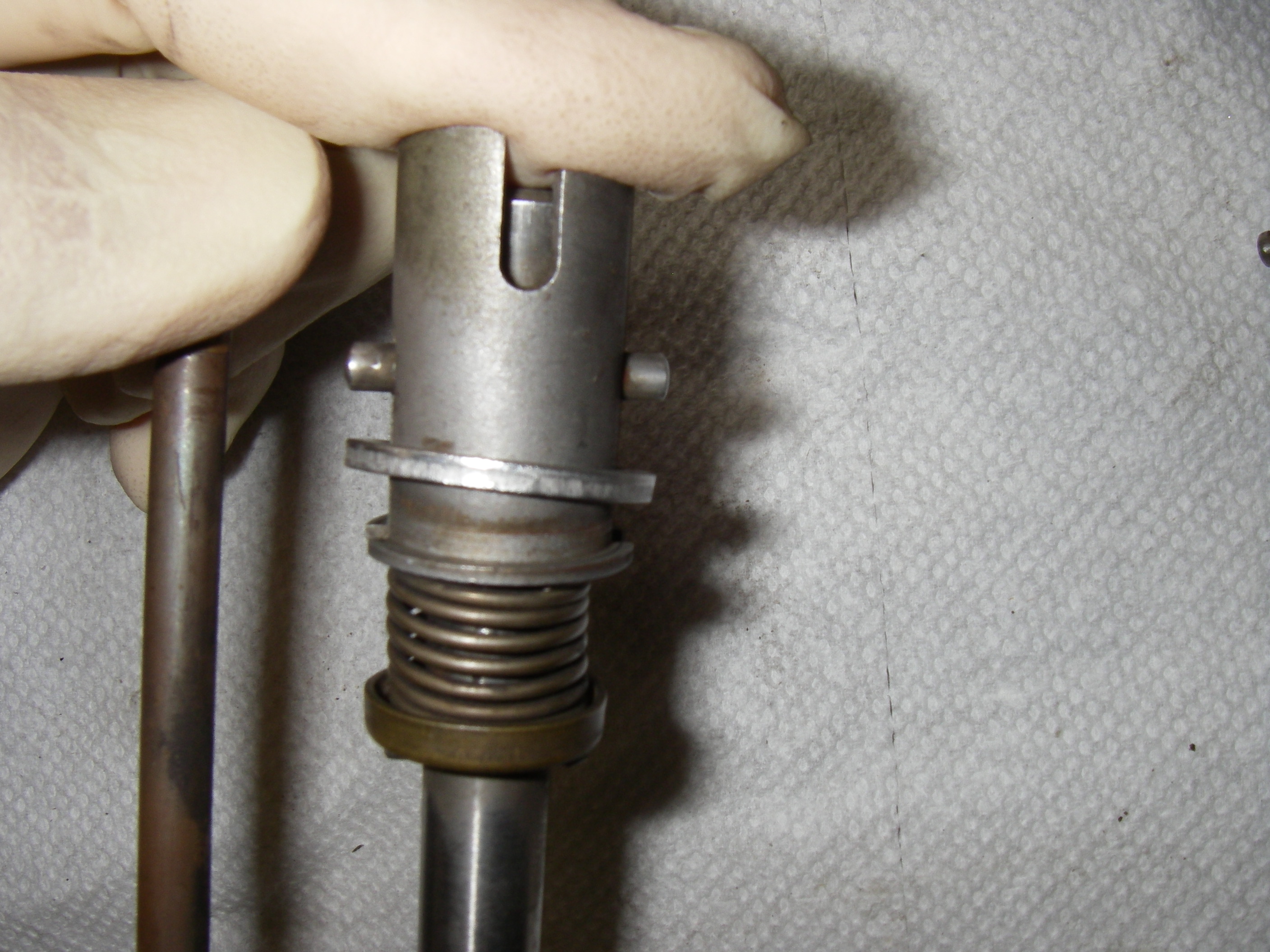

            #61119
            retiredoz
              The two should look the same. The one on the left in your third shot looks right, you’re missing the washer and clip for the other one. You could probably find a fat washer and a c-clip to hold it on place..
              #61147
              Mike Natoli
                the one in the 3rd picture seems right.it has a shoulder for the washer to sit on.the other one is different.it has a groove (instead of a shoulder) for a clip or snap ring to sit in and the spring is a LOT stiffer than the other one.the pin in the 3rd pic is longer too?
                mn
                #61158
                retiredoz
                  Well, you get the idea : The pin is a drive pin, length isn’t all that important as long as it’s long enough. I have the one on the right, with the groove in the
                  coupler and the heftier spring. Like I said, if you dink up a fairly thick washer and find a clip, you should be good. If the spring tension makes you uncomfortable, you could probably find a lighter spring, too.
                  #61164
                    The springs look significantly different which probably explains the feeling that the ’65 is stronger.
