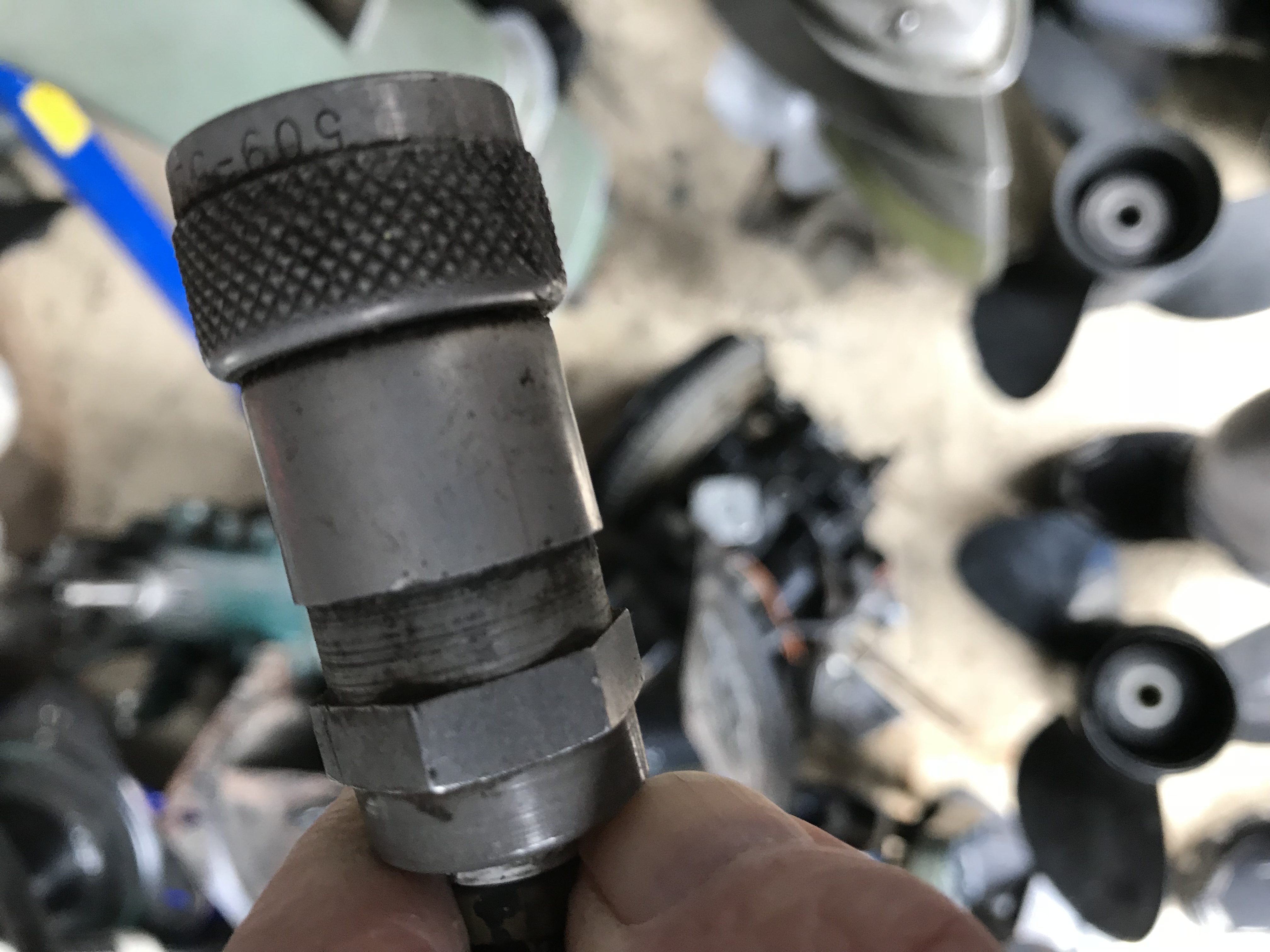

      Looking to figure out what type of fuel connector I have here. It’s on my 1950 Scott Atwater 16hp, but not like my other Scott’s. Looks similar to a Chrysler but has a lip that sticks out. The connector is long gone from the tank. James in Wisconsin

        It takes a 509-5206 hose end fitting, only used for a few years, and only on the 16s. Probably not the easiest thing to find ? It resembles the Chryslers in being a ‘pop-on’ but the dimensions appear different from everybody else’s.

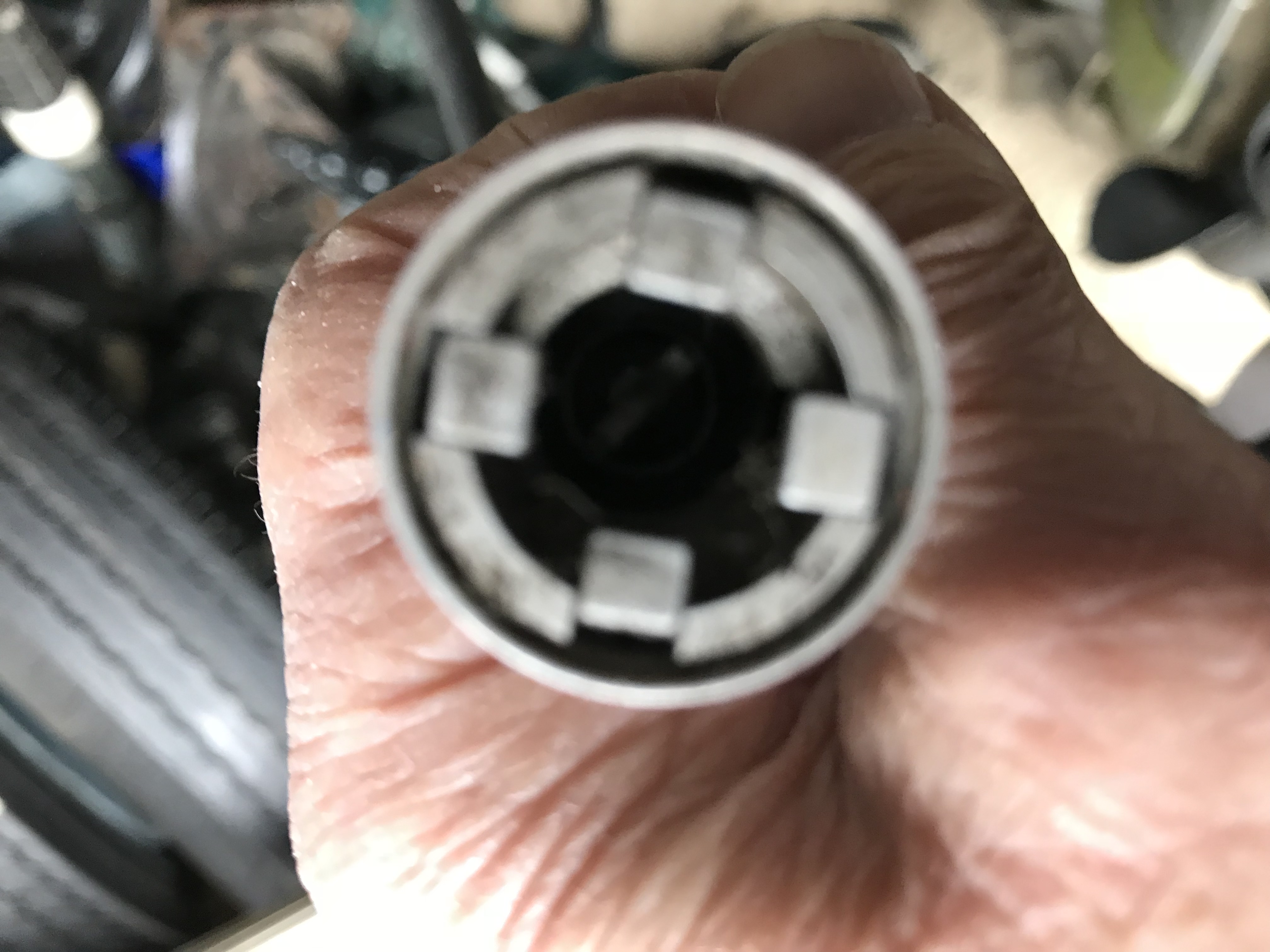

          retiredoz
            This is what it looks like :
