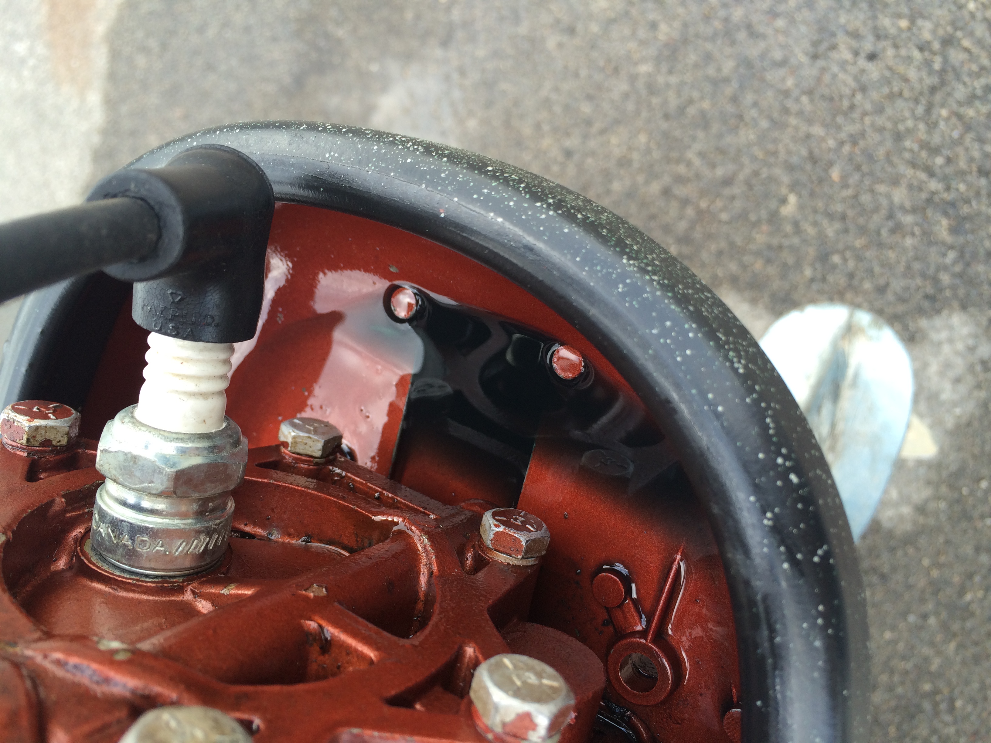

      I have a 10 hp Johnson that seems to be leaking fuel from or around the power head somewhere. I’ve not located the source yet, but also I’m a little reluctant to pull it apart yet should it happen to be involved as I’m wondering if I can run it until fishing season is over as I’m selling my other motor off.
      I assume it is a totally foolish thing to do? I’m worried about it catching fire.

                  Thanks guys. It’s a QD 19. It appears to be coming from the crank case seam or perhaps up from the base gasket? Intake side looks dry. There was some fuel/oil residue on the webbing of the cyl head. Another member told me to use printer paper to seek it out which I’m a bout to try. I guess I just wanted to see if it was a dumb thing to ignore for right now, and sounds like it is

                    Shoestring, that looks like a pretty dark and oil rich solution. That certainly could be coming from the tube that connects the upper bearing to the lower bearing. Definitely check that only as George suggested. It certainly could have sat for a while in the spot and much of the gasoline evaporated but if it comes out looking like that I’d say there’s much more oil in that than the initial 16:1 mix.
