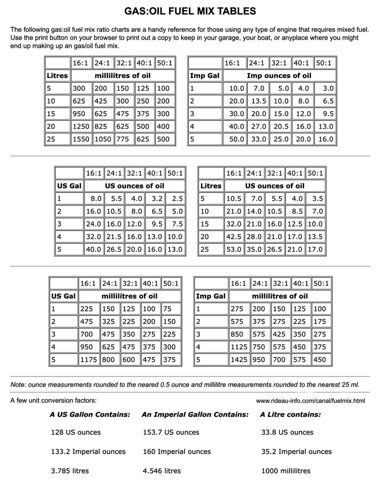

                Steve D
                  Yes that’s what it means. 24:1 = 128 oz. gas (1 gal) to 5.33 oz. oil. Here’s a handy chart.
                  mix-chart
