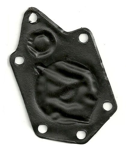

I have started on an old ’69 9922S and broke the little nipple off the fuel pump.
The black plastic Bakelite body part . . . I have it repaired but that is not the issue.
The issue is I am trying to find a fuel gasket kit for it and the profile does not match
anything I have found on the net. The parts drawings on the net show a square type body
and here is a photo of what I have. P/N on the body is 304089. Any help appreciated.

October 20, 2015 at 11:49 pm #25823Thanks Gary. But none of those will fit what I have….. I have seen that drawing on the net.
Please notice the "notch" on the pointy end of my posted photo.I just now saw a similar pump on ebay and it is . . . .
1960s Eaton Viking Canadian Outboard Motor Model 5D 17V (5 HP) FUEL PUMP #304089
So somewhere up the line, I guess somebody changed it out.388833 is the original fuel pump. I guess I will go back to that one.
Thanks !!
October 21, 2015 at 1:54 am #25830If you’re trying to make a showroom/personal collection original, then continue on your quest. Otherwise I’d just update to the small square fuel pump where parts and new units are abundant. The screw holes fit into the old ones fine.
October 21, 2015 at 1:55 am #25831That diaphragm fits the pump on my 1967 Fastwin. AFAIK, those pumps are no longer available but you should be able to use one of the square ones. I have a square one on my 9.5 and have rebuilt it with a Sierra kit with good results.
Fastwin fuel pump # is 380016 for what it is worth.
October 21, 2015 at 2:14 am #25833Thanks guys, I just want it to run decent . . . I will clean up this antique pump
and list it here in the classifieds to offset the price of a new, modern square body pump.
I bought this one off of ebay for a Johnson Evinrude pre 1993 9.9-15hp 397839 397839 18-7350
The seller said it will work on my 9-1/2.I have the gummed up carb soaking in a can of parts cleaner now . . . should be all good soon.
