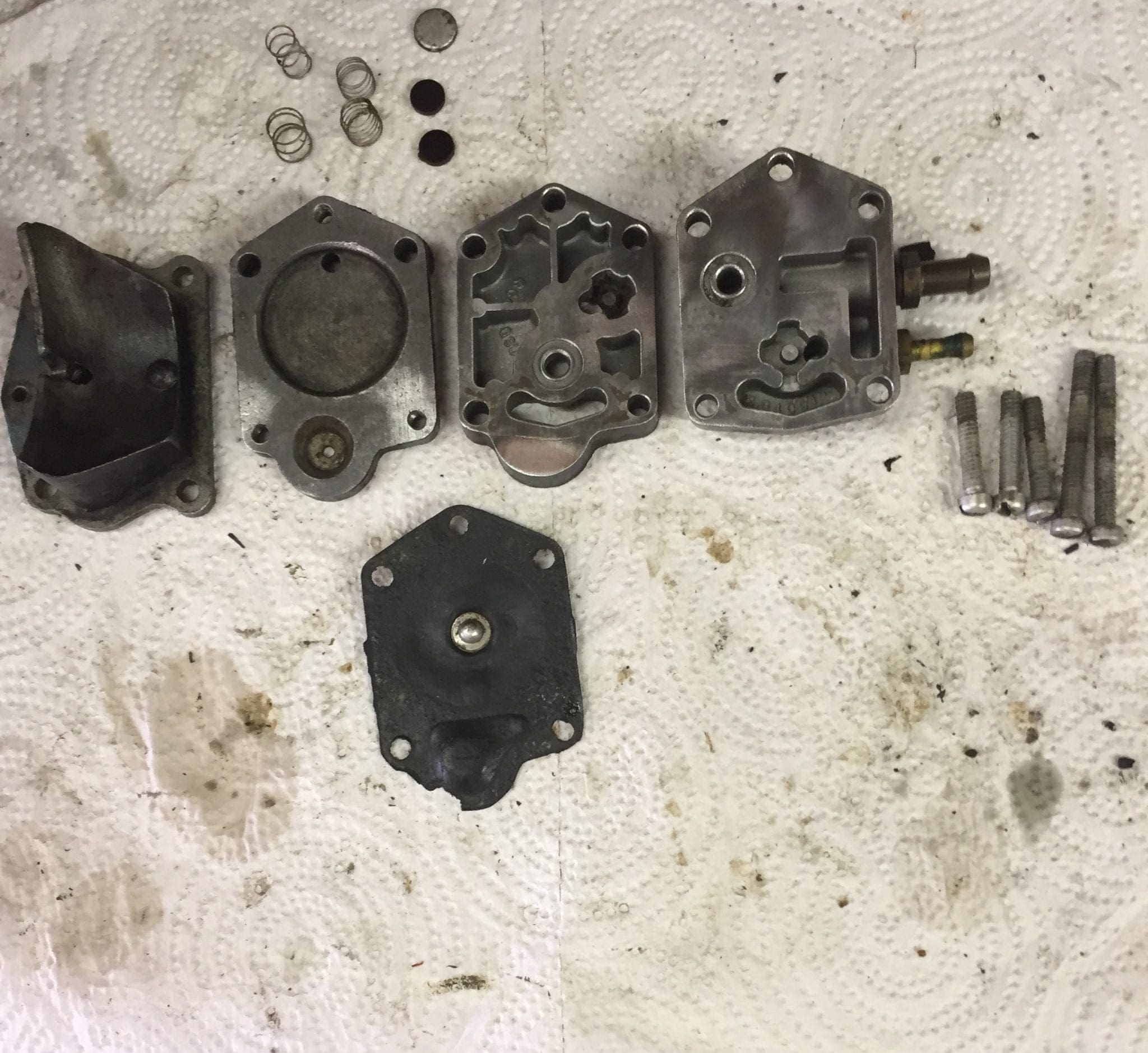

      I took this fuel pump apart in hopes of replacing diaphragm and gasket. Now I need to reassemble it but my arthritis will make it a daunting task. Perhaps I can hold it in a vise and have at least to fumbling hands to assemble it. I know there are other fuel pump options but that wouldn’t be challenging enough.

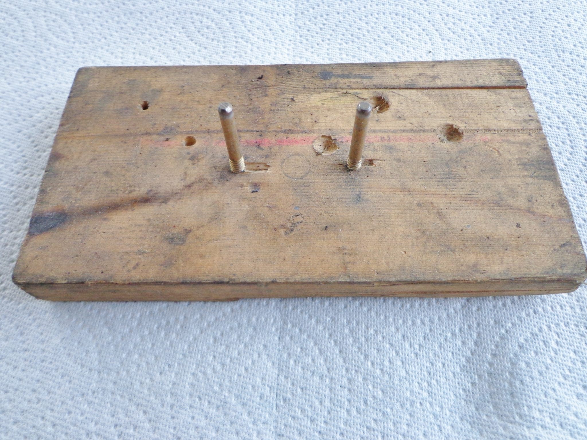

          A jig made with some old coil screws with the heads cut off works for me.
          DSC00194
          DSC00195
          #177030
          vintage.1958
            Never gave that a thought but now appears obvious. Thank you

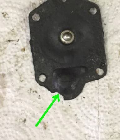

              What are you going o do for a diaphragm? You know that kind is obsolete, don’t you?
              #177048
              vintage.1958
                I will use the one in it. When that fails I will go to plan B which is to fabricobble one and when that fails I will go to plan C. I’m not a plan B or C type out of the gate. I could go directly to plan C but I have all this retirement time available.
                #177054
                  I predict Plan A will leak at the arrow. On to plan B.

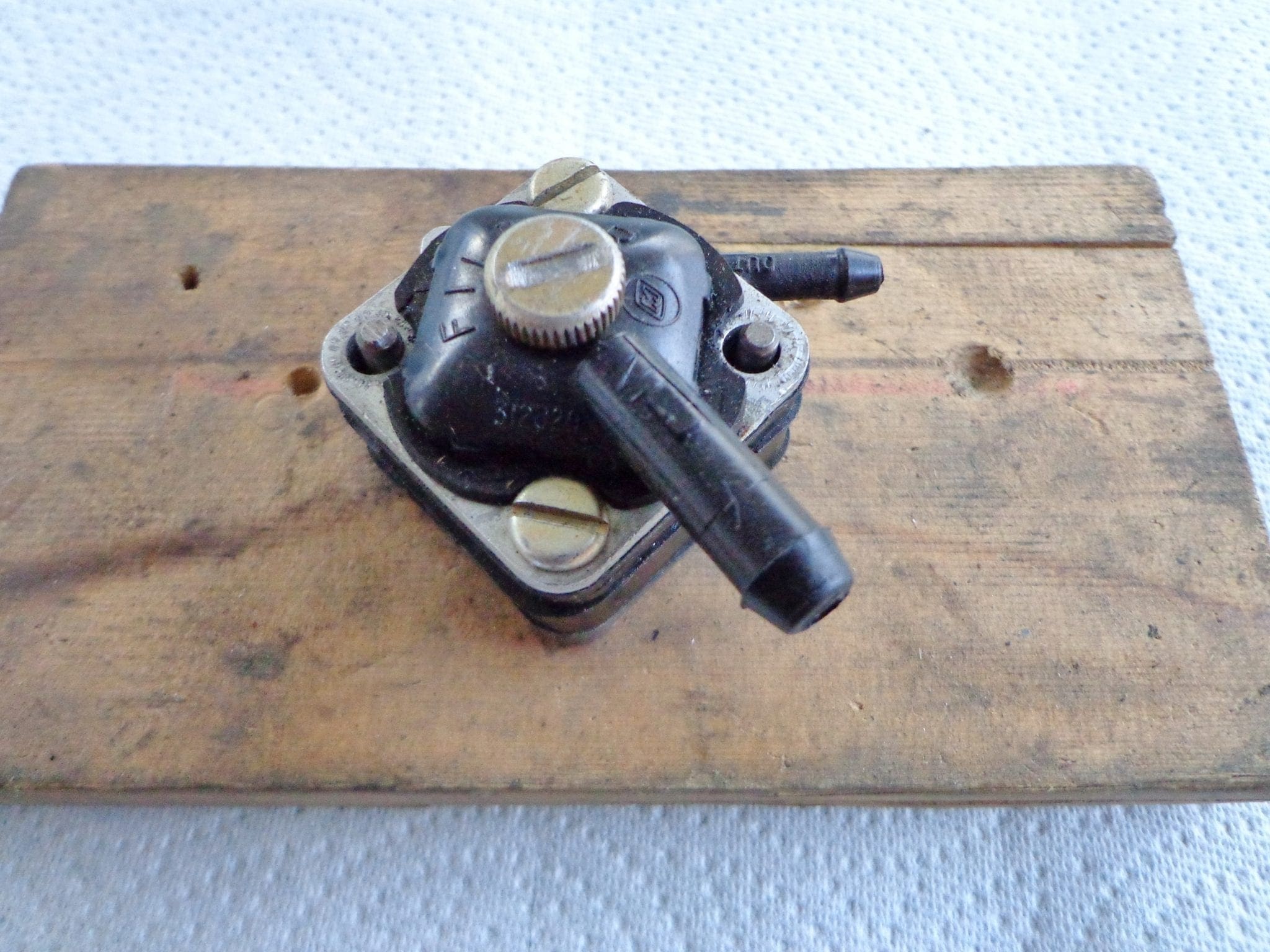

                      Will those modern fuel pumps like Mumbles posted work?
