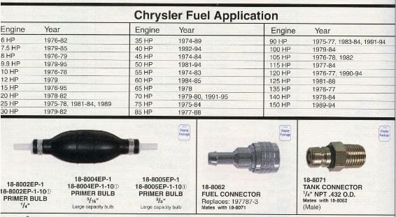

                Sierra part number 18-8062. Available many places selling Sierra parts, including NAPA.
                #187971
                  Is yours like this?
                  capture-chrysler-fuel
