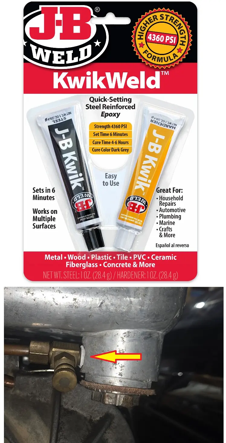

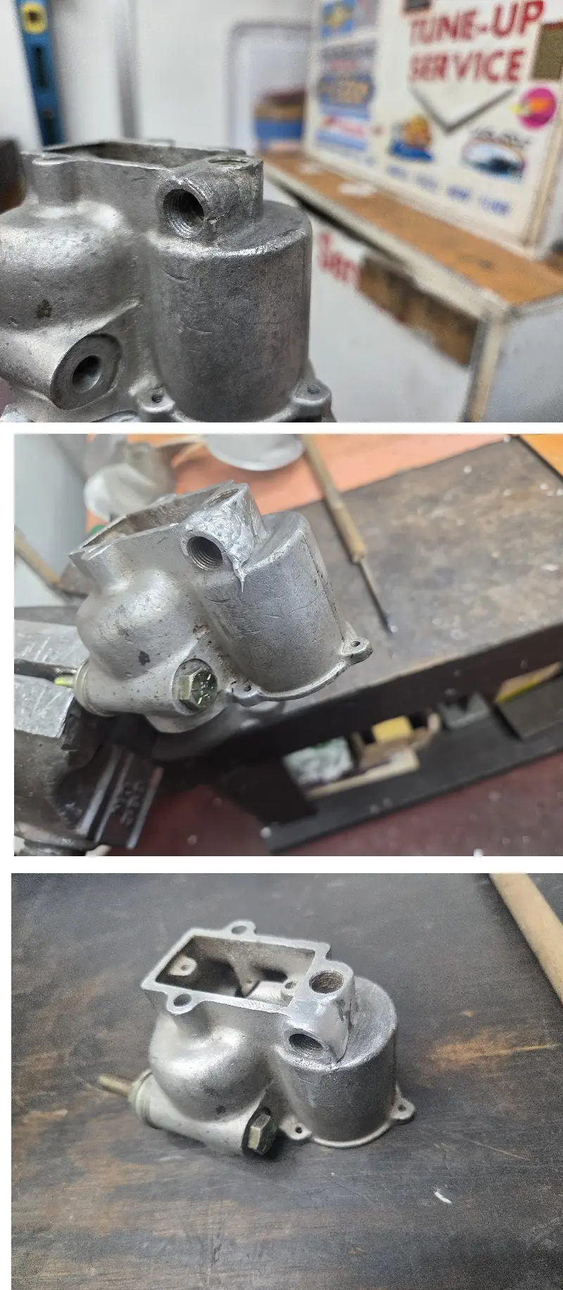

      The brass fuel shut off valve on the port side of this carb needs to be in a horizontal position so the needle can come out of the face plate. I have it in the correct position but it’s loose. It was very difficult to remove for cleaning (shoulda probably left it alone) because it did have something on the threads.
      What can I put on the threads to make it stay in place? I’m assuming a loc-tite  type product might do the job. Anybody have a recommendation for what you have used that will work in this situation?

        So the fitting will not go around another full turn to tighten up, correct? If the thread is a tapered pipe thread (TPT) the best fix is to use the proper TPT pipe tap and gently enlarge the hole enough to allow the fitting to “come around to the proper position and be tight. Absent that fix, plan B would be to use some yellow teflon  pipe thread tape on the thread add enough wraps to tighten.

          Thanks Joe! doesn’t look tapered to me. Or maybe?
          I believe it will strip out if I force it the additional 250 (or so) degrees to get it tight and in the proper orientation.
          I’ll give the yellow tape a try.

              I have several aluminum tanks where the threads are so worn out that the fitting won’t tighten up. I use J B weld. I position the fitting where it needs to be and let it sit overnight. They can be and I have removed them. The J B Weld can be removed with a heat gun. Get it hot and it turns soft .
              J-B-2

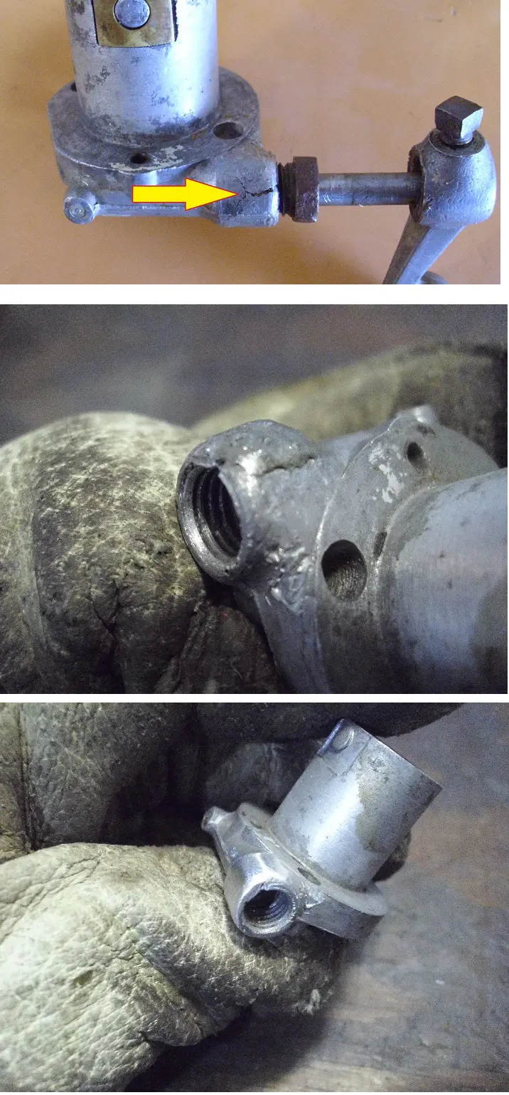

                    I also use it on carbs where “one more turn” broke the casting. I’ll patch them up best as I can with the aluminum brazing rod and use the J B Weld. Besides making the seal, it helps hold my “Boathouse Repair” together.
                    Carb-Crack-1
                    Carb-Crack-2
