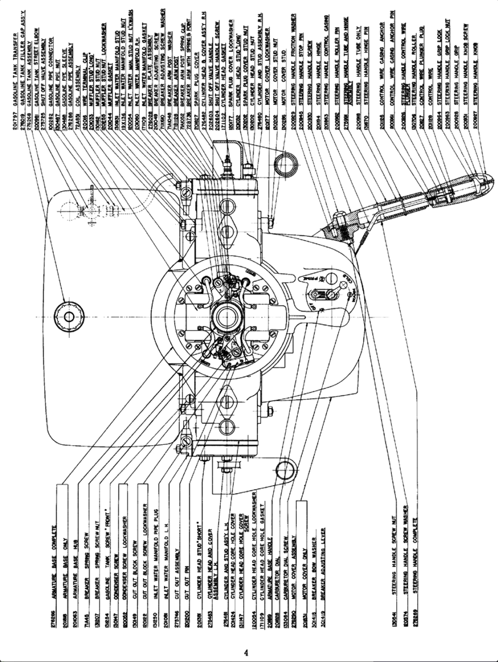

I’m looking to find out what the guys running the Evinrude Big Four use as the full advance setting while running? The Big Fours have an adjustable stop that once motor starts you can push timing lever to this stop so that your timing is the same every time you run it wide open. Also, would it make a difference if your motor is dead stock or if it’s been modified such as raised compression, altered ports or opening up of intake port in crank case etc. I’d like the timing to be listed by thousands BTDC but in degrees BTDC would also be OK. Thanks, Tom

July 29, 2017 at 4:58 am #62356I never saw any figures, they depended on the magneto stop. (I cannot find it in the parts book, but i have seen it on the motor.) Dad had a tool from engineering that screwed into a spark plug hole. With the piston at Top Dead Center it screwed it until it touched the plunger in the center of the tool. Then the flywheel was turned counter clockwise and the plunger was pushed in. the flywheel was then turned clockwise until a line on the plunger became visible. The stop was then held against the magneto plate and the bolts holding the stop tightened. 😕
