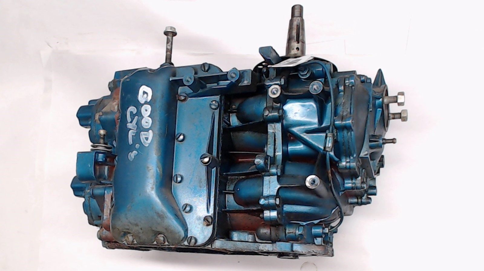

      How many different versions was there of Gale 12 hp power heads?
      The one I’m looking for to fix my 1951 is like the wedge head below.

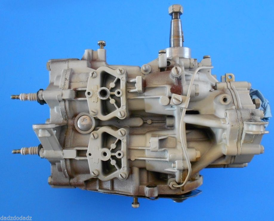

      The other one, which looks newer is said to be a 1948, and with the
      model number given on Ebay, I confirmed that.
      I know they had 12 hp Gale’s into the late 50’s and perhaps
      later. Were the later ones there again different?
      Thanks!

        There were only two main styles of 12hp powerheads, the wedge head as shown in your first picture, and a modified 15hp J/E. The second one you show isn’t a 12hp at all. That’s a 35hp.

              Whoever buys that 35 hp power head expecting a 12 hp is getting a bonus! 😀

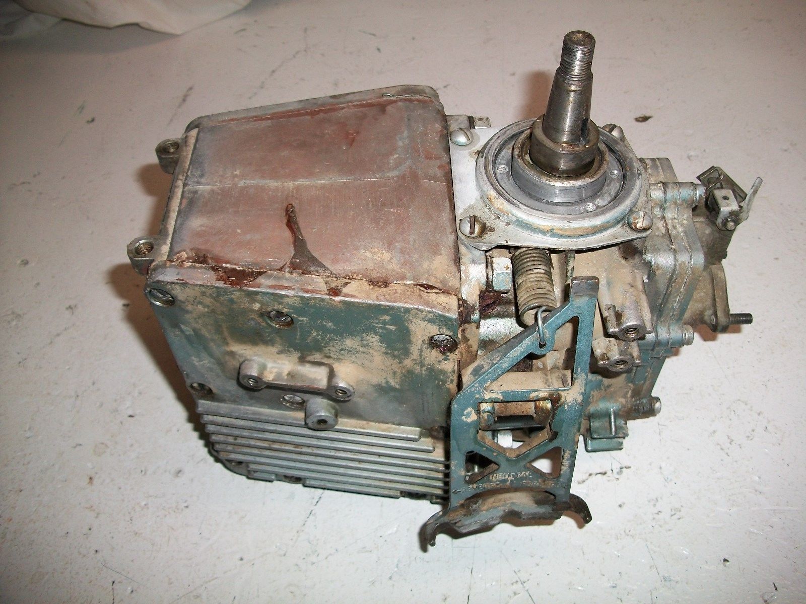

              Does this 1958 Gale 12 hp power head photo appear to be the correct one?

                That appears to be the other one. But I don’t get it, which one are you looking for?

                        I know for sure this PW version was used on 1960-1963 Gale 15 and on the following Evinrude/Johnson Worktwin 15 sold in Europe until 1968.
