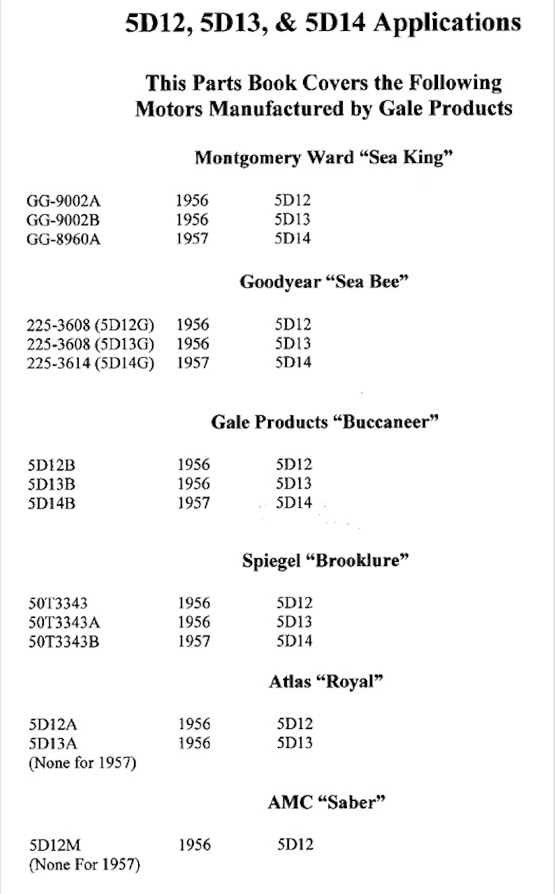

      I HAVE A GALE 1957 MOD 5D148, 5.0 HP THAT IS STUCK. I AM LOOKING FOR A REPLACEMENT POWER HEAD. I KNOW GALE MADE THESE ENGINES FROM ABOUT 1952 THRU 1958 AND SOLD THEM UNDER MANY DIFFERENT BRANDS. I AM HOPING THAT THE POWER HEAD IS INTERCHANGEABLE WITH THE VARIOUS BRANDS. DOES ANYONE KNOW OF A INTERCHANGEABILITY LIST ?
      SECOND CHOICE IS TO TRY AND UNSTICK THE ONE I HAVE. ANY HELP WITH METHODS OF FREEING UP THE OLD POWERHEAD WOULD BE APPRECIATED.

        John, most likely your model is a 5D14B instead of 5D148.
        I believed the "B" designates it as a Buccaneer.
        Speigel Brooklure, Goodyear Sea Bee, & Sea King all used
        the 5D14 power head in 1957, and I’m guessing prior years
        would work. If you can find parts diagrams for the various
        years of 5 hp, compare the power head "base" gasket parts
        numbers. If they’re the same, good chance it would bolt up.
        I’m sure other’s will know more.

            Your 1957 Buccaneer is a 5D14 model. 5D12, 5D13 and 5D14 all use this same powerhead. . . 😀
            #60691
              "Unsticking" the powerhead may be successful if you are lucky. If not so lucky, you may get it unstuck only to have it throw a connecting rod soon after you start it up. That would be the result of water in the crankcase, causing both the sticking and destruction of the rod bearings.
              There are some differences in hood mounting brackets through the years, but should be the same across brands within the same years.
