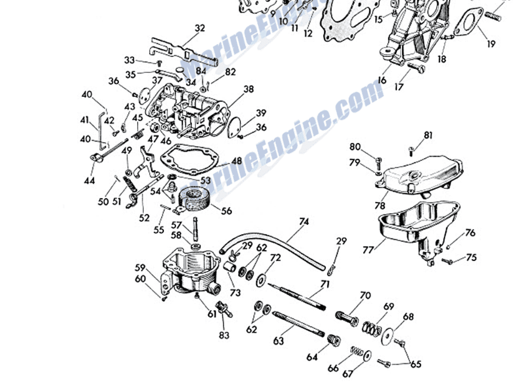

      #208227
        Is #58 gasket in place and in good condition?
        carb
