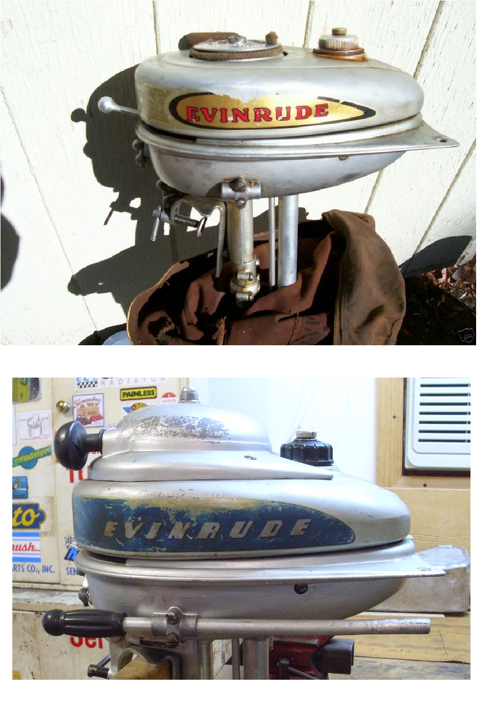

              #59876
                I believe this is the cap you are talking about.
                Aluminum ones are before WW-II. Plastic is after.
                Found on many of the smaller Evinrudes and Eltos.
                Hard to find a nice aluminum one. Most have seen
                pliers sometime in their life.
                #59885
                paulfromyork
                  Yes, Tubs, that is my cap. the plastic one. Maybe I’ll take a run at a repro. aluminum cap for fun.
